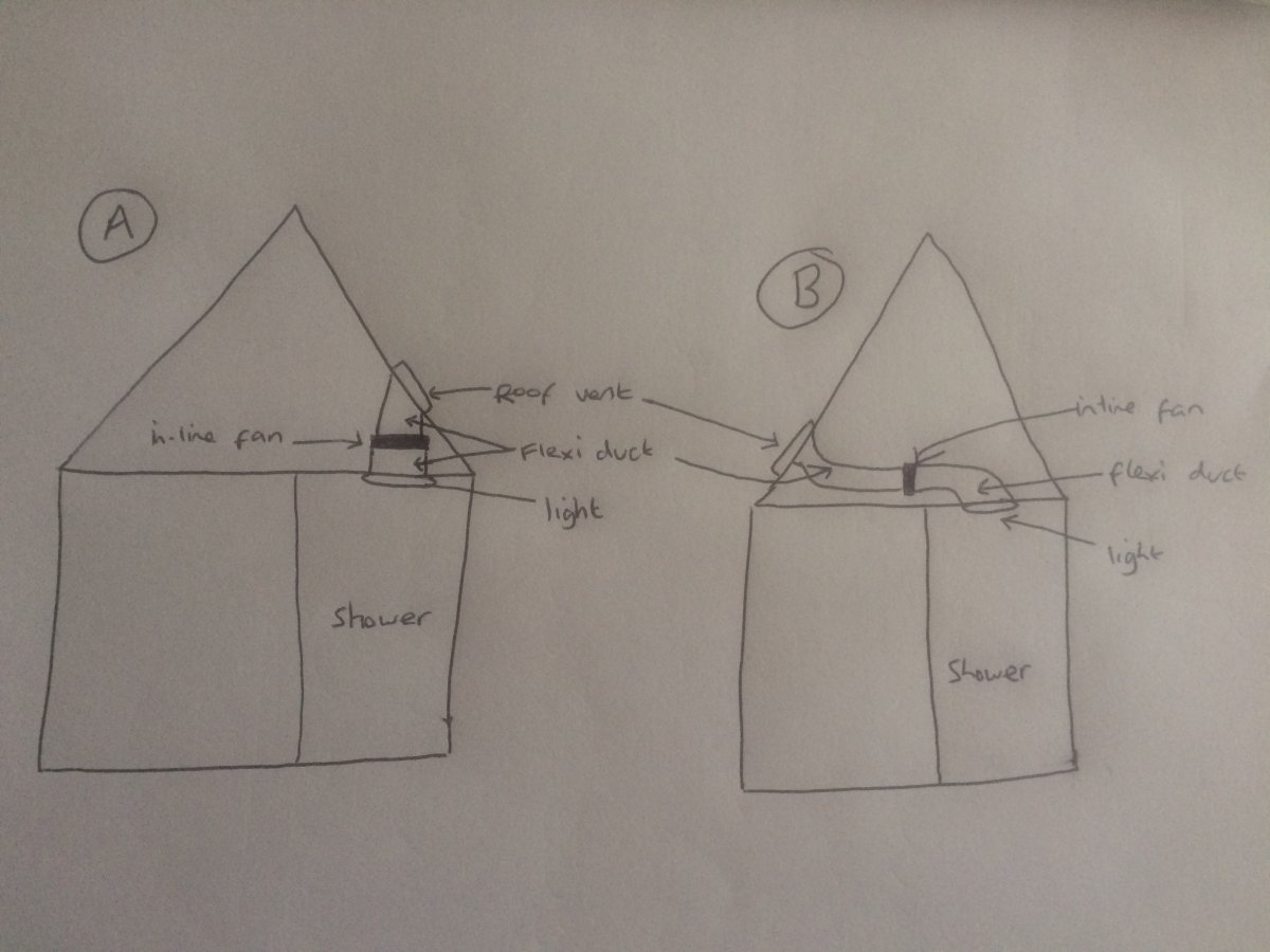

Hi guys!
I’m in the process of installing a new bathroom extractor vent. It’s one of those where there is a light in the middle of it. I’m going to vent through a universal roof tile vent with a duct adapter fitted. I’m happy with the electrical wiring side and have completed this and all works ok.
My question is to do with the duct that connects both sides of the inline fan. I was going to run a 1ft section of flexi duct vertical, then connect the inline fan, then a 3 foot section vertical again and connect this to my roof vent. So I’ve basically gone in a straight line from the light to the roof vent.
I’m thinking that the best route for steam is straight up and out into the atmosphere. Is this correct? or will any condensation run straight back down, through the fan and into the bathroom?
Should I be doing this:
Run a 1 foot section of duct from the light part with a bend going 90 degrees, then the fan, then running horizontal and connecting to the roof tile?
Questions for this method are:
a) I would still have to go vertical again to connect to roof vent adapter, so in theory is this the same as above?
b) Wouldn’t any condensation just build up and say in the pipe eventually causing a leak if it over flowed?
I really hope this makes sense; any help is very much appreciated!!
Please see my poor attempt at drawing this which may help!
Thanks in advance

You need to lag the duct or install a vent condensation trap or both.
