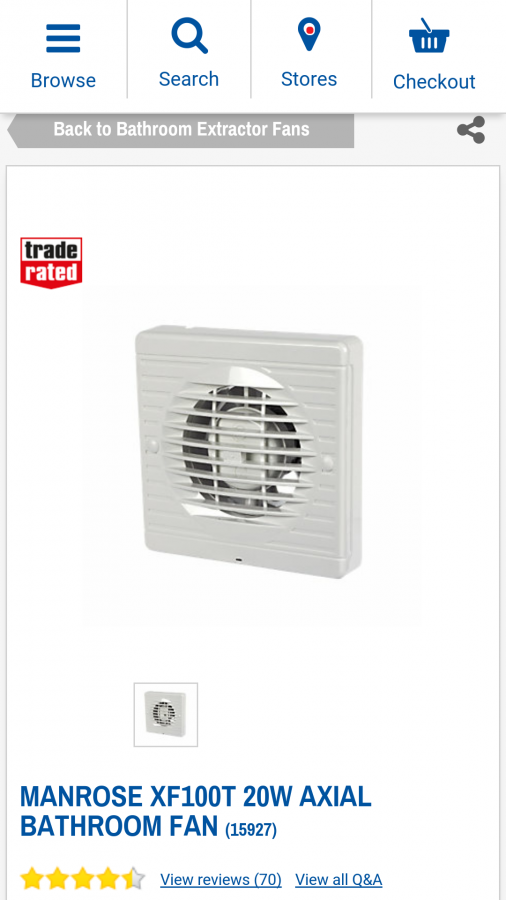

Here's the fan I wish to install

You may not have a neutral available at the existing pull-cord switch, in which case no, you can't just take power for the fan from that point.
Consider also if you really do want the fan to come on every time you switch the light on anyway. A completely separate switch is much more versatile and avoids needlessly running the fan for however many minutes when you just pop into the bathroom for a moment at night.
I'm sure it will come with instructions, but if you want to see them in advance, why not try the Manrose website?
Failing that http://www.google.co.uk/search?q=manrose+xf100t+(installation+OR+wiring)+instructions
Note that it is quite possible (tending towards certain as the age of your house increases) that there will be no neutral at the light switch, so you may need to take the feed from the light itself.
I take it you have thought about whether you always want the fan to come on whenever the light is turned on, and/or whether you want to have to turn the light on if you want the fan to run?
