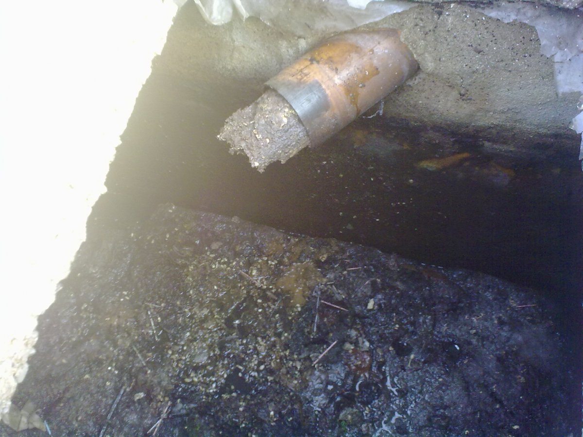

I would not mind betting that the hard stuff is soap and fat deposits , it could almost be mistaken for concrete its so hard.
I have lived at properties with septic tanks for nearly 70 years and seen seen some serious lumps of the stuff.

just found a pic of what I found in a pipe:
Thanks for your comments.

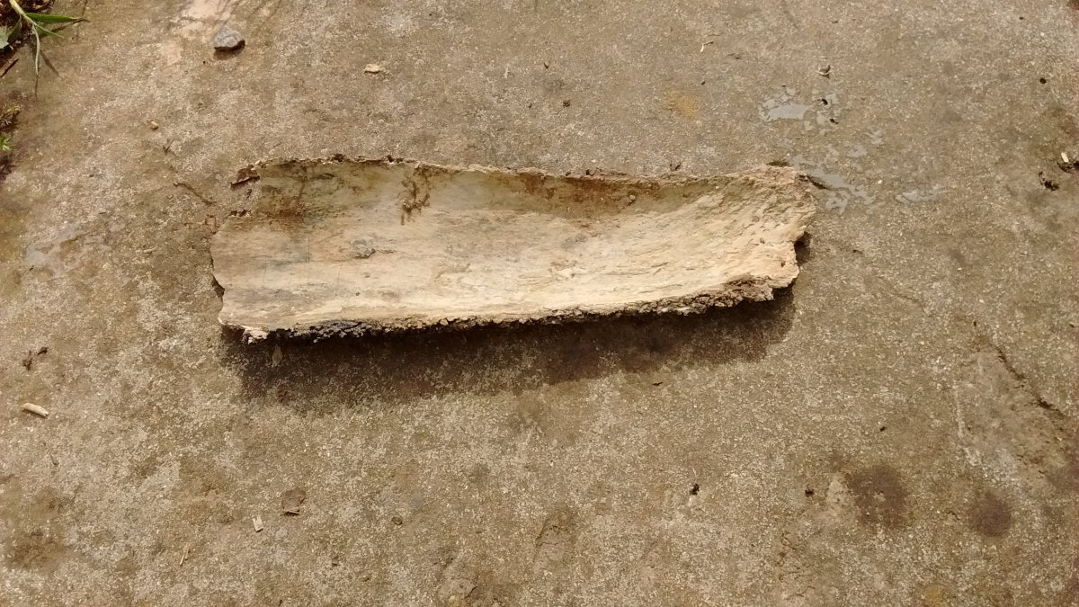

I am not sure what to use to try to remove the stuff. Chemical or mechanical?
I applied some bicarb to the piece pictured and the bicarb has not dissolved it.
Could get some dilute hydrochloric acid or caustic soda but the seals would not appreciate either.
Mechanical means are rods with a circular bung which may scratch the inside of the pipe, the scratches may then act as attractants for any more residue?
Other side of the material.

Your falls from highest to lowest and/or flush volumes are not sufficient to dispel waste efficiently to your septic tank. Without major upheaval and expense, My opinion is that you will have to regulate what you put down the drains (toilet paper type, shampoos, oils, cleaners, etc) and add drain cleaning to your annual/biannual house maintenance schedule!
