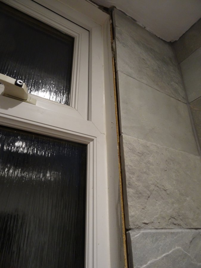

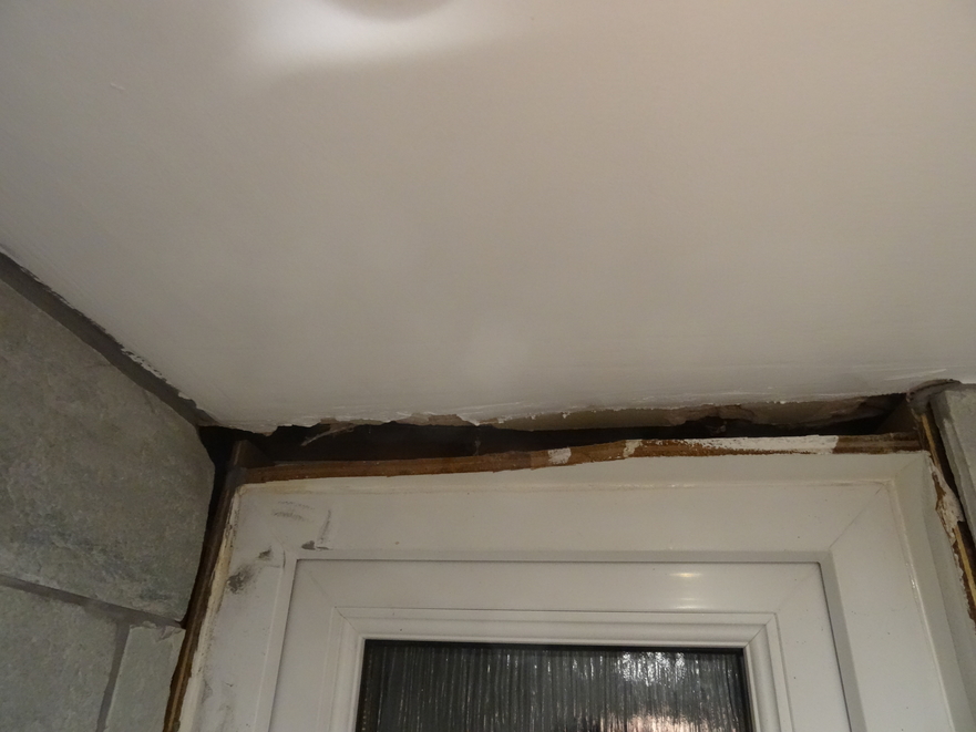

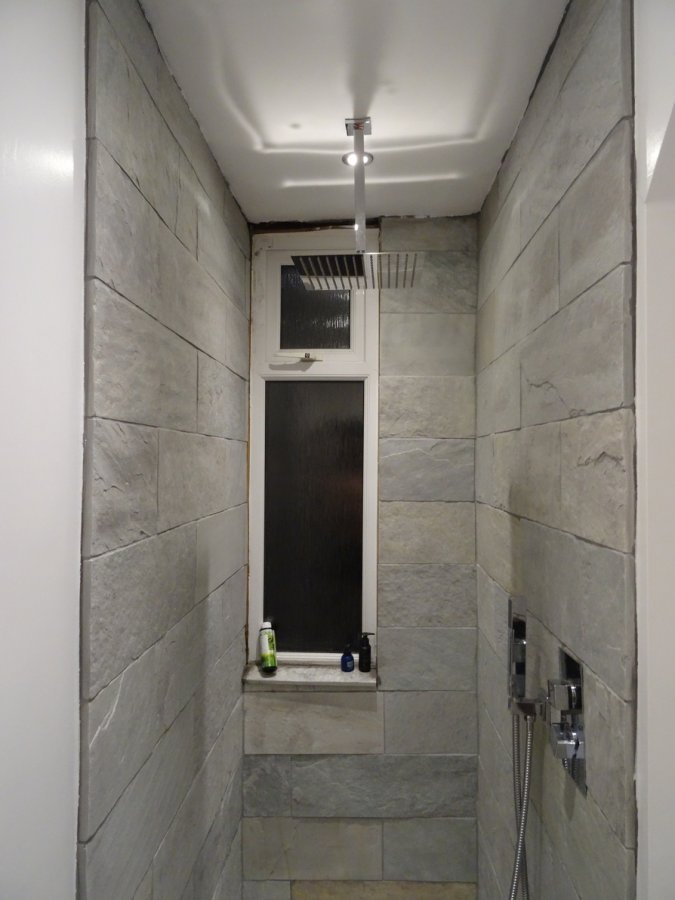

Hi all
Close to finishing renovating a bathroom, in a house I purchased.
In the bathroom before was the shower cubicle with 3 sides of aqua panel.
When removing the aqua panel, the bathroom window was behind.
The wooden frame was hacked at to provide a flush finish for the panel.
Now what is left when tiling is a gar round 3 sides, as you can see in the picture.
I have had a glazier / window guy out to look. He said it is secure how it is.
Yet the tiler should be the one providing a seal etc.
The tiler said it has nothing to do with him.
So is there anything that can be done to neatly seal these gap's, and prevent moisture ingress?

The top should be foam and a white uvpc trim fitted. The edges should be trimmed by the tiler to meet the reveal, tiling looks a bit of a dogs dinner.What did he use to cut them,? a blunt spoon?
Thanks for that.
I'll get on the hunt for some suitable UPVC trim, and get tidied up.
Prob the tilers slopey shoulders, that left a dogs dinner of the edges.
You might be able to put 'J' trim on the tile edge and return into the window reveal [if the tile edges are straight enough].
