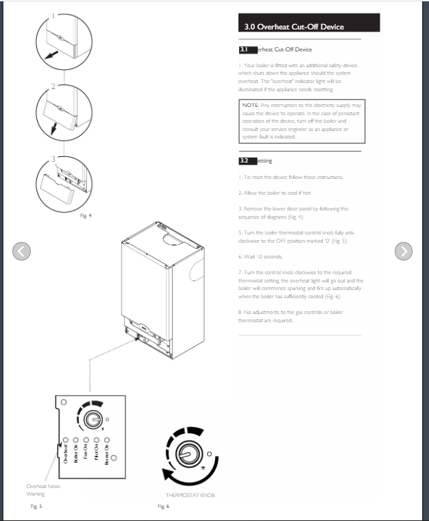

Read instructions for fixing overheating.
It's in manual which can be found online.

Referring to this? Tried these steps... turn it back on... banging from pipes and then the boiler switches off, overheat light back on.
