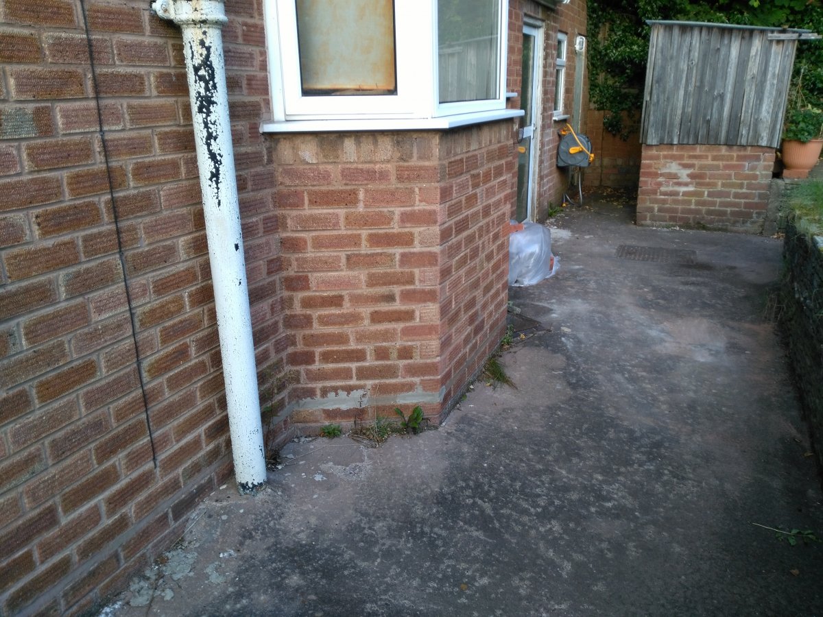

Hi All,
I'm contemplating removing the bay window in my kitchen. It's very awkward to plan around it and it also looks a bit odd on the rear aspect of the house.
I've attached some photos; there's a steel lintel/RSJ over each of the skins of brick; the house is probably 1930s.

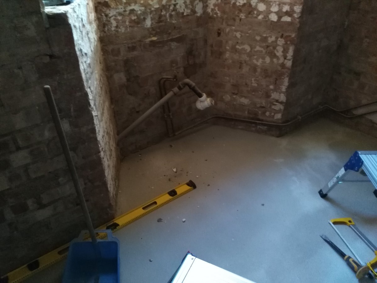

I'm unsure as to exactly what would be involved to help me make the decision. My questions are:-
1) Would I need to remove the RSJ on the external skin? I plan to render the whole rear aspect at some point so this is more about whether or not I can make it weather proof and compliant rather than look undetectable. I think if I'm required to remove the steels then I'll probably just stick with the bay or get some quotes for a pro to do it.
2) Would I need to dig foundations on the new brick line? If the answer to 1 requires me to remove the lintels then I guess this wall then takes substantially more load.
3) The inside already contains a solid floor, is it feasible/allowed to build off this for the internal skin? Again, will depend on the answers to the above.

Foundations for both leaves - yes. Include DPC and cav' inulation if applicable.
External steel can remain as long as thermal bridging is dealt with, weep vents through the render (if there is a CT above) and a robust way of cradling the render via noggs and exp-metal etc.
I personally would lose the external steel giving more options for external finish.
If the opening is to remain the same width then the beams above can stay.
Cut the floor back in line with the internal wall, span a lintel just below ground level and build the new wall off that. Keep the bay bricks for the new wall.
We've used this method and I can honestly say it can be simpler just to dig a footing. Can be a faff chopping out the lintel bearings etc.
With such a small bay, the OP may find that the foundation goes straight across the opening if it's a concrete strip. If bricks it will follow the bay
Maybe, but not when you factor in disposing of the soil, importing the concrete and all the associated stuff. The OP is DIYing don't forget.

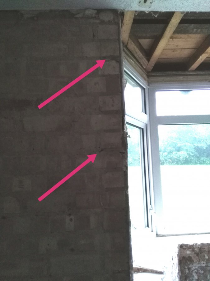

Interestingly, I noticed that there are wooden "plugs" in the walls of the bay, the type that would have a timber frame nailed to, so I'm now wondering if the bay is a more recent addition. Which may mean there's already a few courses of brick on that line?

Those timber pads are what used to be built into walls to nail frames to.
I would certainly investigate below the floor before demolishing the wall.
