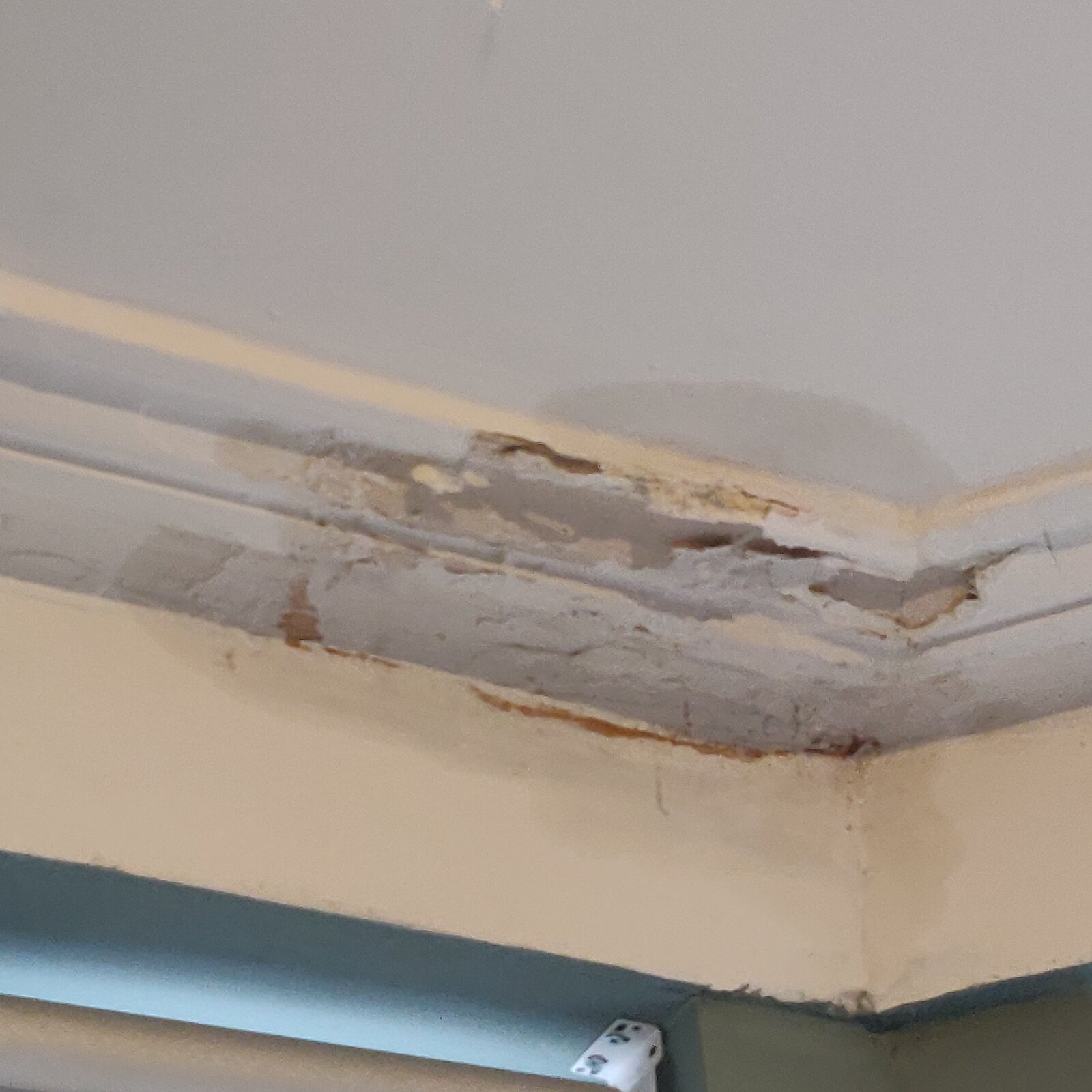

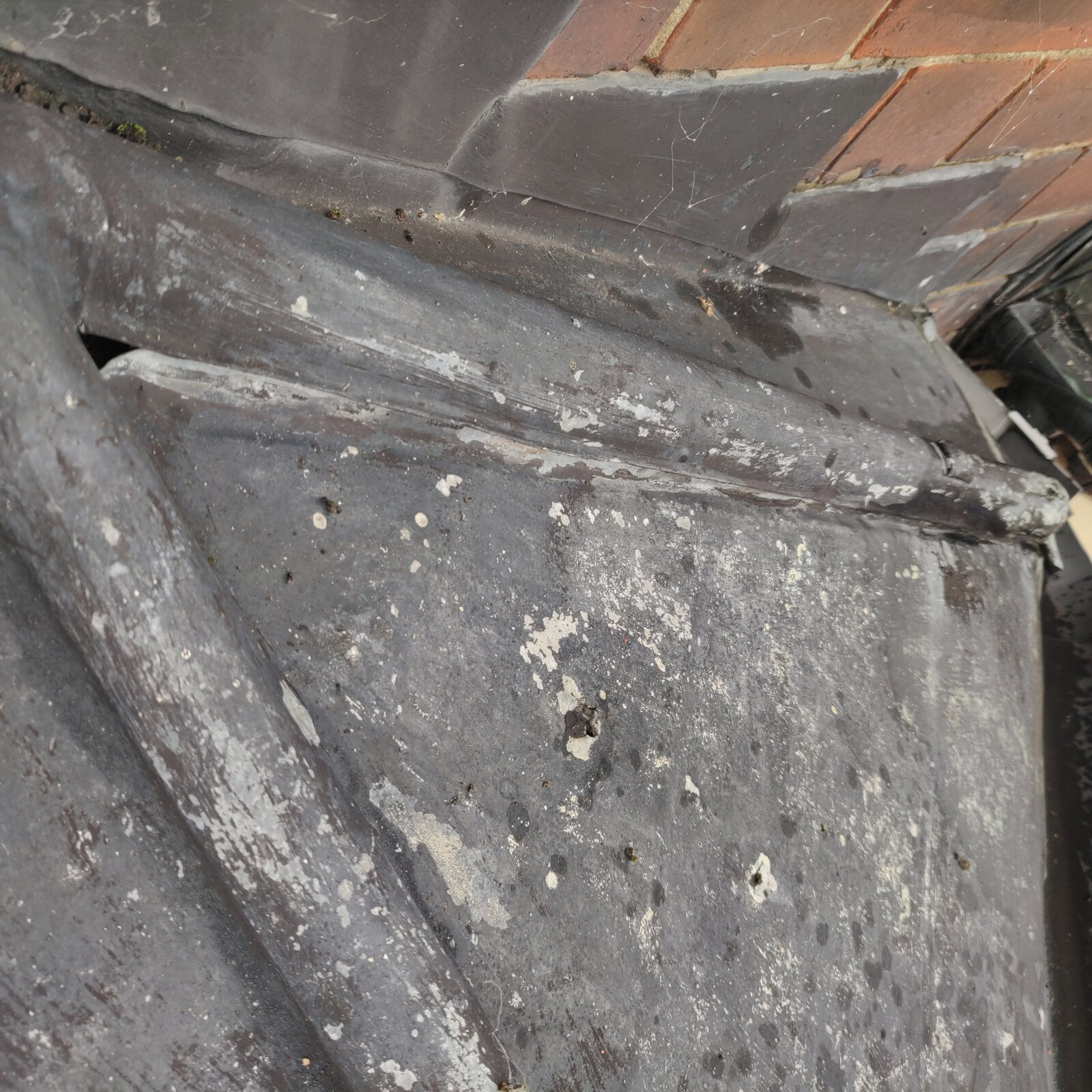

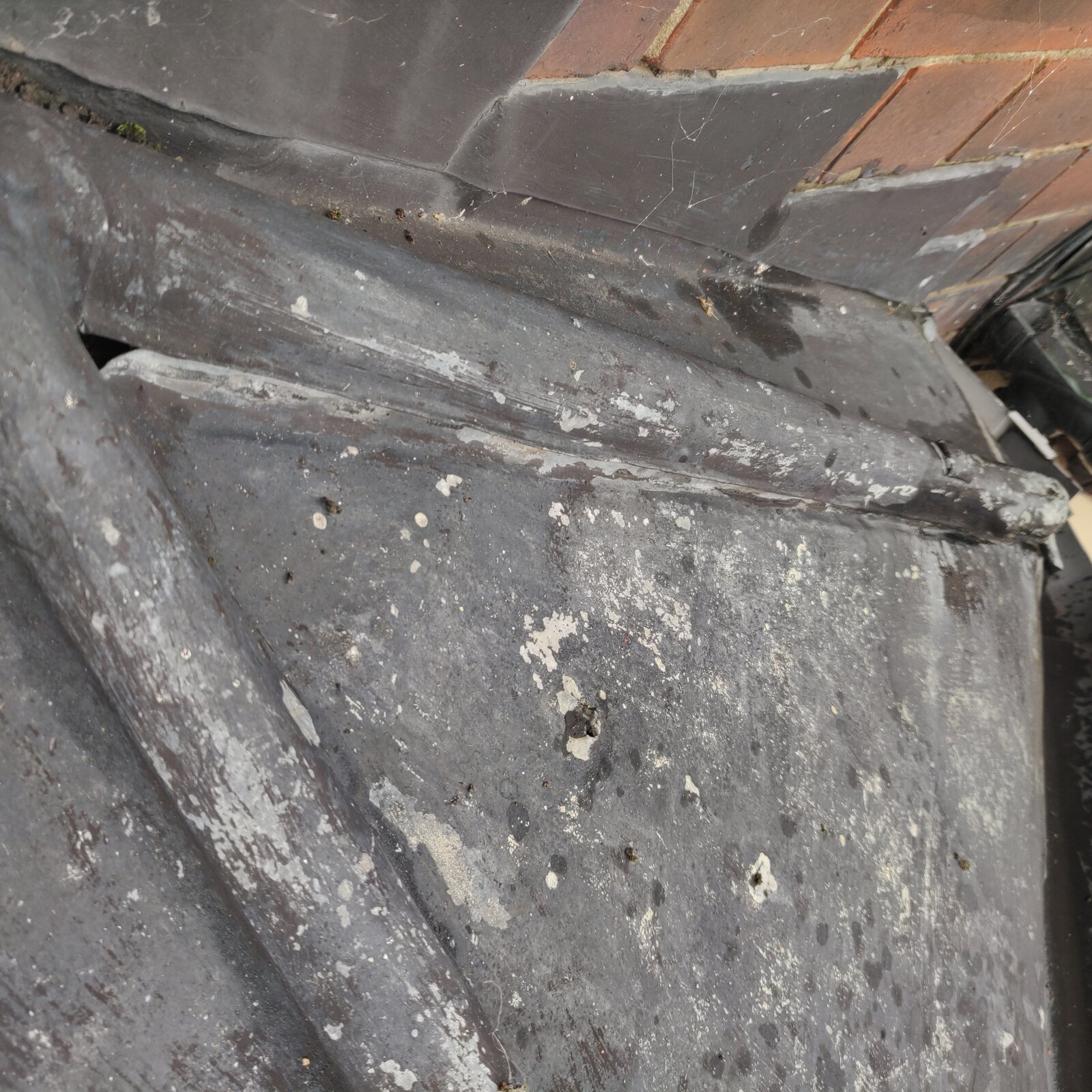

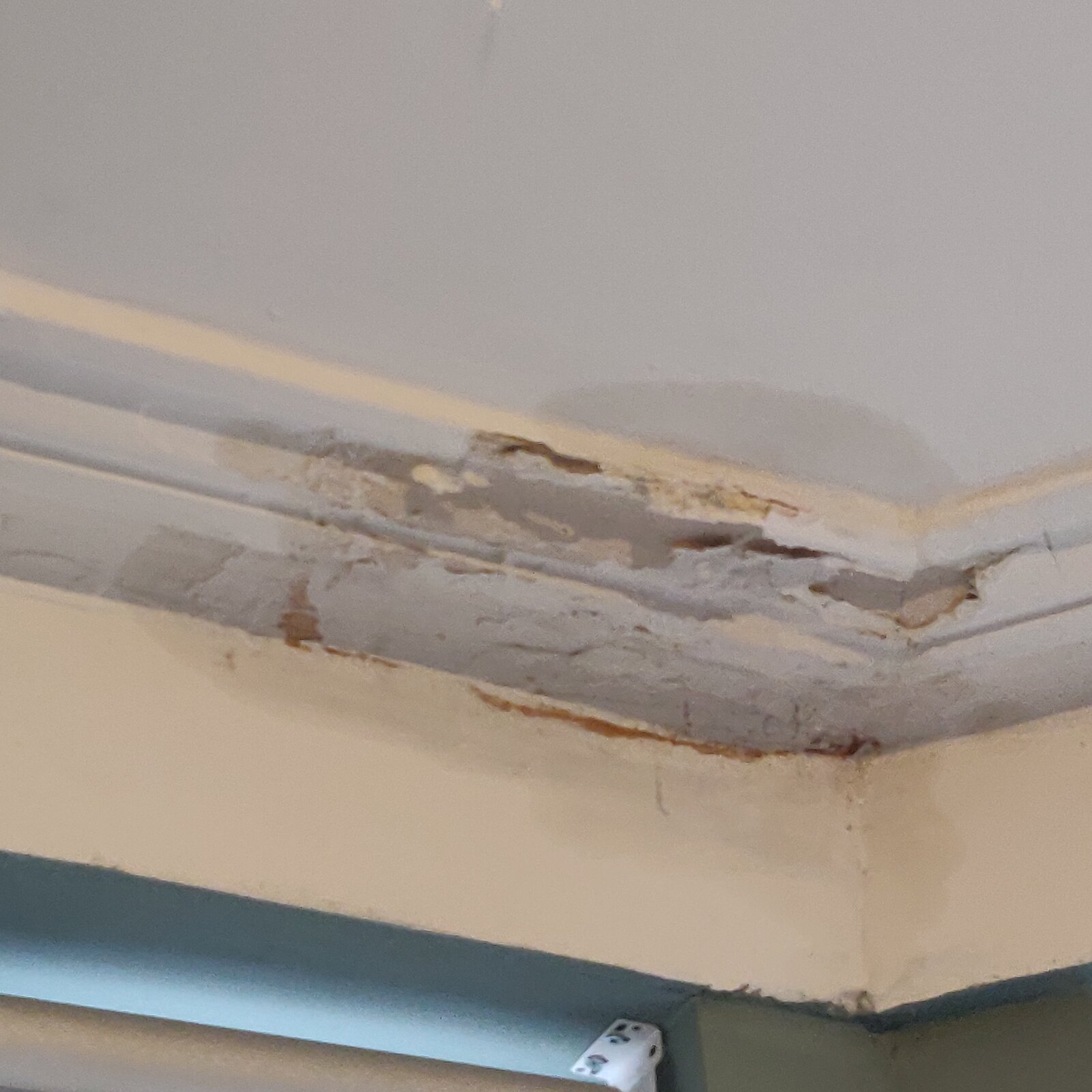

Hi all,
Another leaking roof over bay window
I've just noticed the ground floor roof has got some water marks and is damp due to the heavy rain. The house is about 100 years old and no idea when the roofing was last done.
From looking at the roof, the seal/flashing seems to have deteriorated? Can't get anyone to come out in short time because the weather, so wondering if anyone can help with a temporary solution or possible cause? Don't want it to develop any further.
Thanks.

Looks like one lead bay has simply slipped from where it should be .
Get it repositioned and secured it'll be fine . You don't need a load of s hit plastered all over it
