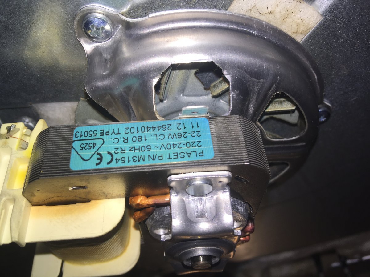

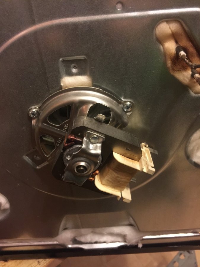

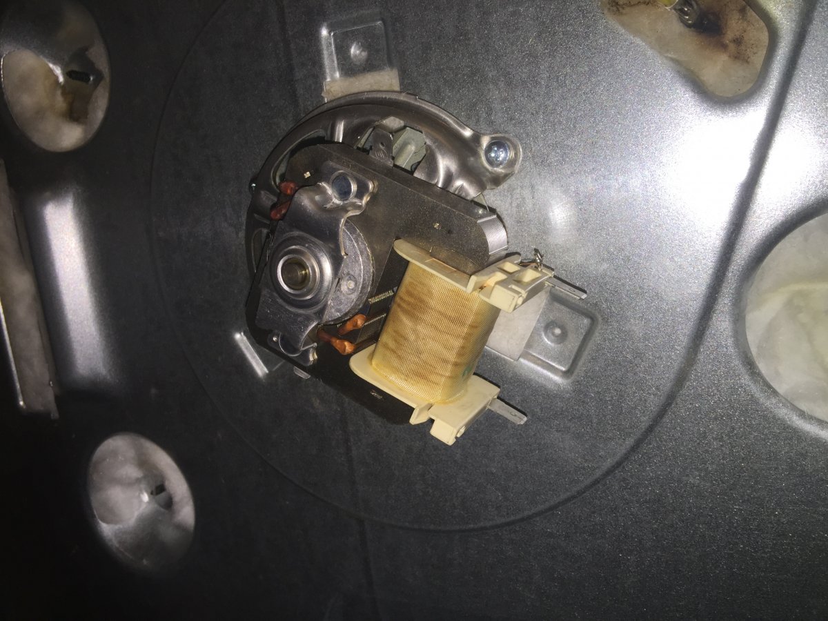

Our cooker fan has decided to work intermittently.
After having a quick look on the net, some suggested that fat may have clogged up the workings.
So I pulled off the back of the cooker and trying to figure out how to remove the motor, managed to lose concentration for a moment and removed the yellow and brown cables from the back of the motor.
I'm not sure which way the go back!!
Can anyone tell me please!!
Pictures attached, including the model of the motor.
Not too sure if I should order up a new motor in the hope that this will resolve the intermittent working problem?

For the connections, it doesn't matter which way.
The fault is either the motor itself, or one of the connections to it. Most likely the motor.
