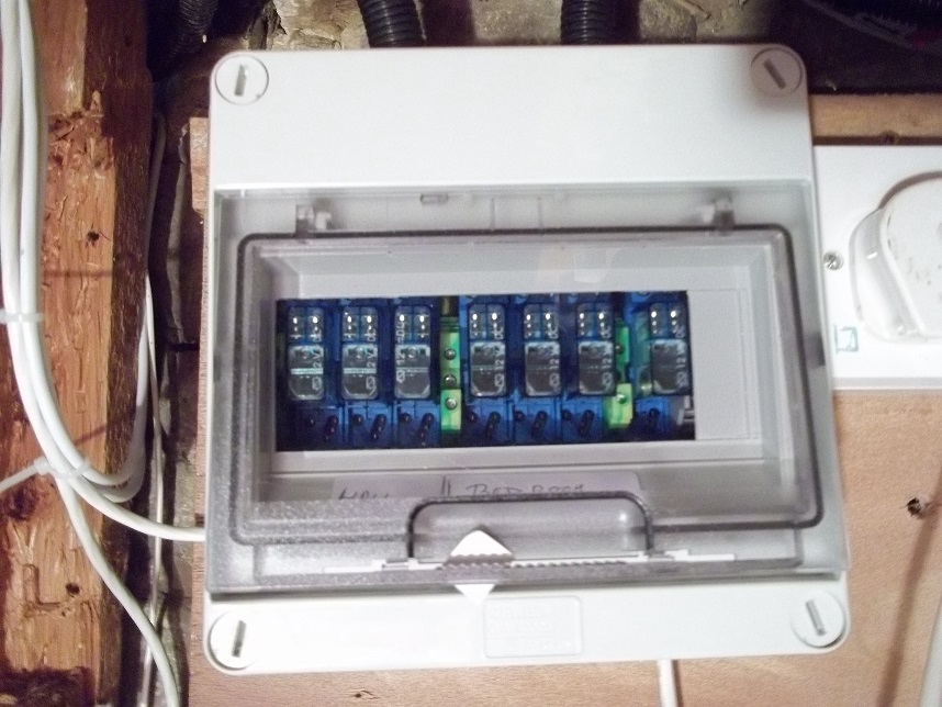

Definitely over thinking this ... Another option if the wiring will be very long is to use 3 bells with self contained mains transformers, then an ELV circuit where the bell push operates a small relay in each of the bells in place of a bell push.

Are would be nmore expensive than fitting a DIN rail relay and DIN rail transformer into a suitable enclosure and thus having a 12 volt push button

I am sure like a lot of things, Bell cable is not what it used to be, what you get when you order bell cable often has a smaller CSA than the same as already installed/being ripped out, meaning that although you might not have changed the length of run much, when you come to put back, you might have voltage drop issues you never had before. As normally in this application the bell and tx could be sited together, with a long run to the push, my prefered solution tended to be a relay with a 12V AC coil.
