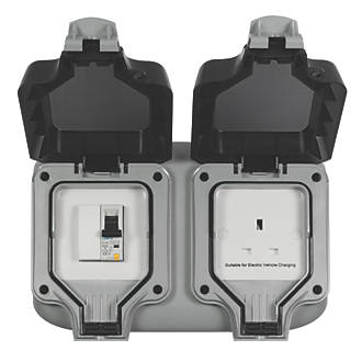

There are units which do have RCD and socket outlets, upload_2022-4-3_23-48-45.png they are sold as Domestic Mode 2 electric vehicle charging stations, not sure I would want to use one to charge a EV but it is a good unit for garden electrics, at around £50.
