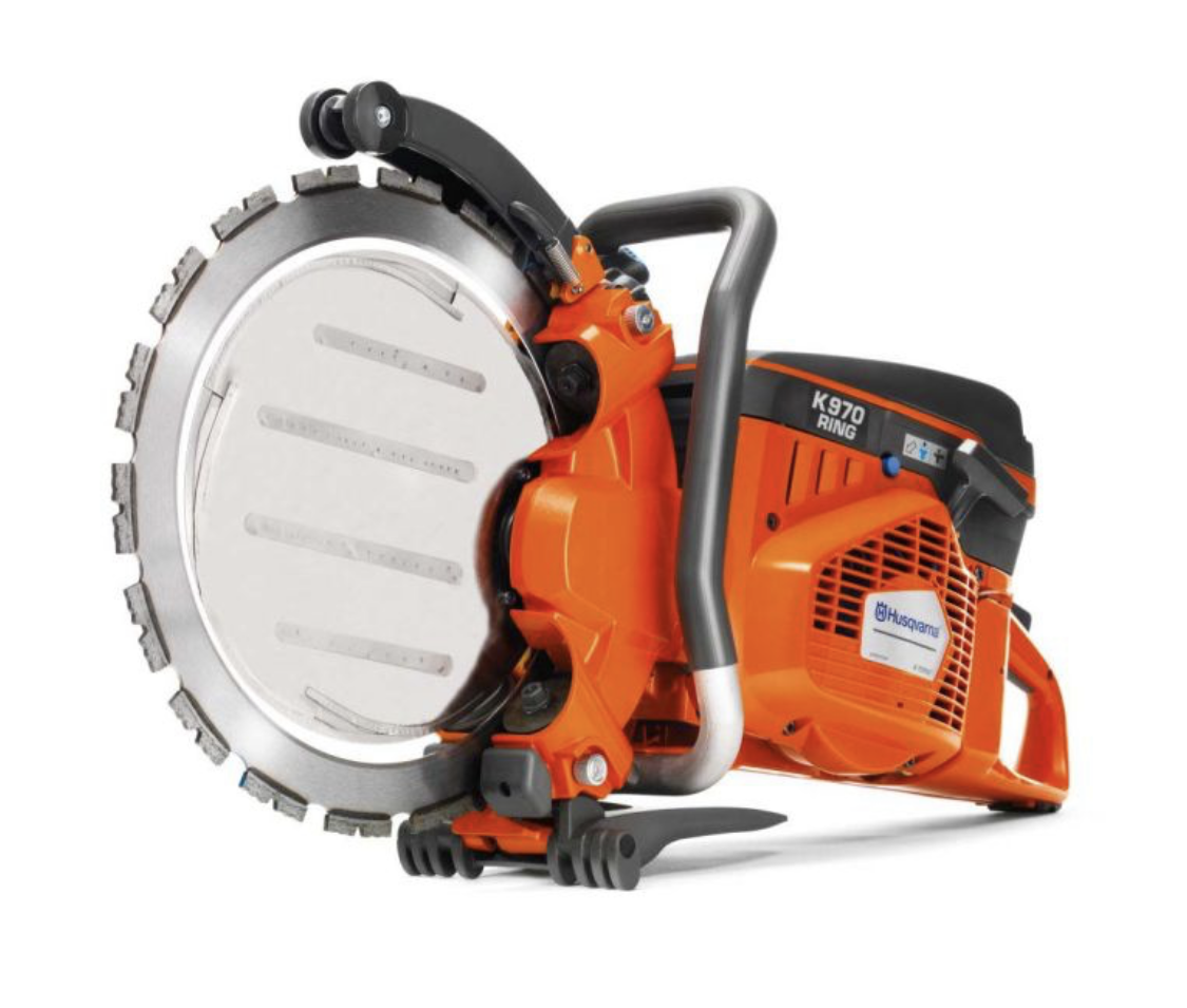

You can get (probably hire) a tool called a ring saw which is like a Stihl saw but the blade is a ring that runs around a large plate the same thickness as the blade. It is driven by rollers at the edge so nearly the entire depth of the blade can be used for a cut. They're petrol or hydraulic; if hiring a hydraulic one factor in the cost of hiring a power pack too

These things are phenomenal, cut about 11 inches:
Electric and hydraulic variations exist too. I'd definitely look to hire one rather than buy, mind!
A ring saw. Holz-Her used to be well known for their timber ring saws. Not cheap
