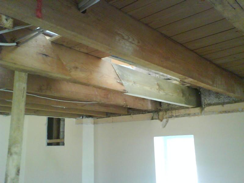

I am rather new to this forum, although I have lurked and used many threads to help me in my DIY-ing. At the moment I am trying to get the ceiling done in my living room and am wondering what the best (quickest and cheapest hopefully) way of getting this sorted would be.
This was all covered over with those polestyrine tiles, no surprise. The story is something along the lines of "the bath fell through".
There are some bits that are warped - I think that this will just be knocked down so that the new boards sit straight.
Also there is a corner (see below pic) at the edge of the ceiling, how would I go about getting this to look flush if I put up new board?
All advice appreciated, and there'll be more where this little project came from!
Cheers.
just over board the whole ceilin, bring the boards flush with the corner then before you skim fit a 3mm skim angle bead, then you can plaster the ceilin and either feather out the bead on the return or easy fill the bead on the return.

I'd agree with that JR,, best way to do it.

I should have mentioned I'm not a plasterer. There are too many technical terms I'm not used to there. Elaborate if you can? I do get the main idea though, and was thinking along the same lines.

being a plasterer im afraid i will always stand by a skim will give you a better finish, but as i said i spose thats because im a plasterer.
OP locate the joists in the ceilin and mark on the wall then get a chaulk line and a friend stand at either end of the room line up and ping the line, you now have a map of where your joists are.
to find yours joists without makeing a mess buy a stud locator or use an old screwdriver and a hammer, from the corner of the room try to find the first one by just punching the screwdriver through the ceilin, then once you have one measure 400 centres and your nex one should be somewhere round there use the screwdriver and hammer to help find them, make sure you mark them as you go.
meausre and work out the area of the ceilin then divide it by 3 if youve done it in meters or 32 if youve done it in feet, this will give you the amount of plasterboards you need alow one or 2 more just to be safe (better to be safe than sorry). you will want 12.5mm boards 8ft by 4ft.
when your boarding youll proberly want a mate to help you, when you get to the edge (corner) just measure the board tight to the edge and screw into place, once the boards are up measure the length of the external corner you have just made and buy a 3mm skim angle bead.

you can put this up with either a staple gun, small nails or some plaster which ever you prefer.
then (if your goin to plaster which i would but thats just me) you need.
some skirm (joint tape) to put over the joints then have the ceilin plasterd.
you will then have the other side of the bead that you have put on the corner (on the up standing side) showing still with this you can either put some PVA onto the wall bout 400 to 500mm strip from the bead up and plaster this feathering down the raw edge to blend it in or as a diyer you can apply easy fill over the area over 2 coats sanding back to make it blend in perfectly, if you do the easy fill make sure you buy the bagged un-mixed stuff its much better to use and does not shrink as much as the premixed stuff, if you buy premixed you could be refilling several more times than you should be due to the exsesive shrinkage.
i hope thats made more sense for ya took flipping ages to type that, let us know how it goes or if you have any more questions you know where to come. ;) good luck

You will get the work, just in about 5 years when the tape peels. The paper tape ALWAYS peels eventually and the external corner beads will get knocked and when the metal starts ripping it will never stop and you can not repair it without removal. Then I think that most people will get a plasterer in rather than spend a few days sanding the finest powder know to man into their home.
Skimming is easier than tape and join.
