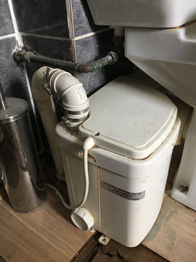

Thank you so much everyone. I'm just going to take a photo to see if that helps. We have fashioned a sanislim from a cardboard box and are popping round some plumbers/shops now to see how we go but would still value your opinions
Oh also it's just for the toilet nothing else attached
Thanks again
Basically everything is coming out flooring, tiles, macerator toilet the lot and will all be replaced. There is a carpenter coming as part of the repairs to the leak and he is changing part of the tiling to a wooden panel which will be decorated but have screws to allow access to some of the plumbing (central heating) behind. The people who lived here tiled over the whole area behind the toilet and to the left covering over the pump for the central heating. We had to have it all ripped off when it broke and so the tiles are broken/damaged now. It's a whole lot of bodged jobs unfortunately
