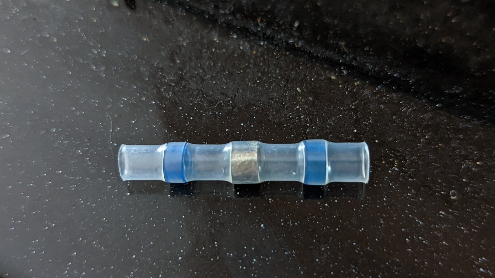

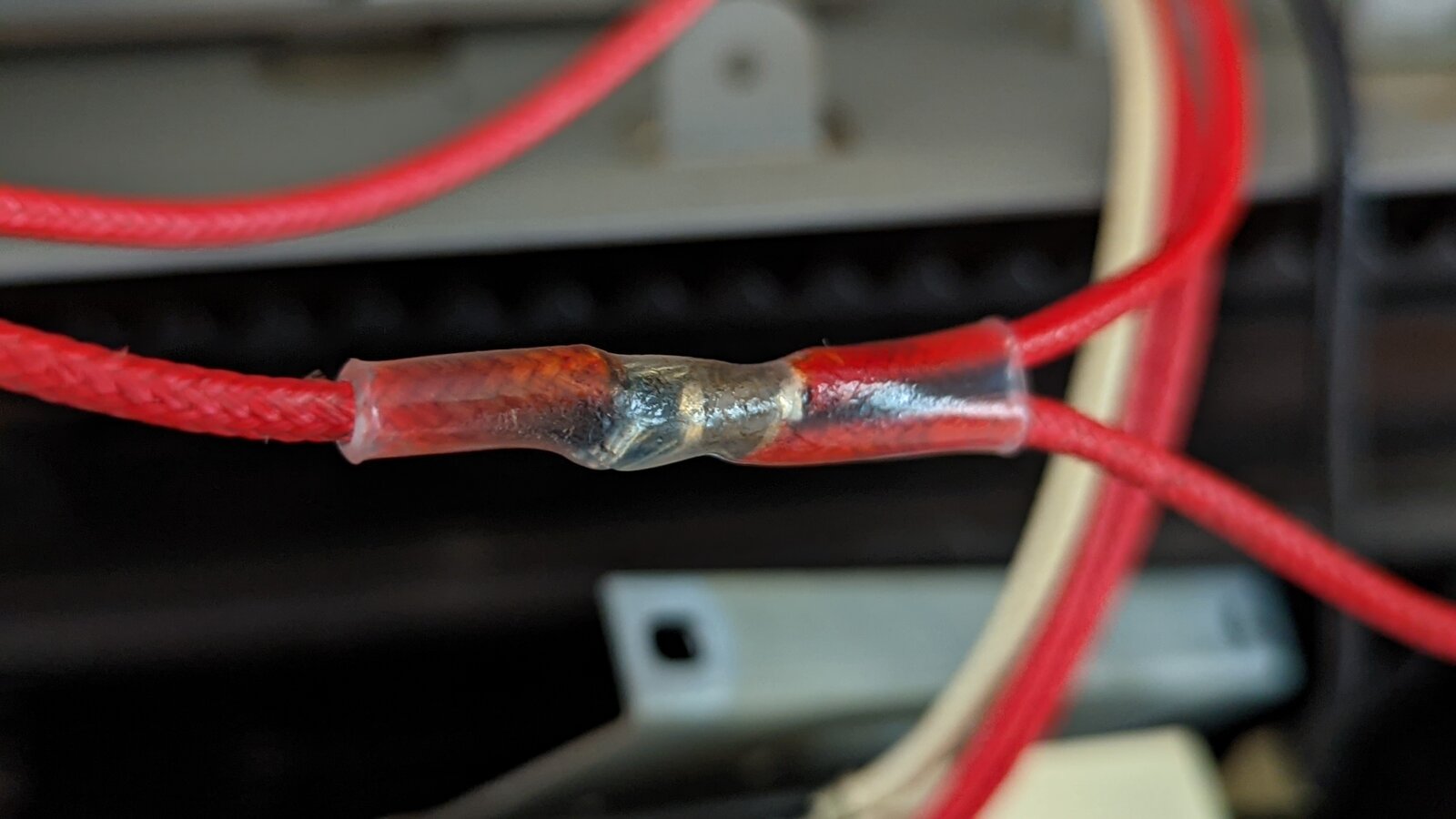

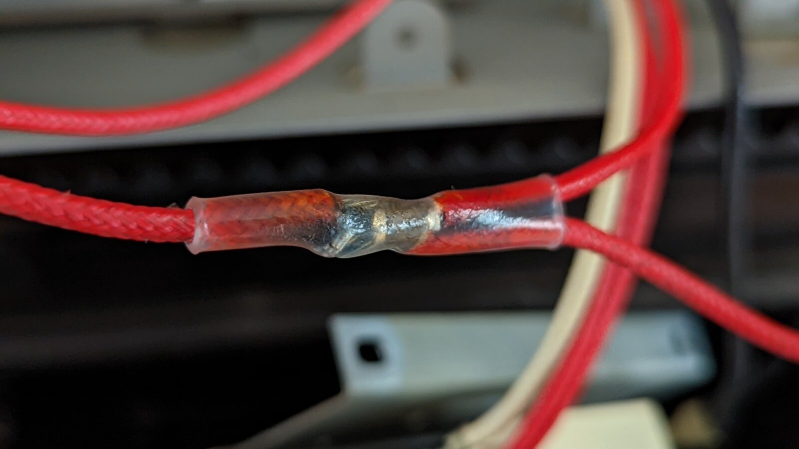

I found in BandQ some wago style connectors (max 105c) and also these solder shrink wrap tubes so I tried the latter. Not convinced there was enough solder but it seems solid enough. Only issue is the steel wire was quite sharp and in danger of poking through the shrink wrap.

No easy way to test electrically how good the connection is. Mechanically it's very strong.
Unsure whether to snip it off and just use the push fit connectors after all lol
Solder can creep, if the joint is mechanically sound then solder added to ensure not electrical bad connection great, but getting solder to form an alloy and connect correctly is not quite as easy as it seems. And with non lead solder the flux is really nasty stuff, the solder may be safe, but not the flux so some way to ensure you don't breath in fumes.
The crimp needs to grip the wire well, which means expensive crimp pliers, although just looked and have gone down in price so can get £15 versions for insulated crimps.
Temperature depends on where on the oven and it seems likely not that hot where you are working.
Mechanical strength is also important, epoxy lined shrink sleeve can both insulate and give mechanical strength, some crimps also either crimp the wire with the plastic or can use shrink sleeve built in, it depends on type used, but also the crimp needs to match the pliers, all red crimps are not the same.
The maintenance free push connector can do a good job, but getting shrink sleeve over them is unlikely to work, and it depends if there is likely to be any movement.
You say three wires, so not sure if you can crimp or not.
You can still get ceramic/porcelin connector blocks for high termperature applications. I wouldn't have tjough B&Q would carry them though, readily available online though and decent wholesalers should stock them
Thanks. I went with the solder/shrink thing above in the end. Unless anyone thinks that looks terrible? I haven't used them before.
Scrwfix sell those:
I think it will be fine. Does the oven work? Then run with that and if it fails again go for another strategy
