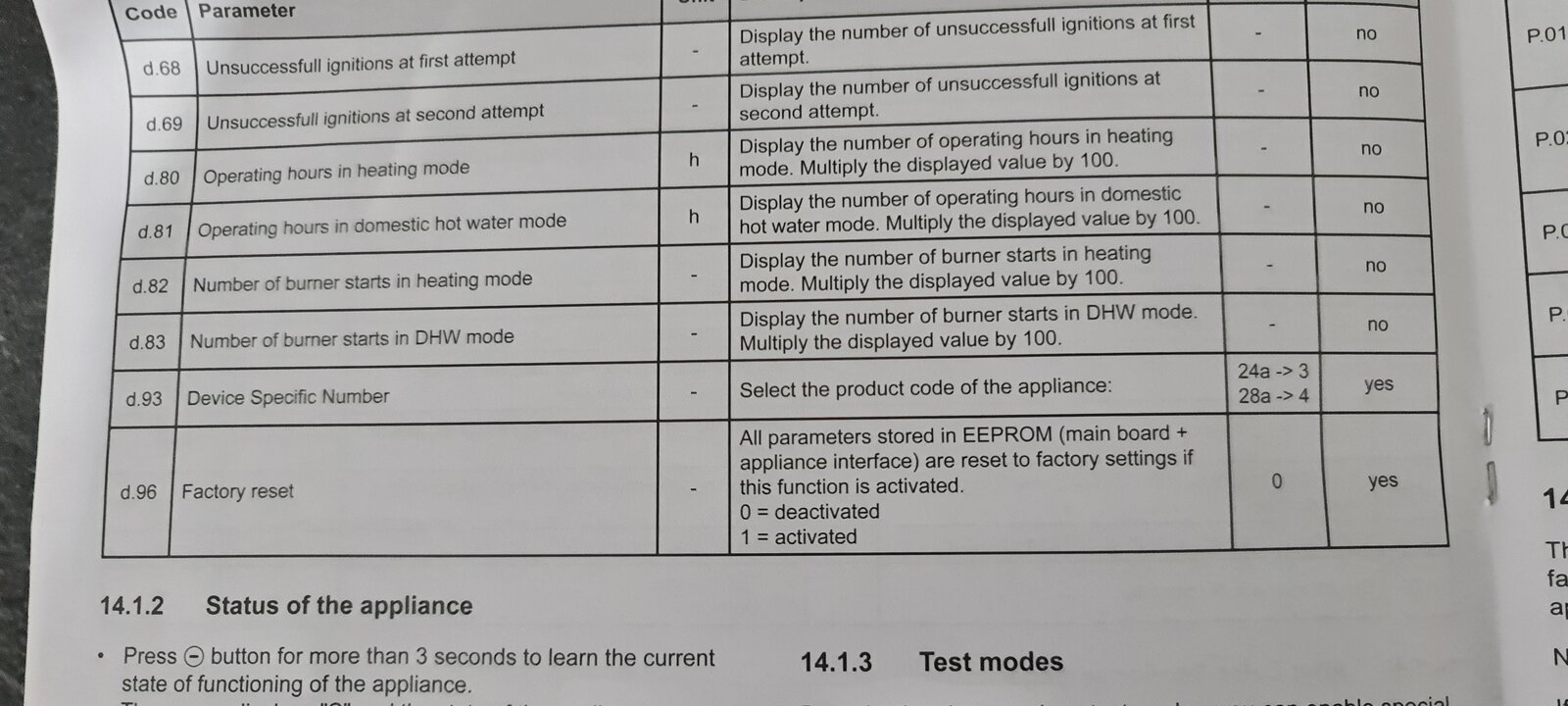

Betacom 28A - Nest
I thought glowworm and vaillant would have the same software setup, could be wrong though, you might have to ring glowworm.
There should have a d93..
Would a factory reset work :confused:
The service book shows D.93 but it's not showing on the screen!
You need the "after sales service password" to get into d93 according to the manual.
Yep, just worked out theres 2 menu's... I'm in the installers menu which the password is 96 as stated in the book! Hum, just need to go through 99 numbers now to find the other haha!
Picasso...thanks for all the help mate.... Cracked the code :D and sorted within 2 minutes...nest is now working fine (y)
