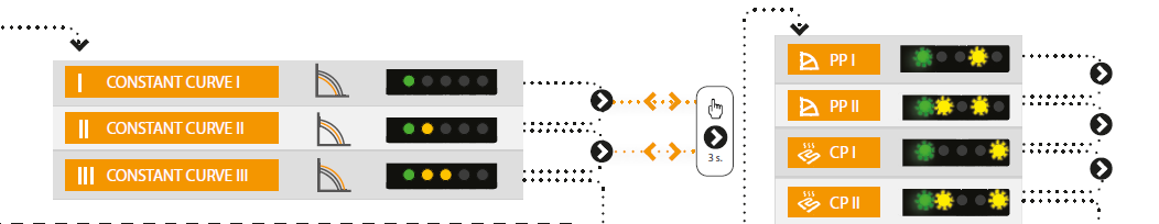

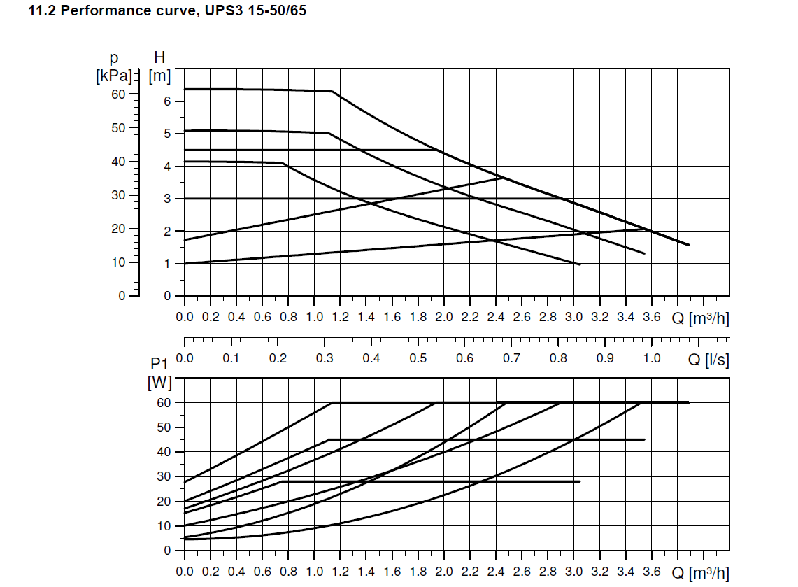

The UPS3 15-50/65 is a very powerful pump as you can see from below but there are a few options which should satisfy your needs without noisy operation.
Would suggest PP2 (proportional pressure) as first choice and if too weak suggest CP1 (constant pressure).
Your present choice of CC1 will run at a 3.9M head at a typical CH demand of say 0.8m3/hr, 13.3LPM, whereas PP1 will only provide this at 2.4M and CP1 at 3.0M so one of these should do the job IMO.
If the demand is actually 13.3LPM at 3.9M, then PP2 will provide 10.1LPM at 2.23M and CP1 13.3LPM at 3.0M.

I've experimented with different pump settings, speeds I, II, III all make a tremendous row and I get steaming hot water in the expansion tank. Setting CP1 as suggested here is much quieter, and guess what, no hot water in the expansion tank ! so I've left it on that for now.
I did try Proportional flow mode (making sure the CH zone valve was open) and this is even better, definitely want to give this a try but from what I've read I'll need to set the ABV wide open, and put a Taco setting valve in series.

PP2 should be your best choice IMO, PP1 probably too weak.

yes agree about PP1 it seemed a bit too weak when I tried it, PP2 seems perfect.

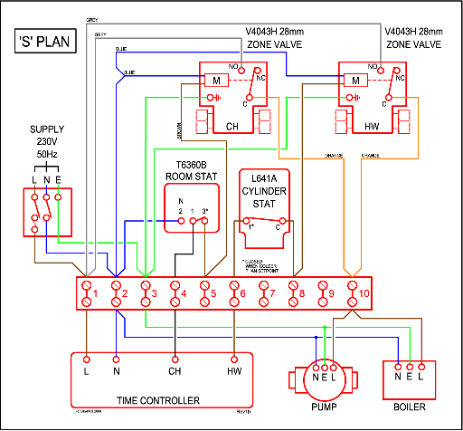

Ah yes re-read what you said about wiring a valve up on the bypass to open when the CH zone valve closes. I've got two zone valves so it would have to be if BOTH DHW and CH zone valves are closed, then open the bypass pump overrun valve.

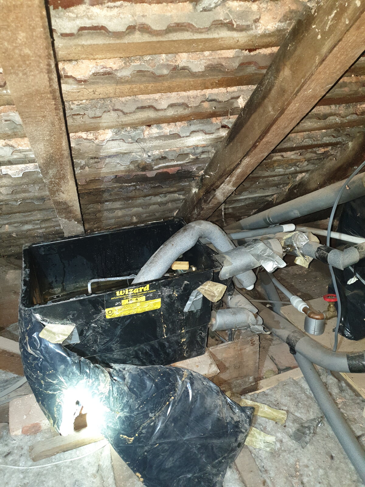

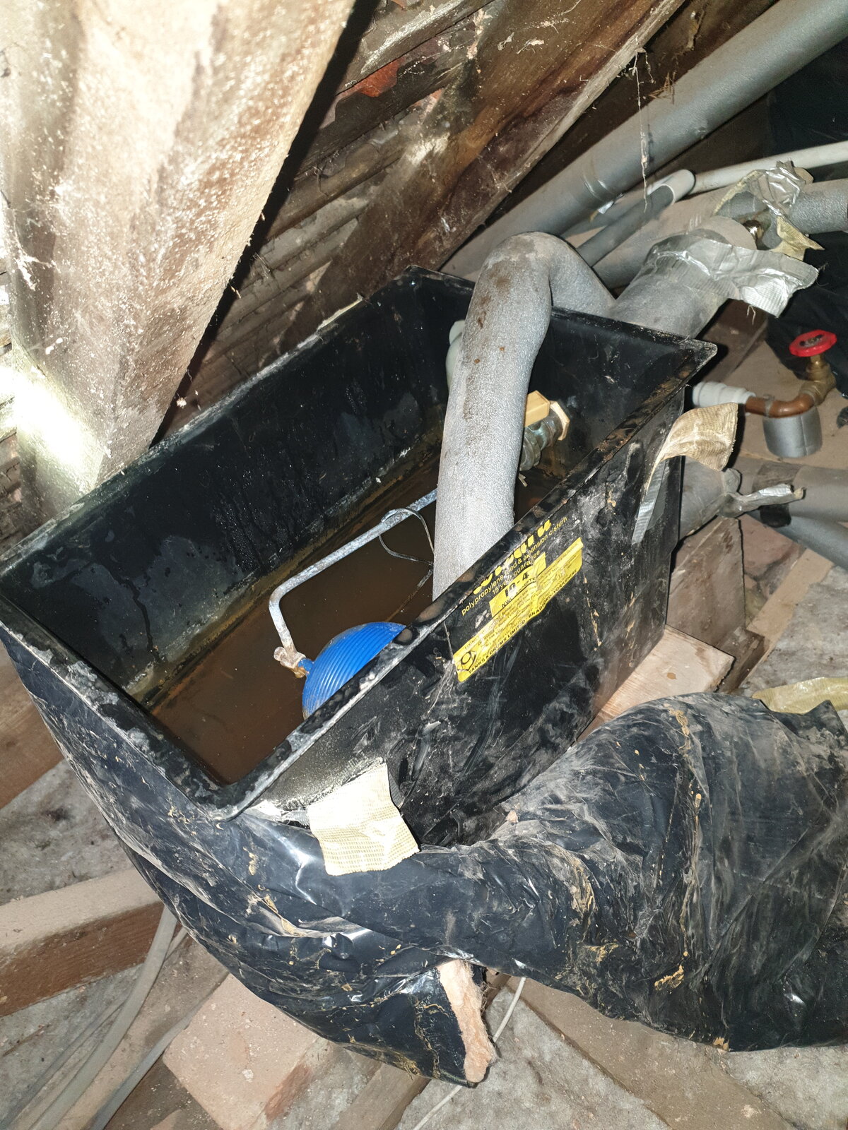

Pictures attached, it looks to me like the vent pipe isn't high enough above the water level. Both the vent pipe and the FE pipes are hot, although I never seen or heard water running out of the vent pipe into the tak.

Ah yes re-read what you said about wiring a valve up on the bypass to open when the CH zone valve closes. I've got two zone valves so it would have to be if BOTH DHW and CH zone valves are closed, then open the bypass pump overrun valve.If the supply to the NO valve is taken from terminal 10 then that should do?.
If the supply is taken from terminal 10 then should work OK?.
The vent shouldn't be immersed in water.

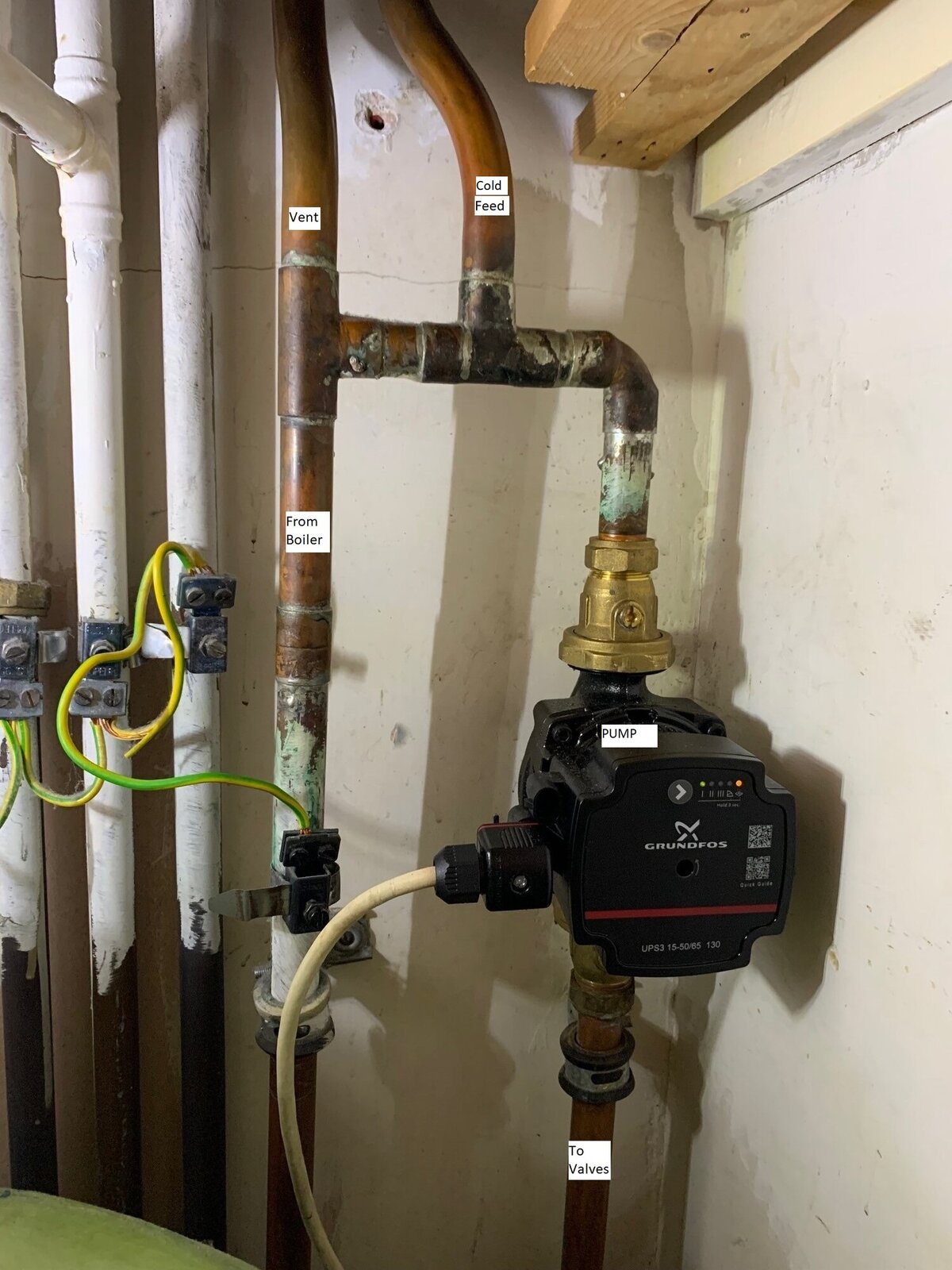

Can't see where the cold feed is teed into the system but might be done like below.

Very doubtful that's the reason IMO, but it needs sorting. Is (hot) water coming out of the vent pipe? If so, could be a partial blockage between the cold feed and vent connections (depending on how it's all piped up).
I had my doubts about that too, but then I'm not an experienced tradesman. The vent and FE pipe tee off close to each other just before the pump. The system has recently been powerflushed so it ought to be fairly clear.
I can't see any hot water coming out of the vent pipe, that's not to say it isn't happening though.
There's no hot water in the expansion tank if I leave the pump set to CP1 so I'm leaving it like that for now, until I can get someone to take another look and probably redo some of the pipework in/around the expansion tank.
You could try increasing the pump speed temporarily as a test, see if it causes overpumping. Does the cold feed pipe come in up and under? That's the correct way, if it tees off the top of the pipe it can allow convection of hot water into the F/E tank.
