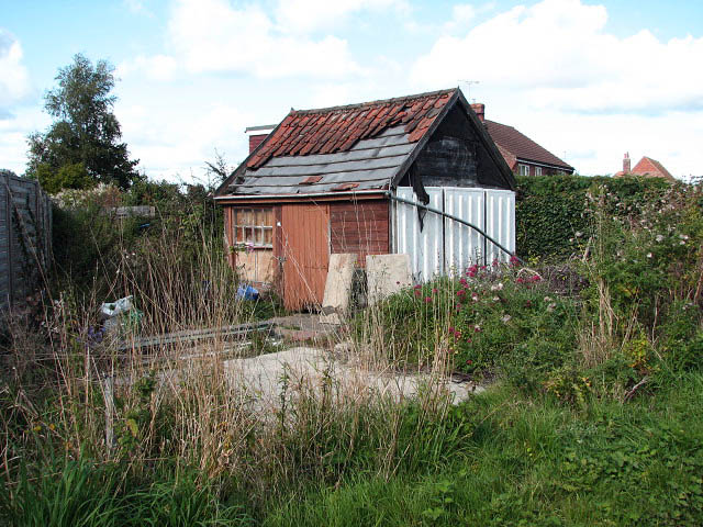

This is a fairly cheap option and will last forever.
I noticed you borrowed some of the shed roof tiles for you new extension. (y)
Reuse, repurpose, recycle. It's all the rage.
Next time you're back there, do me a favour and measure that frame to see if it will fit the kitchen opening I've just built - needs to be 1500 across the bottom, 1070 up the left side, 1035 up the right side and 1550 across the top.

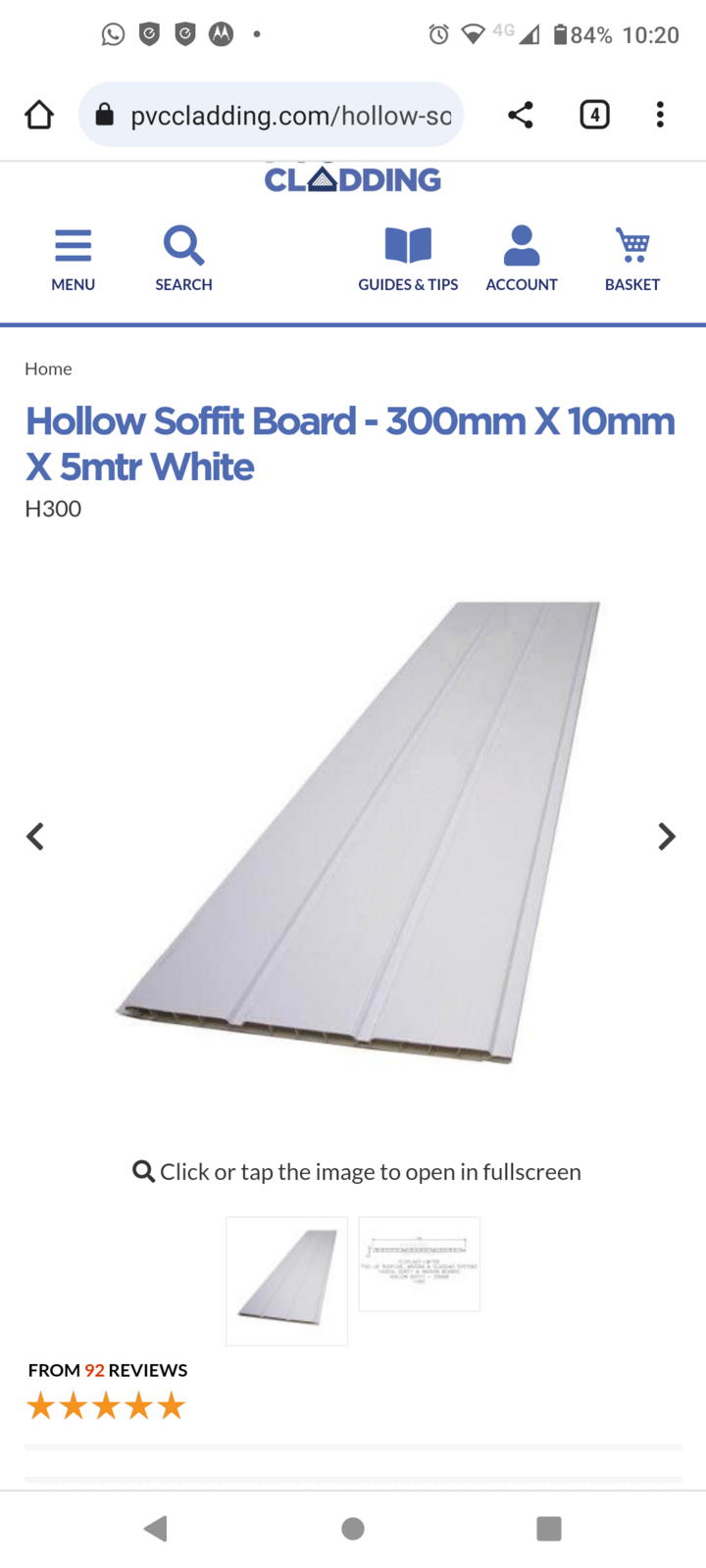

But he's certainly used incorrect hollow soffit as vertical cladding :rolleyes:
Soffits are horizontal, and hollow board should not be used vertically due to the exposed nailing. So a hollow soffit board is for horizontal soffits that don't get wet.
But cowboys tend to use them because its cheaper than proper shiplap, and its quicker to do. And only idiots actually specify it on a quote.
hollow soffit has be used (and fitted) incorrectly for vertical fascia/cladding.
It's not just poor quality, but it is actually incompetent/fraudulent, and if she gets no luck from the roofing firm, then its one for the council's consumer protection/trading standards to get involved with.
