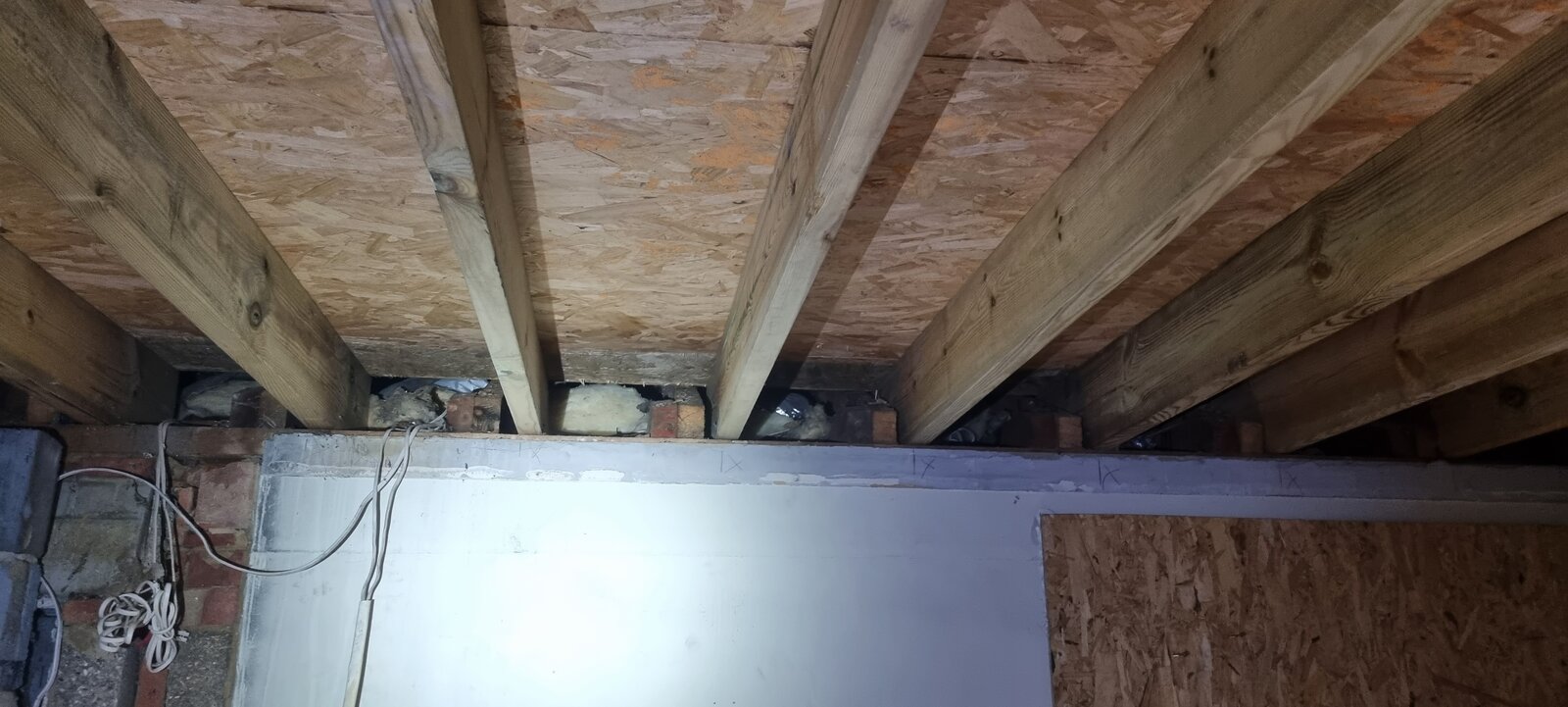

Blocking gap between warm and cold roof.

How do we go about blocking off this area between old roof space cold roof and new flat roof warm roof. Photo attached you can see the old roof and gaps linking cold roof. Thanks.

Celotex and foil tape.
Celotex and foam and foil tape.
Depending on your cutting skills.
