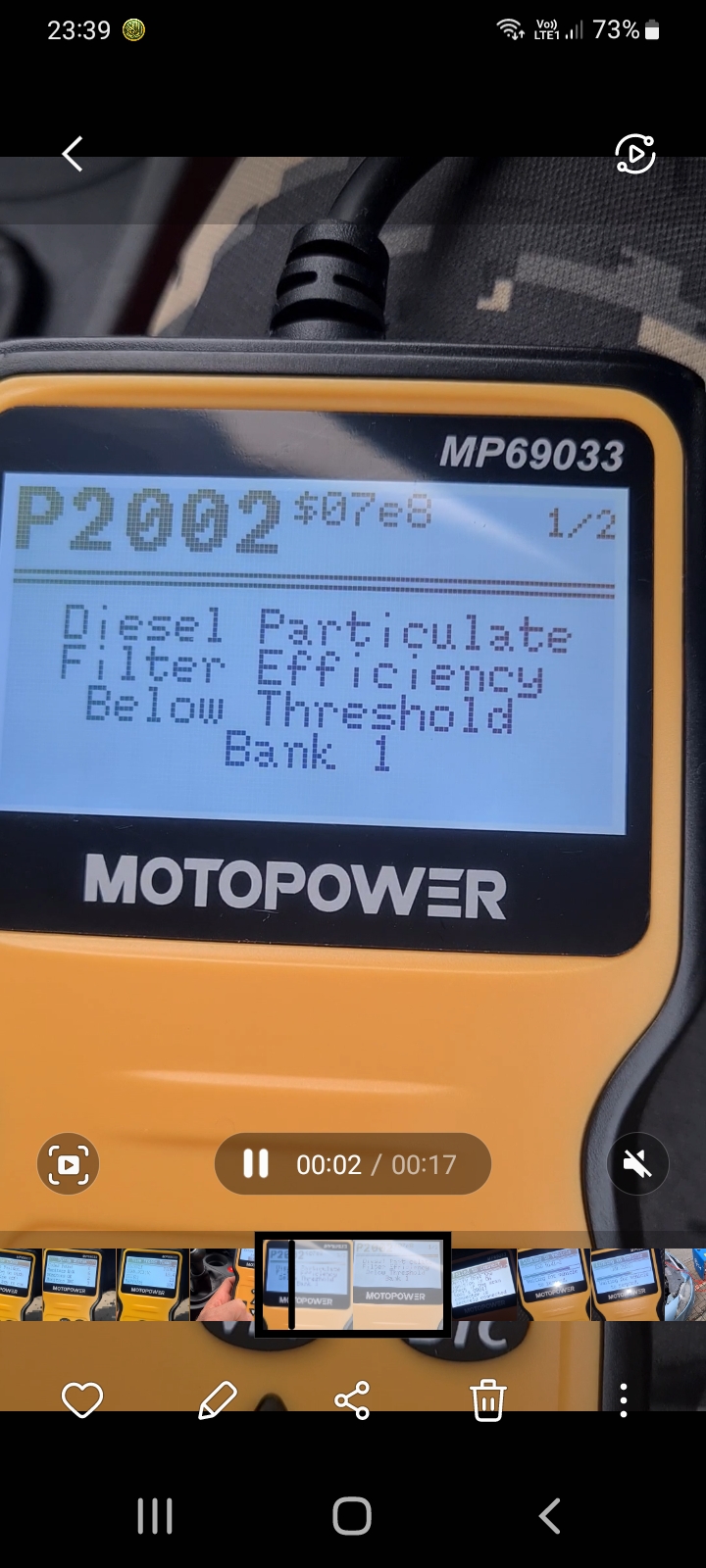

Right got the eml on, glow plug flashing and dpf filter light on a seat leon 1.9tdi 2009 plate. Took it on motorway hoping it would clear but it didn't. Yesterday had a carbon clean done by a Midlands dpf cleaning service , car was hooked up to a machine for 90 minutes. Cost me £180, Bloke said that should do it. Took it on motorway still lights illuminated..any ideas guys before I throw more money on this car.?

This company did no checks before or after the carbon cleaning was done.i was assuming they'd do a diagnostic on it after to turn off any lights but the bloke doing didn't have diagnostic machine. Anyway I borrowed my friend's cheap diagnostic tool , i gotten eml to go off but the dpf light and glow plug light remain on. Weird thing is it took the car to the local garage I go to, they have the proper diagnostic kit. That didn't pick up any error codes at all..even though the dpf and glow plug light was on, he done it twice and still no errors found, infact it put on the eml on..weird?. I then connected my cheaper tool and got the eml to go off. Now I got only the dpf light on and the glow plug light only ..however my diagnostic tool picked up error see pic..its showing 1 of 2 error codes , but the second on is the same as in pic?

Does this help?
The most common repairs for a P2002 are as follows:
  1. Clearing the diesel particulate filter.
  2. Changing the diesel fuel.
  3. Replacing the diesel particulate filter.
  4. Replacing the back pressure sensor.
Andy
A widely overlooked cause for DPF blockage is over-cool running. The DPF will not attempt to regenerate if the engine has failed to reach operating temperature and if it is running too cool the engine will naturally generate more soot in any case. Use a cheap OBD2 diag tool to check the engine is running at 80 degrees plus in normal use.

You need to either buy a cable and copy of vcds or find someone local that has it, it will allow you to measure the dpf level and force a regen if it hasn't gone over a certain percentage.
If you have a laptop it's worth every penny if you own a vag group car

does the car start easily & quickly and remain running from cold but with no power? EGR valve needs replacing/cleaning.
If it's a poor starter then one or more Glow Plugs have failed (the glow plugs come into play when doing a DPF clearing run).
Is the engine a 'common rail' one? If so the High pressure pump is failing or you have a leak after the HP pump.
