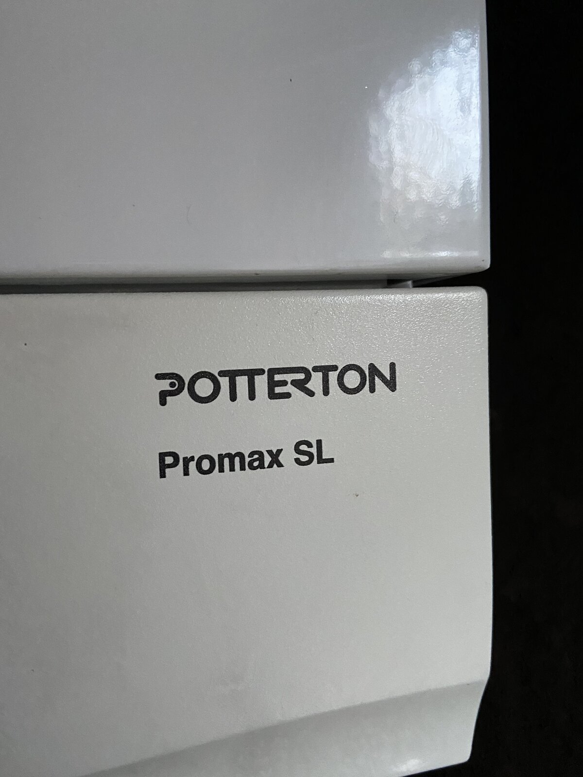

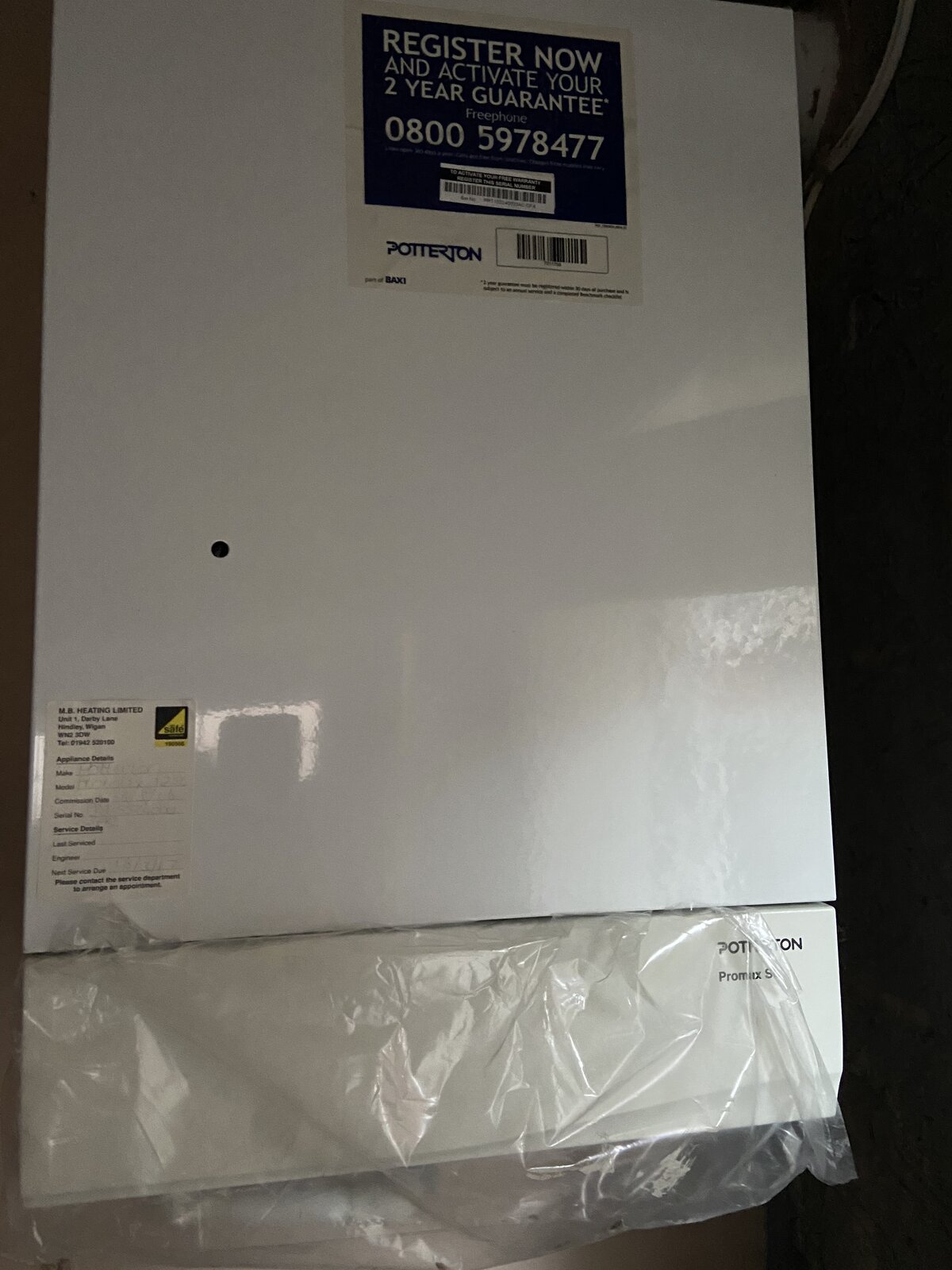

Hi everyone
Just moved into house. i have a potterton promax SL conventional boiler. Less than 5 years old.
There is an unvented hot water cylinder upstairs.
i have the hot water cycliner coming on between 7 and 730am each day.
i went outside in the garage earlier, around 530pm and heard snd saw the boiler firing up. Checked Gas for today and since around 8am had used 0.4 of a unit. The heating has been off allday?
i suspected it was using gas during the day, even though everything is off. Can’t understand why???

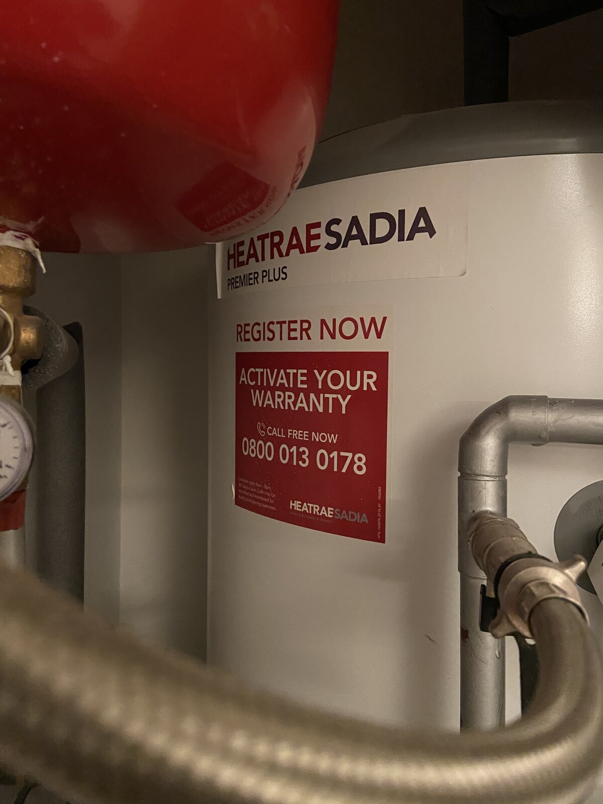

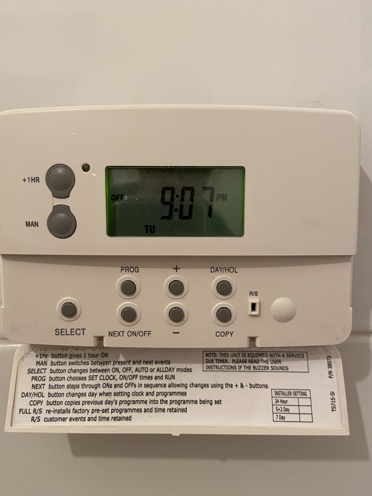

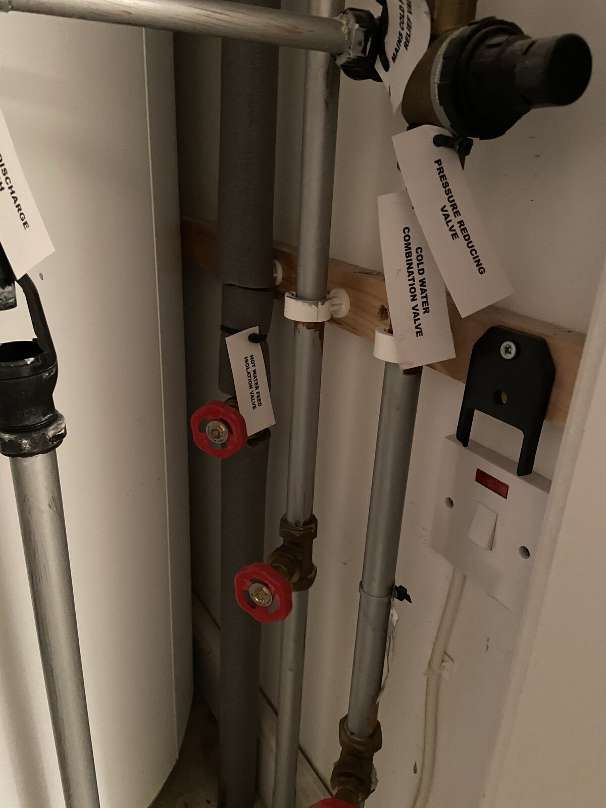

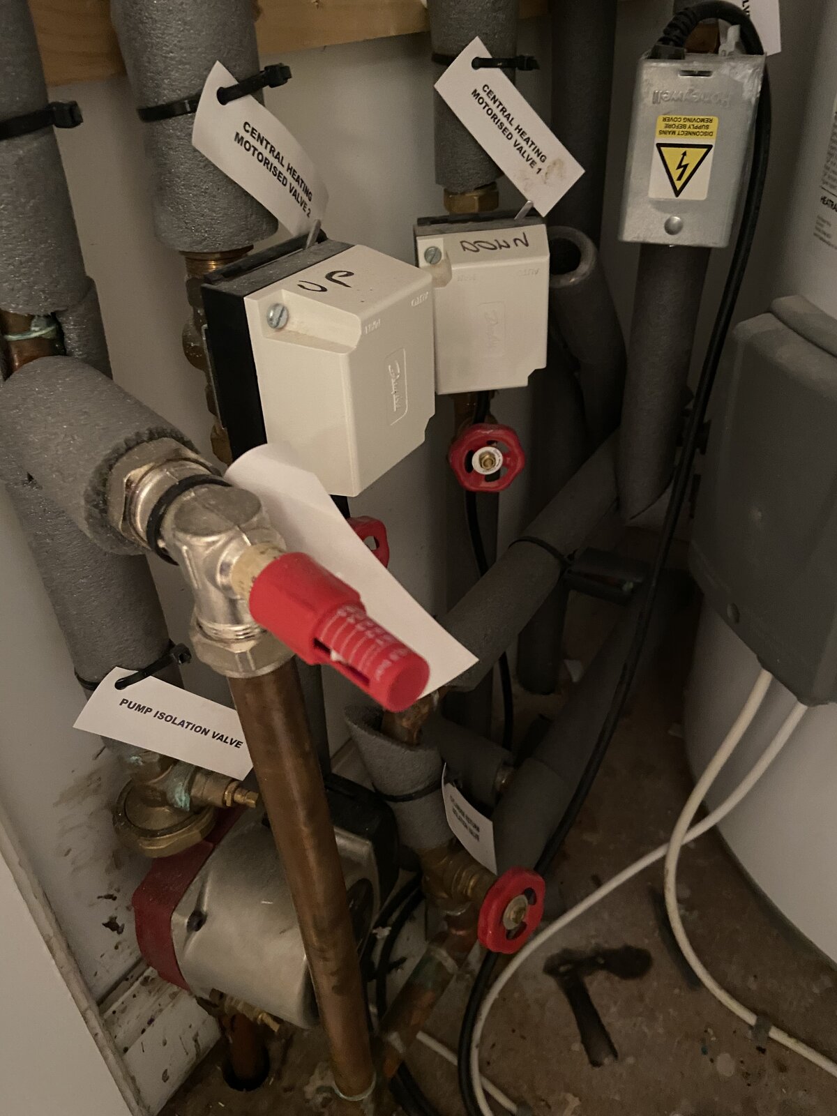

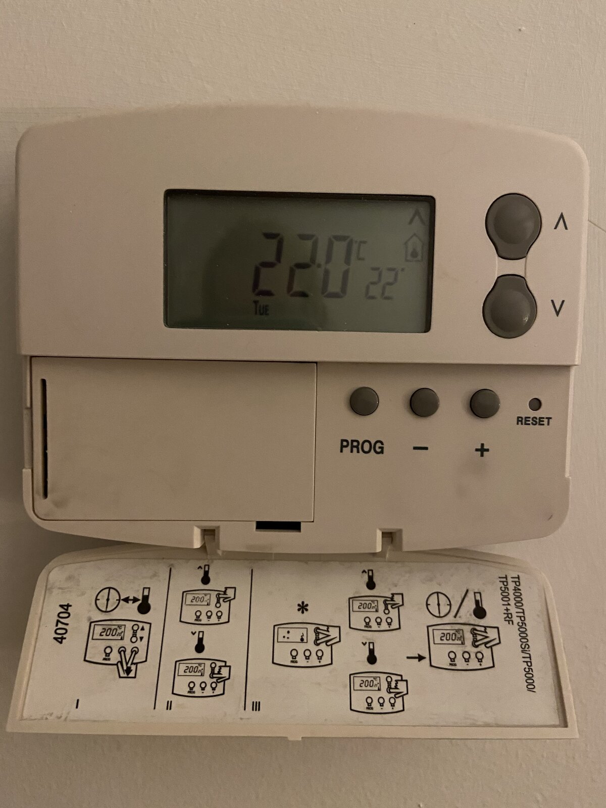

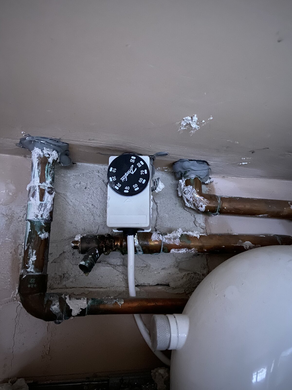

Show us pics of both of these " timers"/ controllers/ programmers or whatever they are together with any motorised valves in or around the hot water cylinder. The boiler is obviously getting a live supply from somewhere.
Here you go. Top programmer is for hot water, bottom one is for heating (its on now, but wasnt earlier) Hot water cylinder top pics
Your DHW programmer is set to OFF, I assume you usually have it set to something else ,what would that be ?
It was set to “Auto” which trigers the programme. I then have 1 which is on at 0700. 2 is off at 0730. 3 is on at 0730, 4 is off at 0730. 5 is on at 0730, 6 is off at 0730. Same for each day.
You appear to have the programmer being used as it should ,so there may be an issue with it. Best to engage an engineer to check it out ,unless you are proficient to do some voltage testing at the wiring centre. Could also be the motorised valve stuck ,if the boiler is coming on and off permanently
Looks like the boiler is in a cold area where it will be subject to cold temps if insulation is not up to scratch, expect the boiler to come on at night and day when outside temp drop off, you have a pipe thermostat that is designed to call for heat when temps drop.
