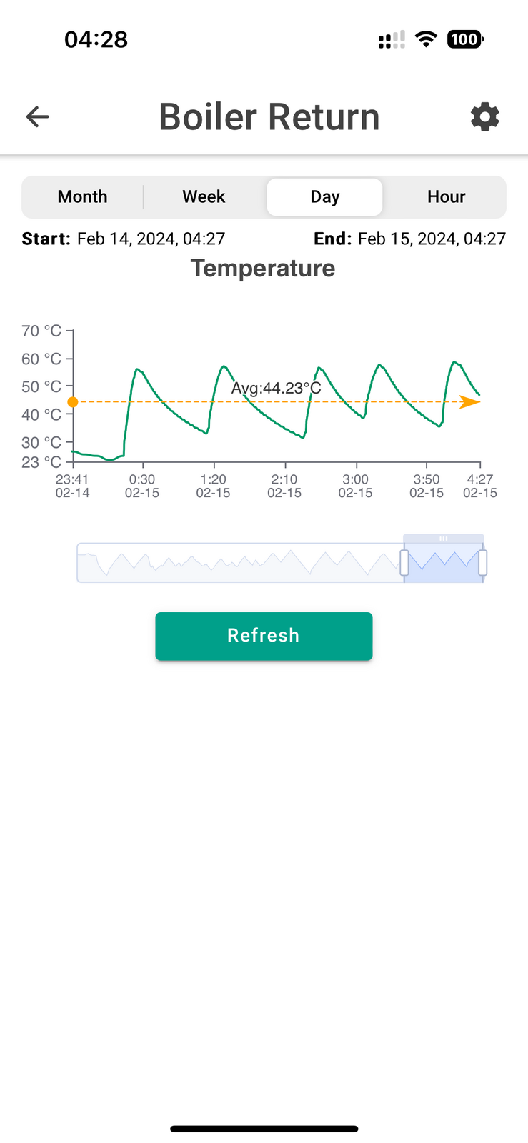

Many thanks for all the previous replies on this. I turned off the secondary pump, which has definitely reduced the boiler firing to top up the tank. However I have become a little more scientific, and am monitoring when the boiler is firing as the attached shows.
I have noticed it’s still firing from cold once every hour to top up the tank, even during the night when there is no usage. I assume this is pretty inefficient from a gas usage POV as I am firing the boiler to 100% to get it to temp, then it’s only running for a few mins before shutting off again, rather than running for longer and modulating down as it does with the UFH.
The tank is a santon pp300b, stat set to 4 (which I think is around 60 degrees), in normal conditions (I.e i don’t have a slow leak of hot water somewhere) should I expect to lose enough heat to cause this every hour?
I will have to do the math, but my gut says putting a timer on this to run in the morning and afternoon for an hour or so will likely end up being more efficient and also stop it raising my return temps when the UFH is on and stopping the boiler condensing as well for periods..?

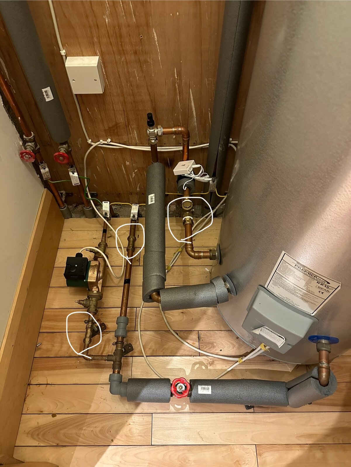

I have tested this today, by turning off the hot water from the tank, since I have done that it hasnt fired at all, which would say to me:
1. There is something leaking a small amount of hot water
2. Even with the pump off, the pressure of the cold into the tank, is pushing hot water around the secondary circulation circuit slowly, leading to the drop in temp
Can I/is it even possible to isolate the secondary circuit?

I think that’s what I have, I actually seem to have 3 non returns, have attached a pic if that is helpful…
I have currently closed the valve after the recirculating pump and turned it off to rule out any issues with that.
