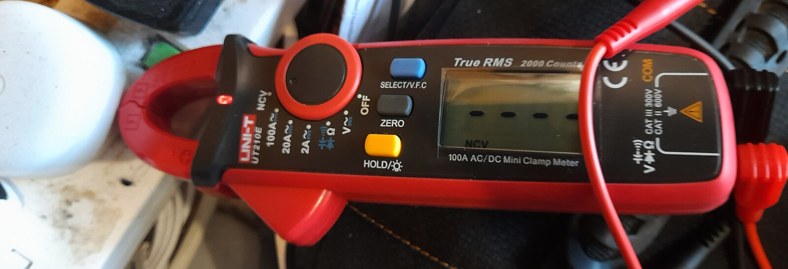

Need to read installation manual not users manual to see output, however in the main gas boilers can modulate, so the amount of gas used varies, I wanted to work out gas use with my mothers house, so I could work out if changes were improving boiler efficiency, but not like electric, with electric I can clip on a meter and read how much used, Testing for live.jpg really easy, shown here testing non contact voltage, but easy to see what is being used, but gas one can't measure so easy, even my oil boiler, I can measure time running which equals the amount of oil used, but that is not true with most gas boilers.
