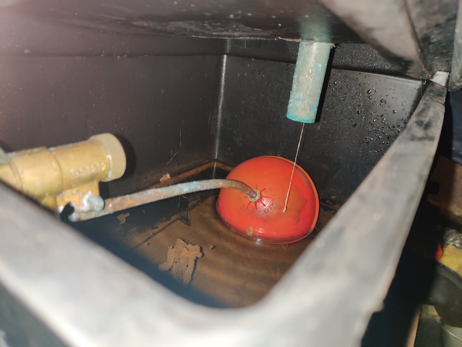

OK - my apologies, I have to admit I have made a mistake by providing a picture of the cold water cistern and not the F&E one. I am attaching an updated picutre where it seems things are far from ideal. Please correct me if I am wrong but this potentially means a blockage which can be cleared out with a power flush? Together with treatment of the F&E tank of course.

Plug the tanks outlet with a bung ,and scoop water out / sponge clean.

Tie up the cock, Syphon out the crap and then using the lowest point you can, drain the system. Once the tank is clean, you can then release the cock and let water flow through for a bit.
Once drained down, clean out the rads as well. Takes 5mins each.
Once all back together, bung in some cleaner (x400, etc,) and let her rip.
You might get the bugger working again.
Ah boo. Yes looking at that it is extremely likely that there's a mountain of rubbish in the heating pipework caused by bodger 1 not cleaning the tank out before draining the system. Not necessarily magnetic rubbish either tho well worth investigating, possible there's a partial magnetite blockage which has been bunged up by the birdnest from the f & e tank.
Job 1 as above re mucking out the tank. Power flush might shift the rubbish (or some of it), might just push it into the boiler if it isn't in there already. Since the bodgers haven't already tried it I'll assume they don't have the kit and expect you to shell out £500 for someone else to do it.

There will be a 15mm pipe exiting from the bottom of the F&E tank, this is the cold feed to the system, trace to where it joins the heating system, see if a magnet attracts at this point, most common place for a blockage when the system is as dirty as that
