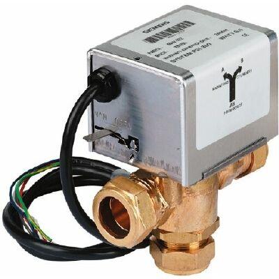

Is the boiler switching under the control of the hot water temperature?
You may have the hot water control switched off, but a fault in a 3-way valve (if fitted) could leave the hot water cylinder thermostat controlling the boiler.

With the 3 way valve you mentioned the picture I have with this message is similar to what I have. (I hope the picture comes out ok? I believe I have followed correctly the picture attachment instructions?).

It could be a fault in the motor valve or the programmer.

3) With the 3 way motor valve: is there a way that I can check whether that is misbehaving?

Also, allow me mention what the 3 way motor valve is doing at this moment: at present the boiler is behaving itself, i.e. it is working correctly - turning on and off - in conjunction with the room/wall thermostat. The room temperature itself has not decreased to the wall/room stat reading since using it last night; with this in mind the pump is cold to the touch, as are all the surrounding pipes, including pipes in and out of the motor valve, but the casing of the motor valve itself is warm to the touch - is this ok? Also the lever on the valve is to the far left, and can be manually easily moved without resistance to the far right, where it remains until I manually return it to the far left again. Again, this is with the heating not being activated or being on for the past 12 hours or so.
