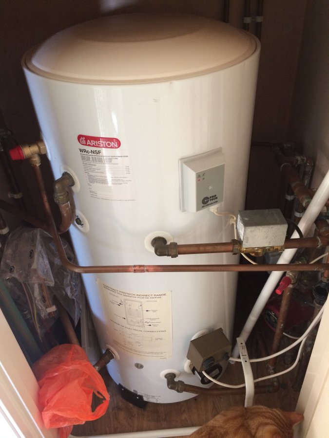

We have a Worcester 14/19 CBi downstairs with a cylinder upstairs. We've suddenly lost our hot water, but the CH still works fine.
Googling around the subject, this immediately sounds like a motorised valve failure. When I adjust one of the room stats upwards, the "demand" light on the boiler comes on and it fires up, and then shuts off when the temp is reached. However, there's never a response from the boiler when I run a hot tap. Should the "demand" light come on then as well?
If it's a valve failure, is there any way to identify which one, and then manually force it to provide hot water rather than CH?
There are three motorised valves in the upstairs cupboard along with the cylinder - a Honeywell 272848 on the horizontal input pipe from the boiler to the cylinder, and two Drayton ZA5's on vertical pipes running up the wall to the side of the cylinder. They all seem to be two-zone valves with just A and B, no midpoint positions, and they're all on A.
Any chance of pic of the cupboard showing the general layout of pipes, valves and cylinder?

Thanks for the replies so far - here's a pic I happen to have on my phone. I can take more detailed ones when I get home if necessary.
You can see the Honeywell valve on top of the horizontal pipe that connects to the front centre of the cylinder. According to the diagram in the front of the cylinder, this is the input from the boiler.
The two ZA5's are attached at floor level to the two pipes you can just see branching vertically downwards off the short horizontal pipe on the the wall on the centre right of the picture.
So theoretically, I can move and latch the lever on the Honeywell, and that should cause the boiler to fire up (assuming the time switch is on)?

This is an unvented cylinder which requires a G3 ticket in order to carry out any work on it.
Thanks for the pic; without it I wouldn't have known you have an unvented cylinder.

No! That only happens on combi (instant hot water) boilers; you have an unvented indirect cylinder. The water in the cylinder will only be reheated when it reaches the temperature set on the cylinder's thermostat. There is normally a 10C difference between on and off, so the water will heat up to 60C, but not reheat until the temperature drops to 50C. You set the times when you want the water to be reheated on the programmer.
The valve on the horizontal pipe may be faulty, or it could be the safety cut out in the box attached to the cylinder. You really need an engineer who is qualified to work on unvented cylinders (G3 qualification) to diagnose and rectify the problem.
