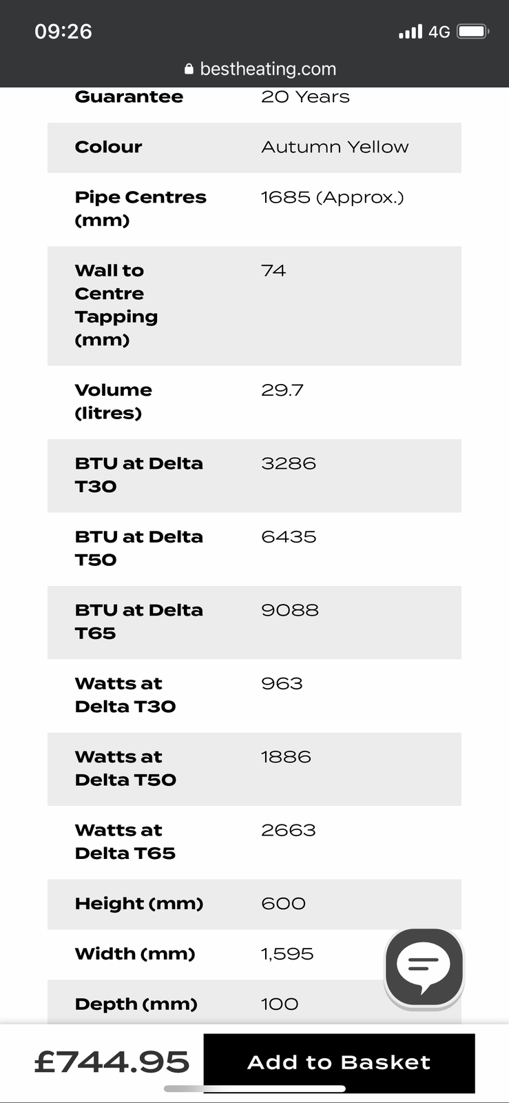

as part of the renovation work on the ground floor, about 6 rads have been took off the walls (4 X double panel, double connector, 2 X double panel single connector)
Rather than put them back on - we were looking at some more modern triple column ones. It’s a range called the Milano Windsor, on the website it shows the BTU and wattage for t30, t50 and t60… just not sure which I should be going off of.
Basically I’m looking to potentially put more than rads back on compared to what came off, just conscious of adding too many and overloading the boiler.
Rads I’m looking at - https://www.bestheating.com/milano-...mn-choice-of-classic-colours-and-sizes-113686

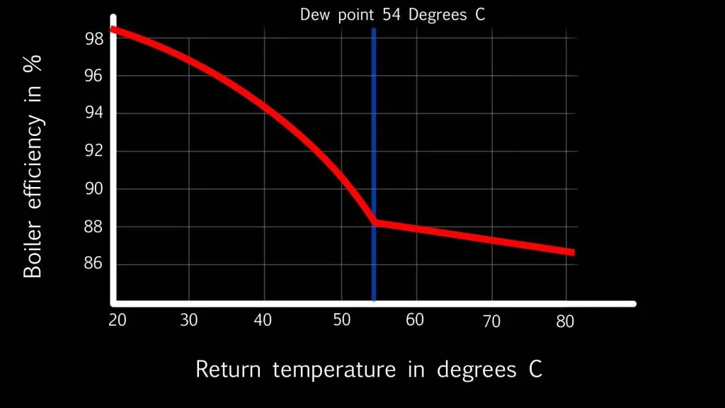

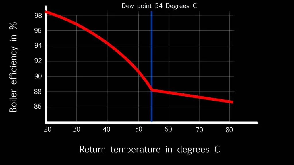

The highest boiler efficiency is achieved with the lowest (boiler) radiator return temperature. Your boiler will achive ~ 90% efficiency with a return temperature of 50C, 87% at a return of 65C and 95% at a return of 40C.
Rads are based on a 50C basis but this is the mean rad temperature minus the required room temperature (roomtemp of 20c is usually used)
So a 50deg rad will require a flowtemp of 75C and a return of 65C to give its full output (50deg rad), (75+65)/2) minus 20 = 50C with a boiler efficiency of ~ 87%. If you oversized the rad by a factor of ~ 1.9 (30deg rad) then you will get the same rad output at flowtemp of 60C and a returntemp of 40C, (60+40)/2) minus 20 = 30C with a boiler efficiency of 95%.

You might be a small bit confused.
