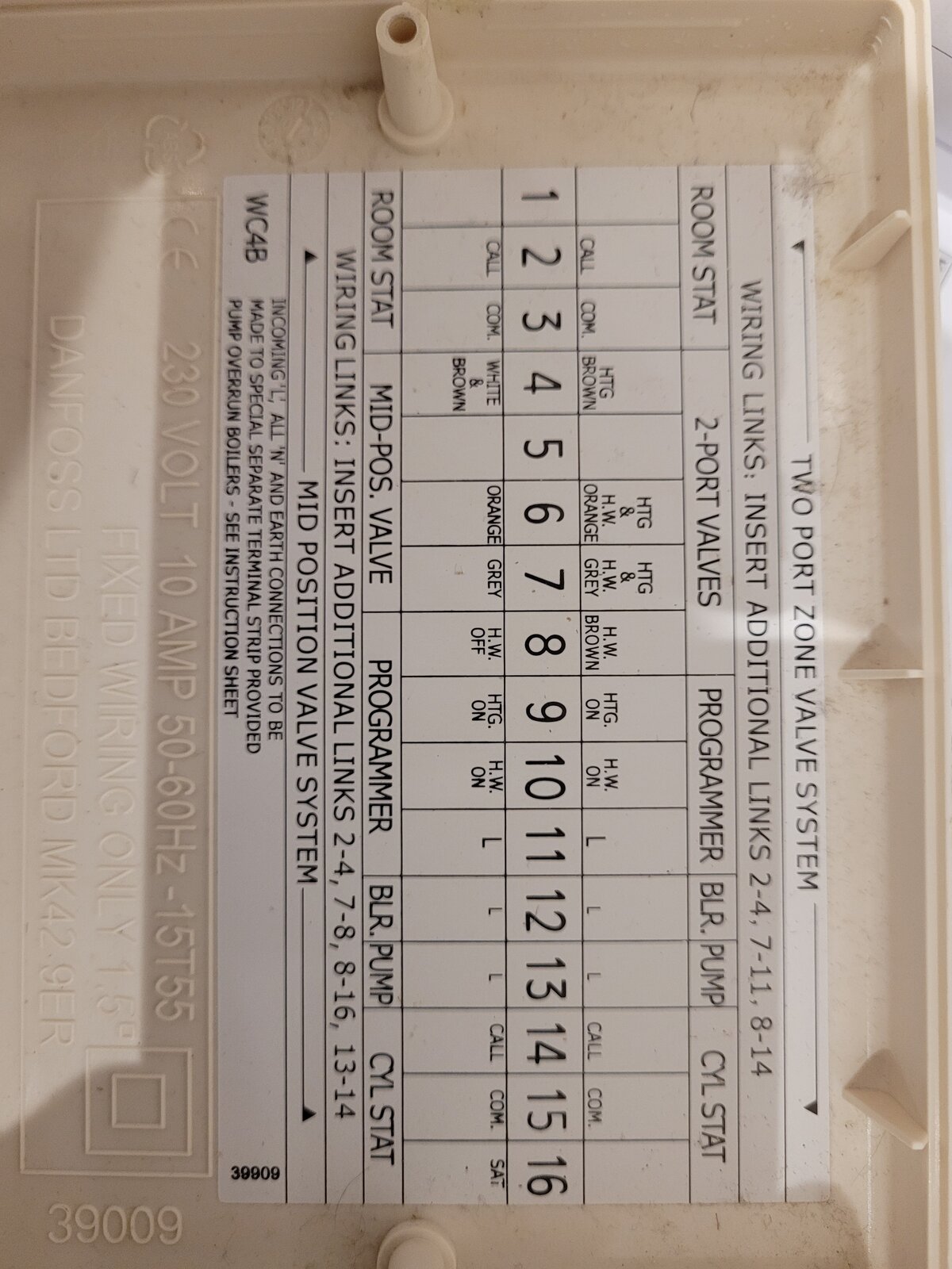

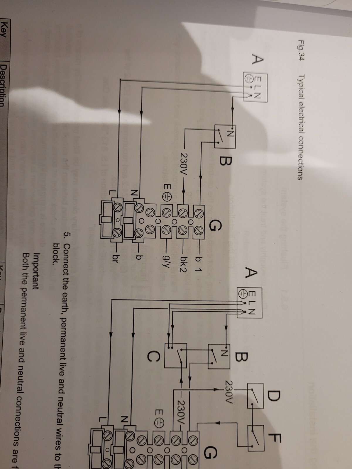

I need a bit of wiring help as it's not my strong point and usually get a spark to do it. I'm wiring up my baxi 824 system to danfos wiring centre on cylinder hot water and heating zone valves are pre wired just wondering where B1 and BK2 go in on wiring centre. Cheers.
BK2 to 3 (Com)
B 1 to 2 (Call)
I haven't got a roomstat wired in I'm gonna fit a hive will this still work if I go to 3 and 2?
Yes it should do as it’ll have links to the zone valves (hopefully if you’ve done it right).
They're not linked as wiring centre was prewired zone valves and cylinder stat already wired in
