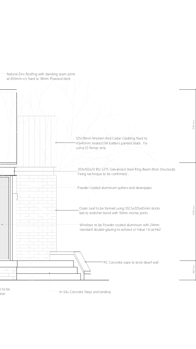

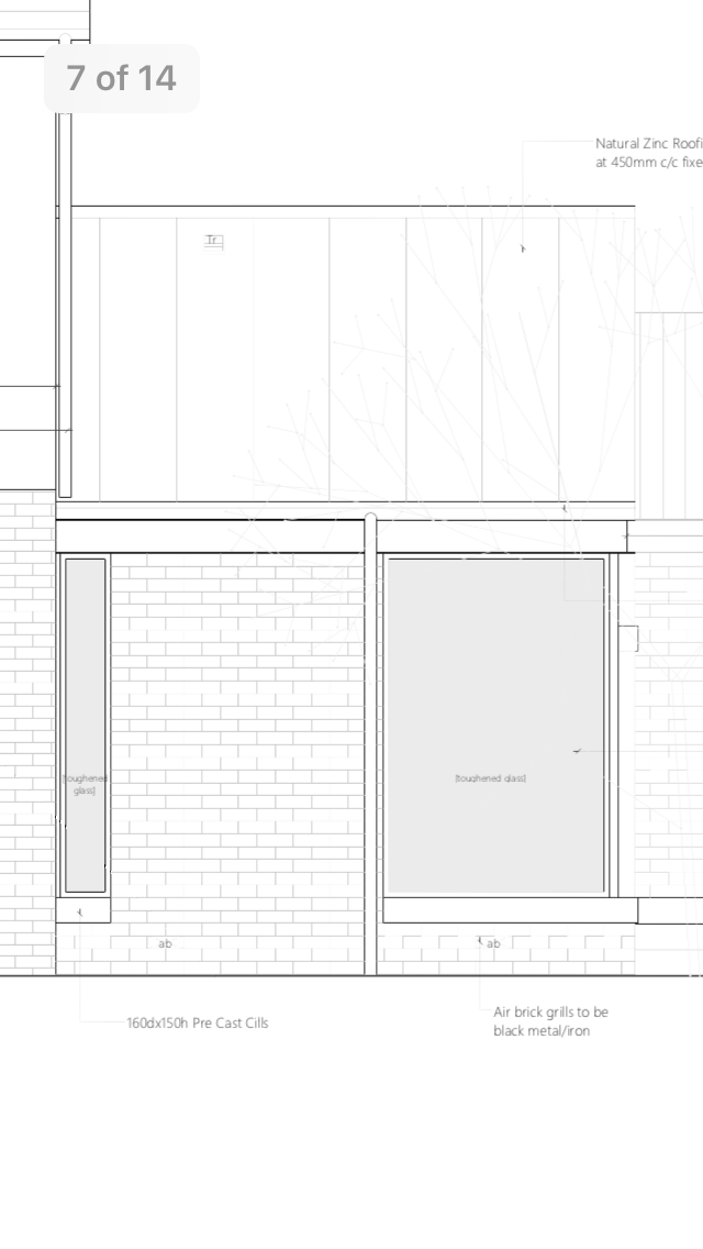

Hello guys looking for some advice on fixing a steel ring beam to the top course of brick.
Does anyone know what kind of bolts to use and which torque to tighten them to? Don't have anything on the engineers drawings.
It's a purely aesthetic ring beam non structural so just needing something to get a fixing into the brick
I know it's a pretty vague question waiting on woody jumping in two feet allready
I've attached the drawings might be of some help

It looks to be a poor design if you are fixing steel beams to the top of a wall?
Not disputing that tony.
It's also to be fixed to the roof trusses apparently :confused:
Can you reccomend a bolt that would do the job?
It says fixing technique to be confirmed. Is an engineer supposed to be confirming that :?:
or more likely the roof trusses fixed to a timber wall plate sitting on top of the ring beam and tied down with holding down straps to the wall :?: Can't really tell from the drawings, your designer needs to provide more details.

What I have is this beam which I have been asked to fix to the top of the brick by the building company I'm subbying for just now.
It's got 10mm holes drilled every 1000mm. Just wondering what kind of bolt would do the job without bursting the brick.
They are a clay brick with a frog so hopefully should drill ok.

Resin fixings don't expand to risk bursting the brick but the thing is what do you achieve by fixing to a top course of bricks :?::!:

If you are drilling at or near the top course of brickwork, it's likely that the bricks will come loose. And even if they stayed firm,
expanding bolts are likely to split the bricks because there's no weight above. Use resin-fixed threaded bar if you must.
But that apart, it seems an odd aesthetic to be fixing a steel beam up there.
