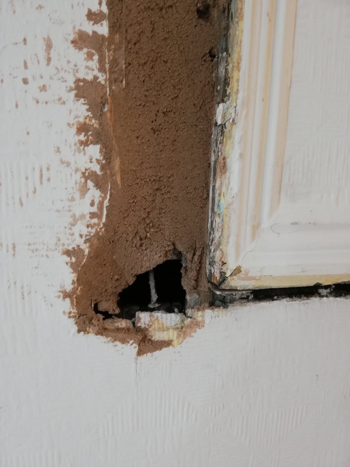

Hi all. I've moved a light switch and done the bonding coat along the channel after sinking in the twin and earth etc.
I have a end part which is around 80 by 50mm which is just a void with nothing such as lathes for the bonding coat to adhere too.
Does anyone know if I can fill it with expanding foam and then bonding coat on top?
With being a ceiling it won't take any traffic like a lower wall or floor is what I'm thinking.
Any alternative ideas would also be appreciated. Thanks in advance
Use expanding foam to adhere a small square of plasterboard in there; the foam will bond well to the board and the board would be better to bond bonding coat to than cured foam
Cheers. Anything else I can use instead of plasterboard. Its not cost but I hate waste and buying a full plasterboard for just a 50 x 80mm shape I'd be throwing over 90% of it away is all.
Any skip you pass? Bit of wood, tile, etc..
