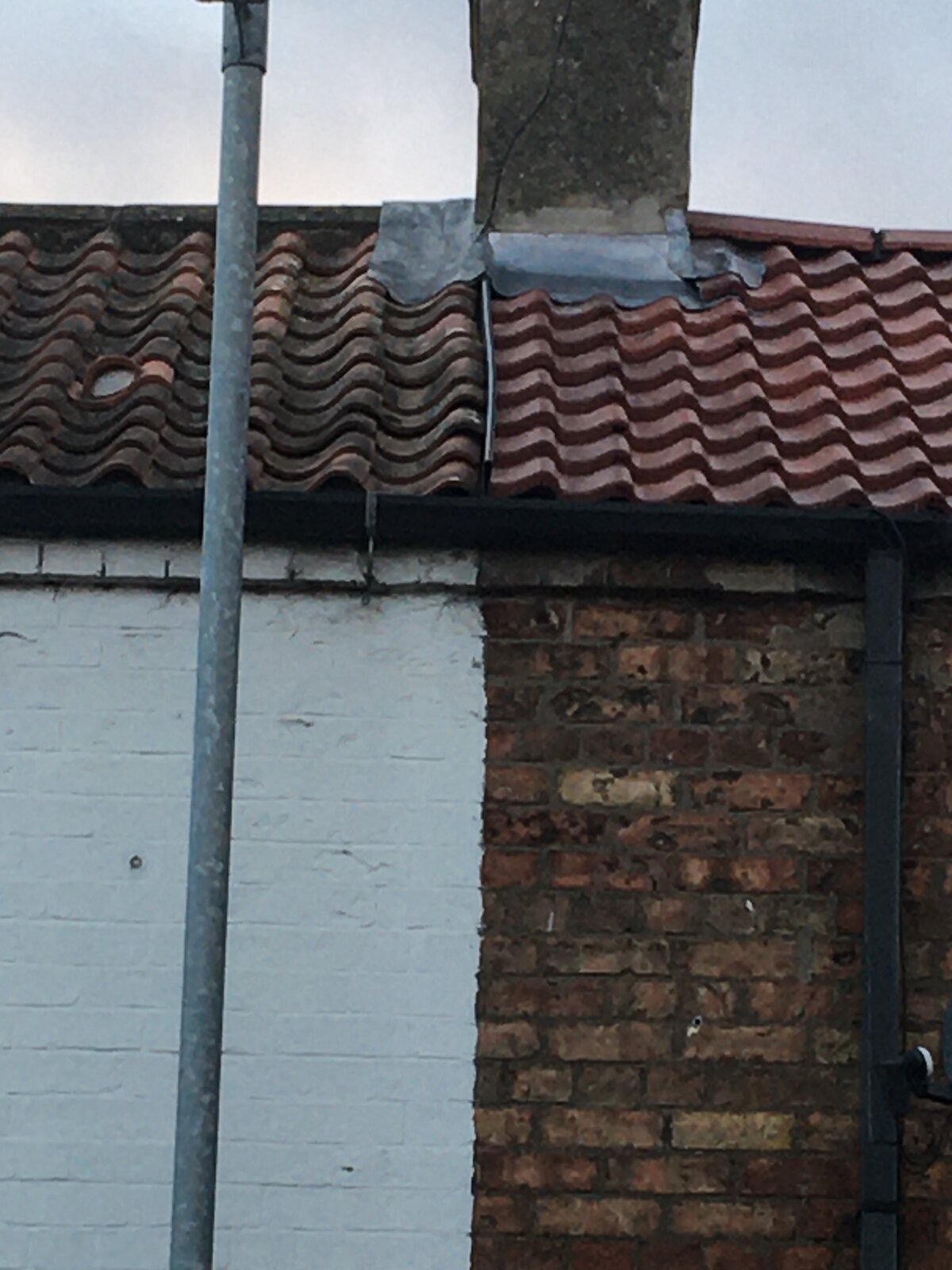

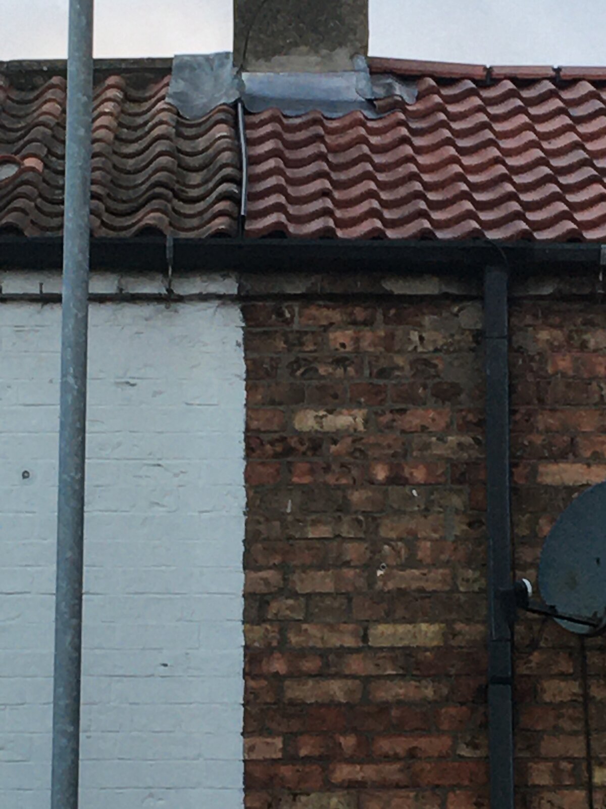

Hi Firstly im no roofer but this week our neighbours have had a new roof fitted and the roofers unknowingly to us have fitted a bonding gutter, they have been on our roof removed some tiles to fit felting and the bonding gutter. Legally how do we stand we had no idea about this it was just when we saw the job on the roof looks awful on old cottages tbh. The guttering is not straight and looks like a few of our tiles are not sitting correctly now! The obviously replaced the neighbouring copping stone and they aren’t even straight! Took the a day and a half to do both sides which amazed me. Thanks for looking/helping.

They’ve used a different tile profile.
I don’t know if the same ones are still available - that would’ve been better.
anyway the chimney flashing and cr@p ridge tile show it’s a cowboy job not done by professional roofers.
Don’t be surprised if the roof leaks at the bonding gutter or around the chimney
Yes different tiles they match the cottage at the other side! I totally agree with your comments I have asked them to come back (through my neighbour) and put right but we’ll see. I’m sure if it was done correctly it wouldn’t be such an eye sore!
The bonding gutter seems to stop a tile before the gutter - I’m not sure that’s correct.
Its a very bad job:
1. it will leak - the bonding gutter should extend 40mm over the fascia gutter.
2. by reason of not being located central over the party wall it will cause PWA issues for you on any mortgage survey.
3. there could be fire reg issues above the party wall.
4. incorrect lead flashing
5. cocked up tiles.
6. there must be four bonding gutters, back and front, on your roof. A day & a half?
7. if its that bad on top whats it like below the tiles?
8. Experience & very careful detailing is needed for bonding gutters.
If they return then you will need your experienced roofer observing what & how they go about the job.

There is a saddle - over the ridge tile. Looks like it's been dropped from a great height. Tell says they should all go over the ridge tile.

So how come the wall is painted (o.P's wall ? ) up to the line of l/h side of the chimney.? giving the impression that the party wall is not central to the chimney ? who can tell ?
Fairs fair, however "The angle at the bottom of the roof can change as stated previously" but it has not changed in the pics.
