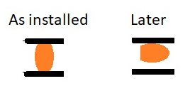

My preference is to use boot lace ferrules.
One concern.....When a flat crimped, oblong shaped ferrule is put into a terminal it should be fitted with the terminal pressing on the flat sides of the crimp. Otherwise the crimp may rotate in the terminal and become loose some time later.
Proper crimper is either flat sides or close to round shape.

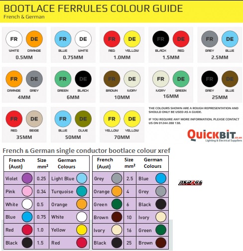

Bear in mind there are 2 different colour codes for the Insulated Bootlace Ferrules, German and French I believe, not sure what the preferred code is for UK
  • Thanks
Reactions: CBW
It seems to be a bit of a mish mash but I've had to stock both for a long time as I worked for so many different companies who seem to have their own combinations, I've also found that many use a bigger double ferrule as they don't use proper strippers and struggle to get 2 wires into the correct size.

I use:
White = 0.5mm
Blue = 0.75mm
Red = 1.0mm
Black = 1.5mm
Grey = 2.5mm
Orange = 4mm
And a pair of crimpers like:
Although not those, the blue handled ones I have probably cost about £13 but do the same job.
But the above are just what my employer "got in" rather than any specific standard I think. (EDIT: pipped atthe post - it seems we are using the French colours - why do we not have our own?)
