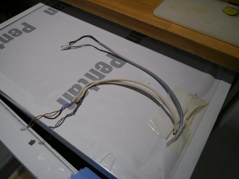

can you post a pic of the sensor, and where its wires go?

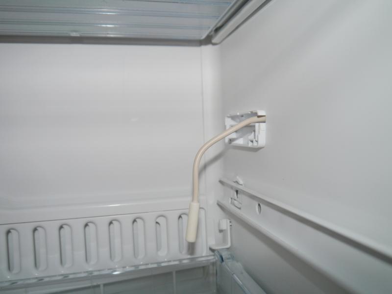

I too have looked at the exploded diagram but can't see the sensor which is located at the rear right of the interior:
Looks like the wires come out of the top and into the junction box next to the compressor. I'm not sure how to replace it if it is faulty as it seems firmly held.
Hope the photos work; never done this before!
The temp light does stop flashing but the compressor keeps running. Wondering if the relay might be faulty?
I'd suppose that it would be a thermocouple (resistance changes with temperature) rather than a click on/off thermostat, so the circuit board can compare actual temperature to setting. In which case you can't easily substitute or test the sensor.
I believe the light stops flashing when it reaches target temperature, in which case (part, at least, of) the control circuit is working.
