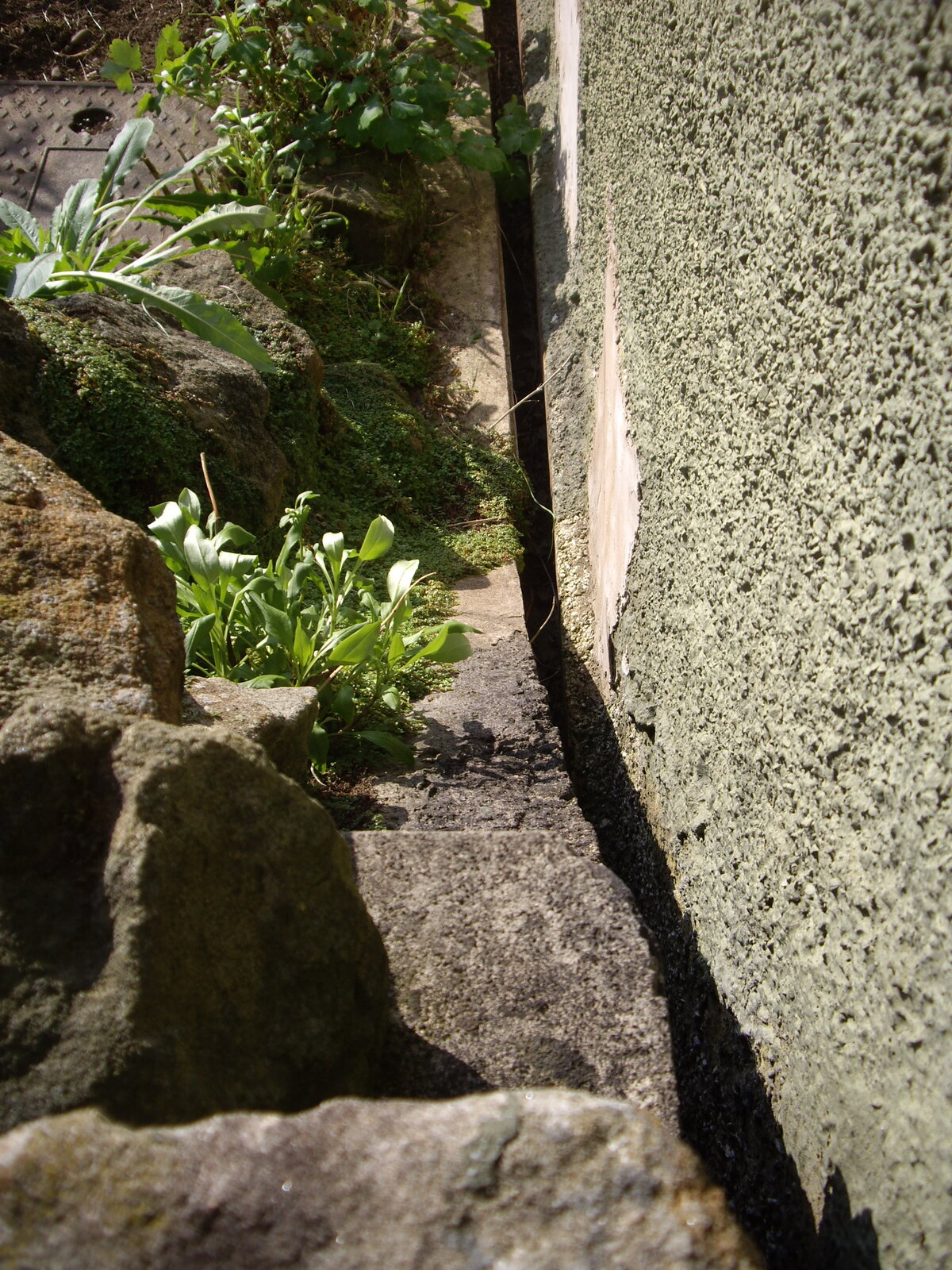

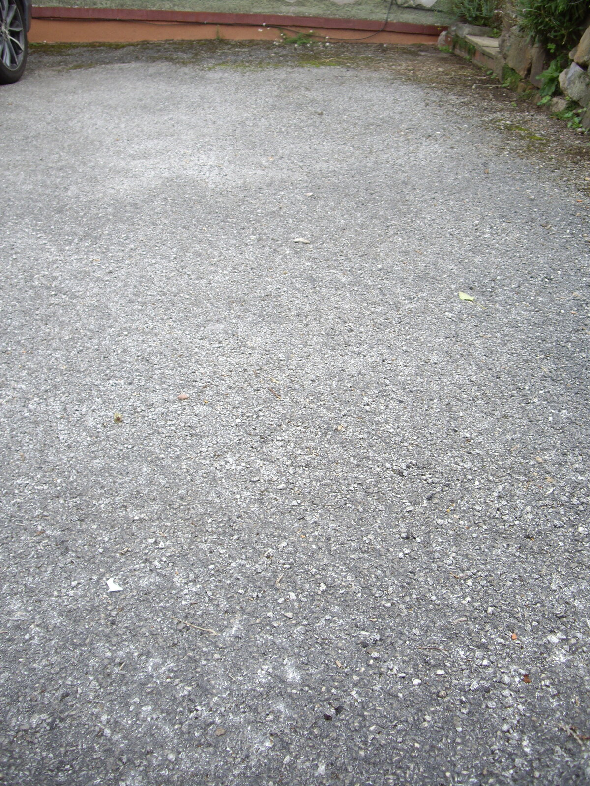

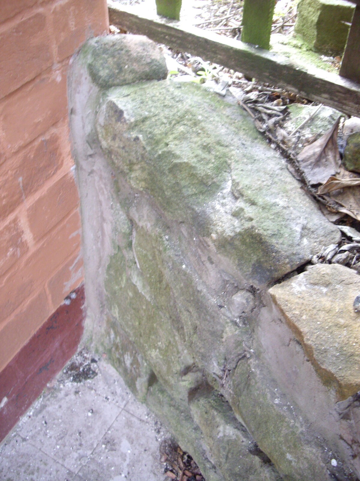

I've been pondering this for a while and i thought to ask the forum whether my neighbours driveway has been built up against the gable end of our house legally?
It wasn't done by the current neighbours but the one before, who insisted on digging out the garden there and laying a tarmac drive right up to the wall.
That was over 30 years ago.
Over he years i've noticed damp spread across our living room wall, and i had to build up our dividing wall outside to prevent water running down their drive to pool beside our wall, where an airbrick became clogged with leaves and standing water.
I was in conversation with a tradie yesterday who mentioned they may have to make good the damage caused by the drive which shouldn't have been laid there at all.
Do i have a case? And what, if anything, can i do about it?
Pictues enclosed to give an idea of the situation.

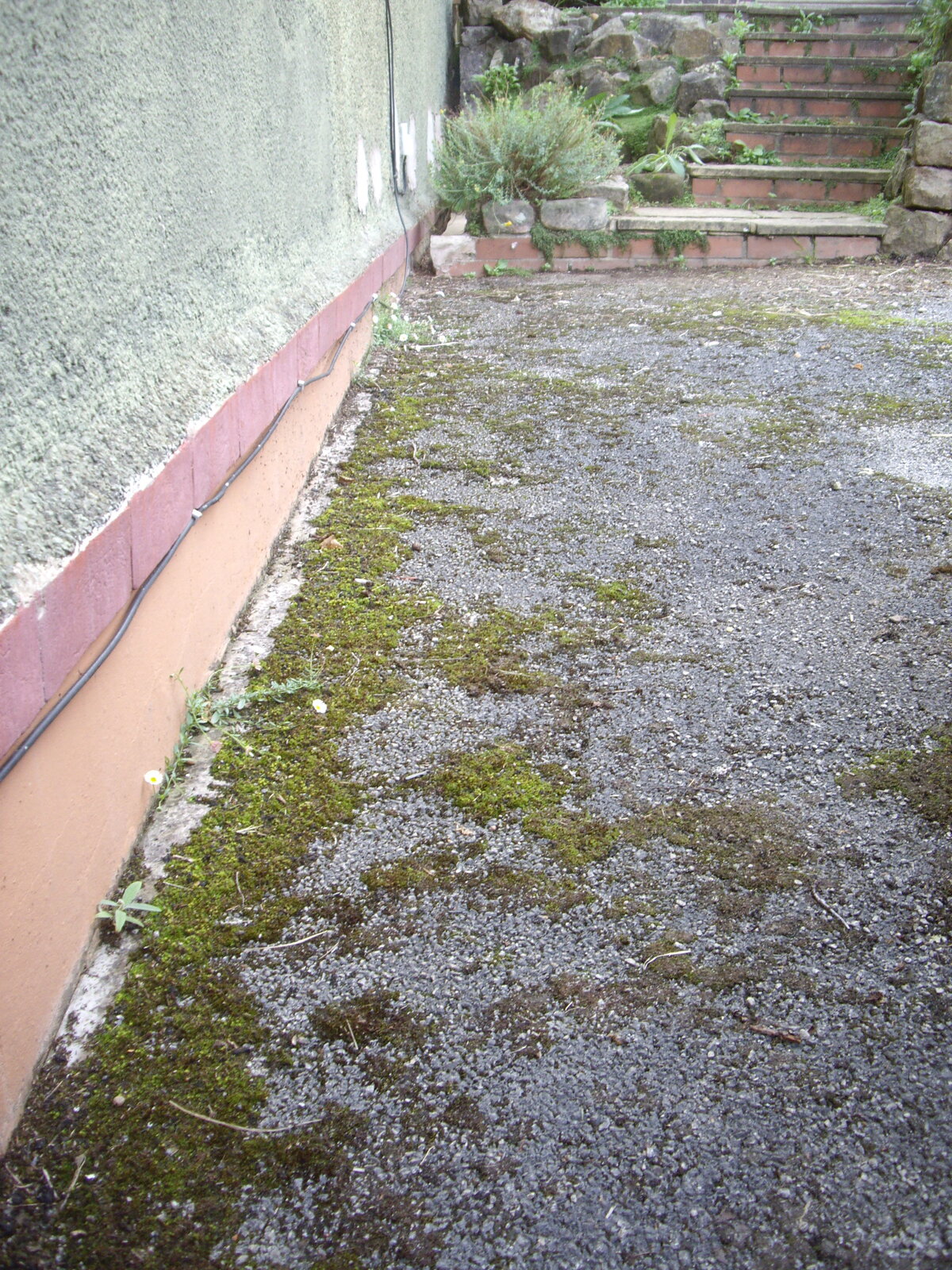

The line of moss is roughly where a gap runs right along the wall and is considered the boundary line on our deeds.
The second shows how far up the wall their drive is built.
The third shows the drop down to our level from their side and the last pic shows how far that drop is to a better extent, where the wall was built up and how much of our house has been covered by their driveway.
You need to determine where your DPC is. You may be able to see it at the front or the rear and follow where it ought to be, along that side. The tarmac should be below that level and there should be no means for water to build up close to it.
If what a neighbour has done, is detrimentally affecting your property, then have a right to redress.

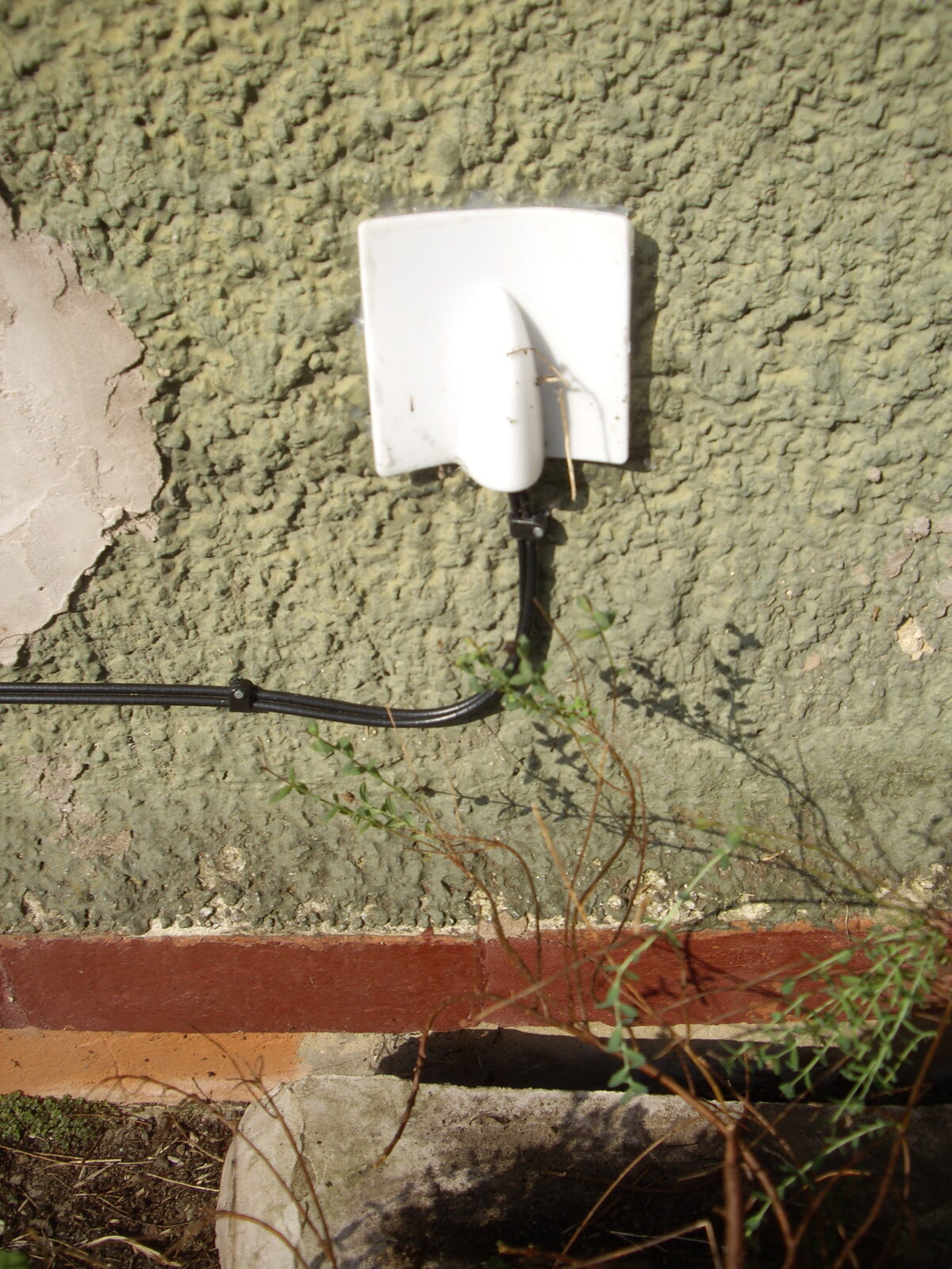

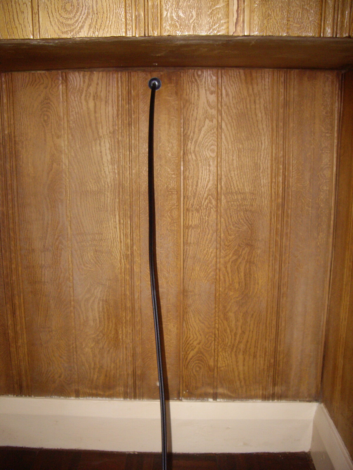

The level of our airbrick is about a meter below their driveway - Two years ago i had the cable guy put a new line to our tv through the old fireplace. Initially he tried to drill the hole for cable an inch above the skirting board but all he hit was clay.
The outlet had to be drilled at the top of the fireplace allowing the cable to run from the dish to a point about a meter above their drive. I estimate their driveway is about half a meter to a meter above the base line of brick around the house.
The deeds show our boundary line runs right along the gable end - if you look at the first pic you can see a bush growing beside a concrete border that runs up as a support for their steps and bit of garden. That concrete line had broken so i replaced it, digging back the soil from the side of the house, laying plastic liner, then a layer of cement on top. Crude, but i hope effective. It leaves a channel of about 3 or four inches between our wall and their garden, but doesn't run straight.
The depth of that channel is about 6 inches and appears to be holding firm, for now.
That area of driveway used to be a garden and was much lower, but the previous neighbour just persisted with a plan that took no consideration of our house or garden. We do not share it, but my neighbour allows me access for maintenance.

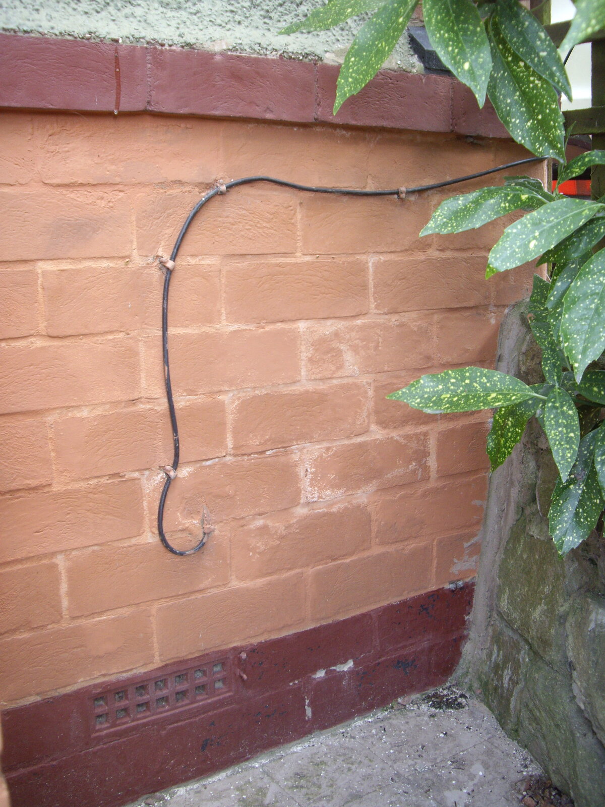

In the fourth picture the level our house sits on has a row of ceramic tiles up to the wall: no idea why. But that suggests to me the original level is just below the airbrick i see there - when i get chance i'll take a pic of that wall to show better what i mean.
The hole drilled through the back of our fireplace is just at the top of their driveway; just below the first step up to the front door. If you loook closely at the first pic you can just see a black line of cable running down the wall. Look where it ends and that corresponds with the top of our fireplace in the living room. A closer pic will make that clearer and again, i'll do that when i have time. I'm up to my wrists in cleaning the walls down inside. The amount of dirt coming off would make Mrs Mopp very angry, indeed.

The first shows the interior of the fireplace where the cable runs in and from that point to the floor is 96cm. (The top of the fireplace to the floor is 98cm.)
The second shows the exterior where the cable emerges and the distance between that point and the drive is 46cm: so it is 50cm beneath the level of the drive.

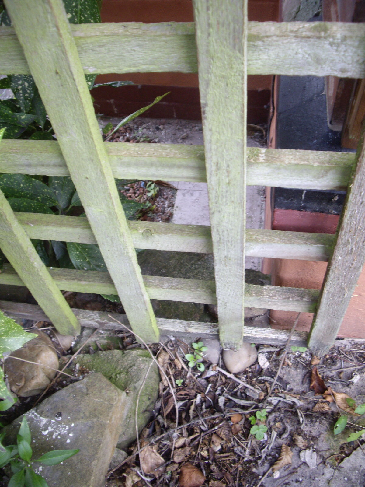

The third shows how high their steps rise to the level of their house, looking down into the gap between the concrete wall and our house, which is about 7/8cm wide and the same deep.
The fourth shows the level of the front of the house where the tiles meet the wall and the drop there is 60cm.

If photo 1 is at the other side of photo2 (that cable is the same cable) and further assuming they have a similar perspective, then it certainly looks like the drive has been installed way above the DPC level. Your measurements seem to also confirm it too. The fact is, the neighbour should never had been allowed to get away with it in the first place - either the steps or the drive level.
The way forward now, is to find a surveyor who has some expertise in land levels and DPC, have them look at the problem and write a letter explaining what needs to be done to resolve it. No you should absolutely not treat it as an 'intellectual excercise'. On the face of it - your neighbours actions 30+ years ago have been damaging your property for all of that time. The fact that they have got away with it for 30+ years and ownership has changed - makes absolutely no difference. The problem is devaluing your mother's property and certainly needs to be resolved.
Armed with the letter, you then need to discuss it with the present neighbour - unfortunate for that neighbour, by that neighbour will be responsible for all of the costs involved in rectifying all of the the steps and the drive level issues.
