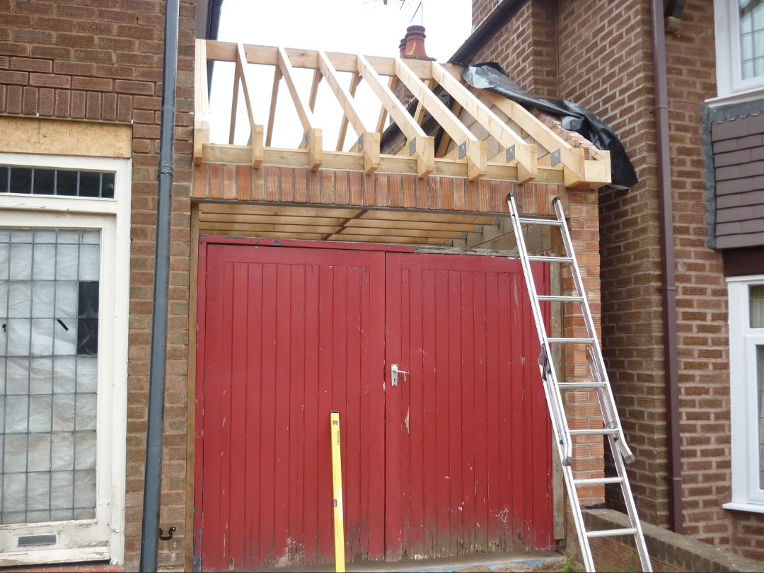

Hi all,
Ive got a front elevated pitched roof on q garage similar to attached pic.
The actual garage front roof can only drain rainwater to the front..the back extension roof is too high to drain towards the garden side.
So drainage has to come through the front pitch and then through soffit board and connection to rainwater soak away from there.
Im planning on doing a box gutter at the front. Ive found parapet wall gutter outlets..but been searching everywhere for a product i could use where it needs to go through the pitch at an angle but havent been able to find anything.
Any pointers please?

If you want to drain both pitches to one side only then one side of the roof
will need to be higher than the other.

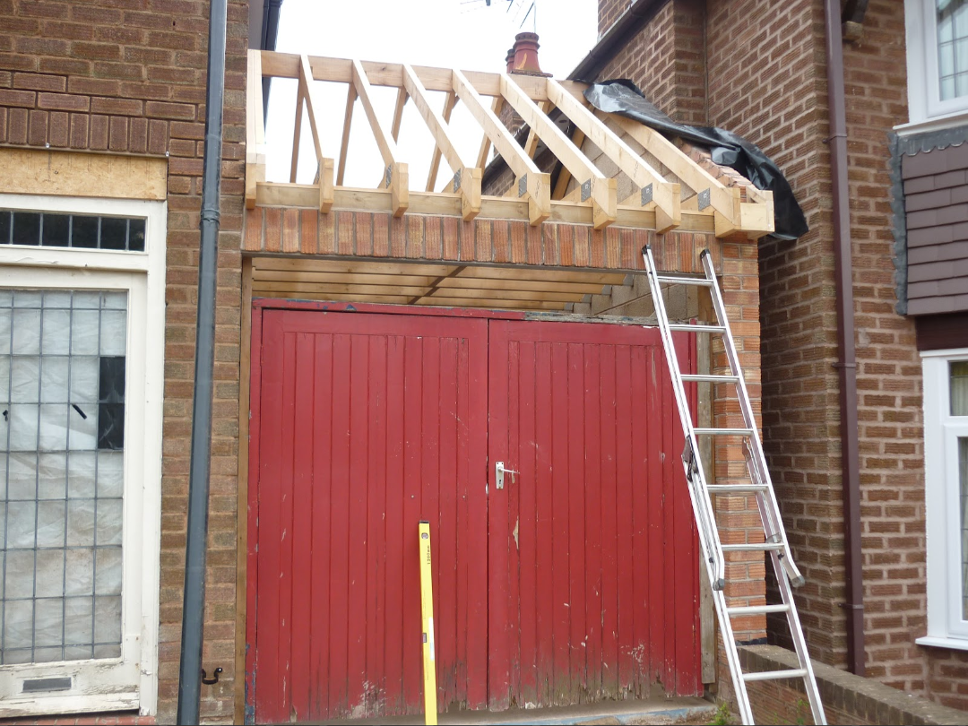

Sorry this isnt the pic of actual roof..just posted to show how the front pitch is.
I have attached a pic of actual roof and what it looks like from the rear.
So i want to drain through the pitch/where rafters are to the front.
You need a leadworker to make a chute to go through and discharge over the tiles.
