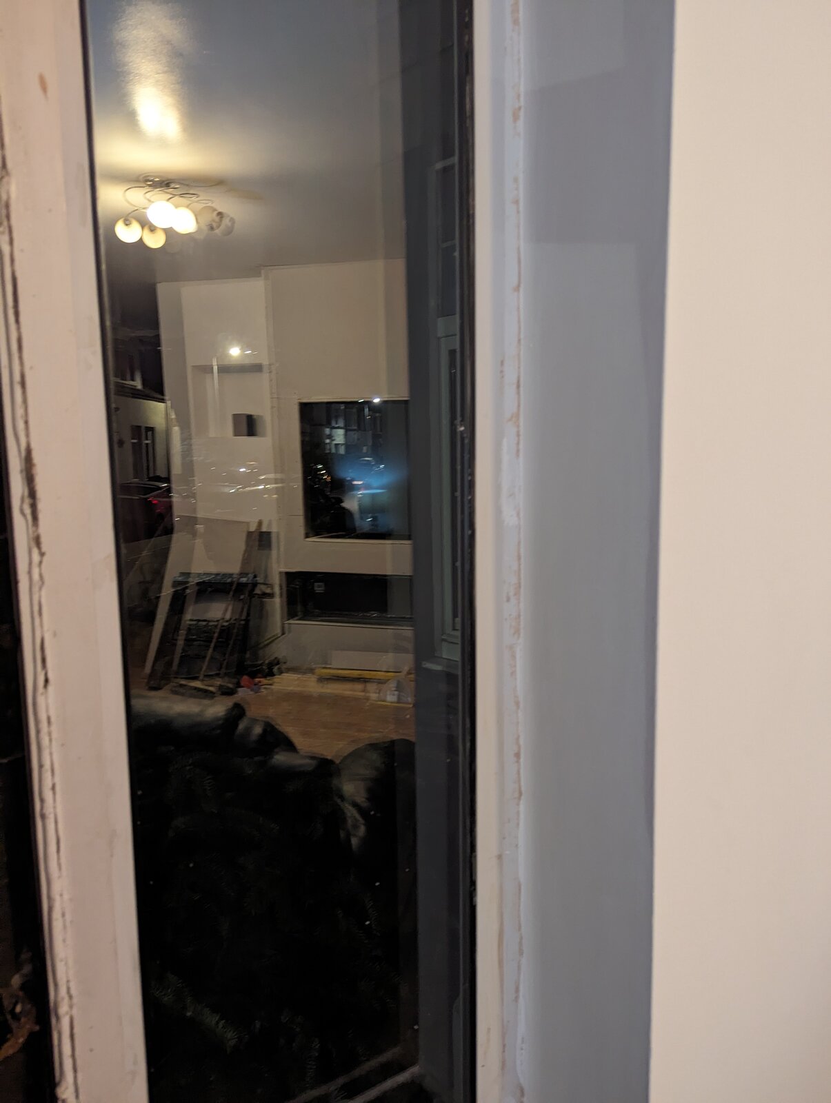

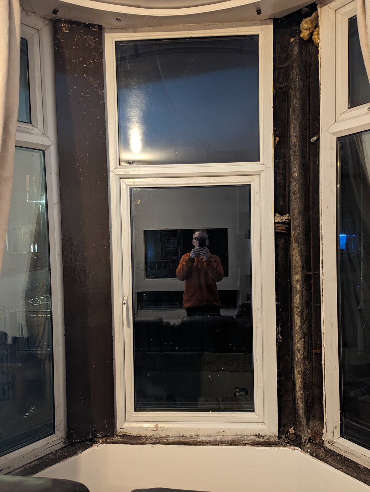

I am renovating my house and need some suggestion for the best way to case it my bay windows, currently it looks a mess.
Any advise would be most appreciated, I am looking for the best possible finish.
Here is how it currently looks:

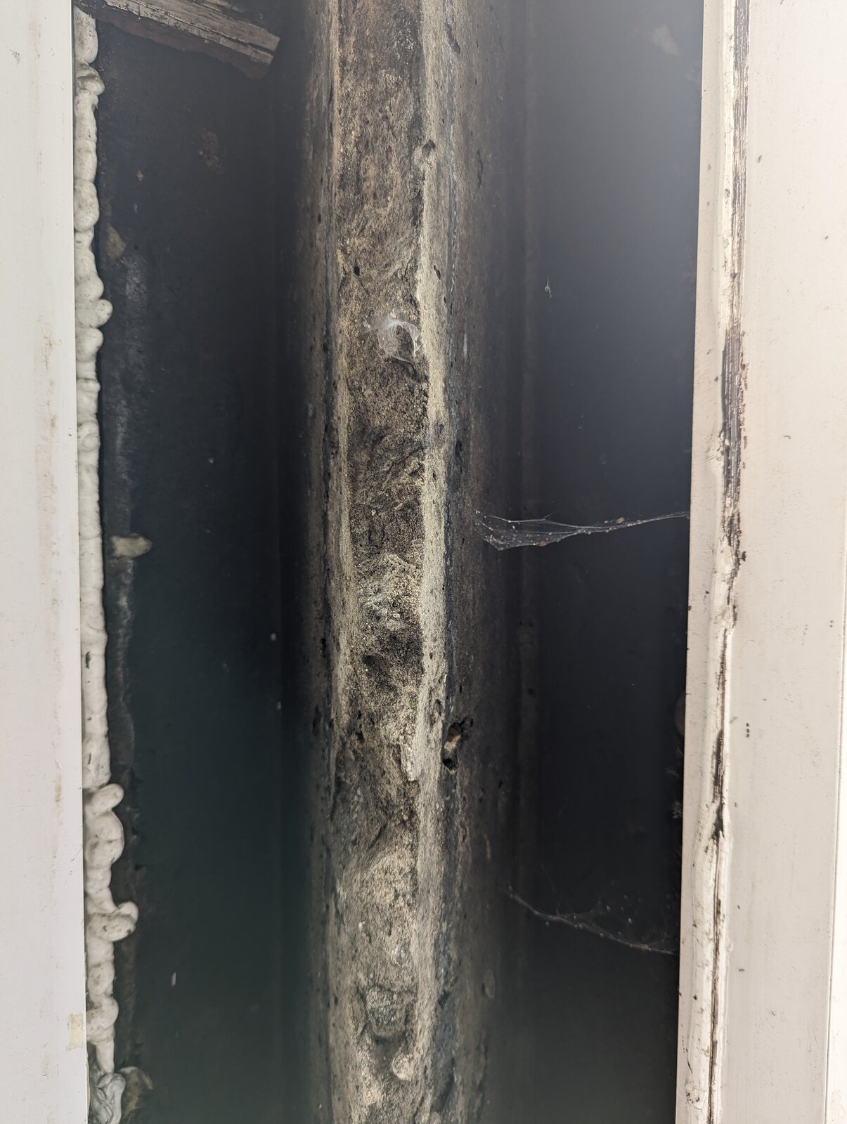

And this is the concrete behind the board:
I should have shown a wider view photo as well.
Its just the two visible spaces that need to be filled as the other edges of the 2 side widows the plasterboard buts up against them.
Hope this make things a bit clearer
Sorry for the lack of better pictures.
