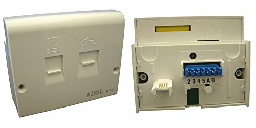

Hi,
I've wired in a new telephone socket as an extension from the master. The phone works fine here but not the broadband. Didn't think this was possible!
Broadband works on the master socket.
Any tips?

The master socket has a separate socket for broadband and telephone but I've removed the front plate and tested the micro filter at the socket underneath, it works there. This points to an issue with the wiring of my extension socket.
I've followed the suggested steps and as I said, the phone works fine
Wiring as follows: Blue to 2, orange to 3, white and blue to 5
Once you separate telephone and broad band as you have with master socket then you will need to extend them as separate functions. I would guess you have fibre optic broad band?
The distance of cable between these points is around 13 metres. I don't have fibre optic. I just need broadband at new location. Does this just require blue cables? If yes, do I leave the blue and blue/white where they are and disconnect the orange?

So no telephone needed at the new extension location? In that case just use the blue/white pair to connect from A & B on the master filter to 5 & 2 respectively on the new jack, assuming it's a BT-style jack. The orange pair will not be needed.
Yes, just need broadband at new location. Given the points I am currently at, I will just have to disconnect orange.

Have you connected to the correct terminals? The A and B terminals are in the front of the middle part of the master socket in the new sockets. The terminals 2,3,5 on the back of the front part of the socket are filtered.
You will need a filter at the extension end if you want to use a phone as well.
Not if you have the blue/white pair connected to the filtered terminals at the master. You need to move them to the unfiltered side, which are the terminals marked A & B, assuming that you have the fitted filter at the NTE (master) location. A picture would confirm for us.
Can I not have phone and broadband at new location?
Yes. With a filter at the NTE, you really want to run a separate pair for the DSL and provide two jacks at the new location, one for your modem, one for the phone.

If you have one of these on your main socket, they come in two varieties, one with unfiltered and filtered terminals, and one with just filtered. Notice the unfiltered AB terminals.
If you have the more recent filter plate, which sits between the back plate and the removeable lower section, there is a pair of unfiltered terminals on the filter, on the left hand side.
In both cases, you should really terminate the extension with an RJ11 socket. Readily available.
