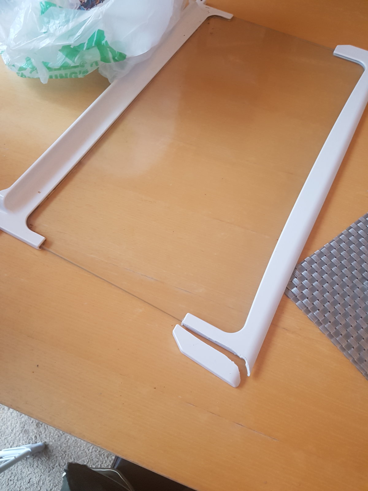

Hi
My shelf in my Beko fridge/feeezer has broken.
I think I can get away with replacing the plastic trim.
Can you advise how I would get the old trim off. Also, where would I buy a replacement trim.

Thanks. Have tried glueing it 3 times now, to no avail.
Still cannot budge the old one. Lost most of my fingernails trying to do so.
How did you glue it? it certainly does not look like its been adequately glued.
I'd wash it, dry it (hairdryer) turn it over, scrape all around the joint (rough sandpaper), apply epoxy glue in and around the joint - smother it.
A little superglue along the joint will break if that's what you did?
