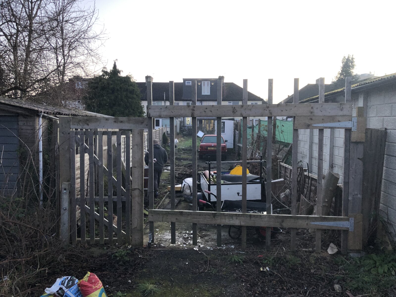

Advice needed, i recently took down my Aspestos 2.5 x 4.5m garage and looking to build a 4.2 x 10m garage Boundry to boundary with a max allowable height of 4m dual pitched roof.
It’s rather going to be old fashioned brick/breeze block or steel prefab building for ease of erecting.
It’s for storing my classic bmw e30’s which I have two of and some space for diy tools, workbench and miscellaneous stuff etc.
I also go brands hatch racing so would like somewhere to do my maintenance.
I am going to submit plans to get approval, need advice on getting drawings and engineering calcs made up etc. just wondering if anyone has done something similar?
Any advice would be much appreciated

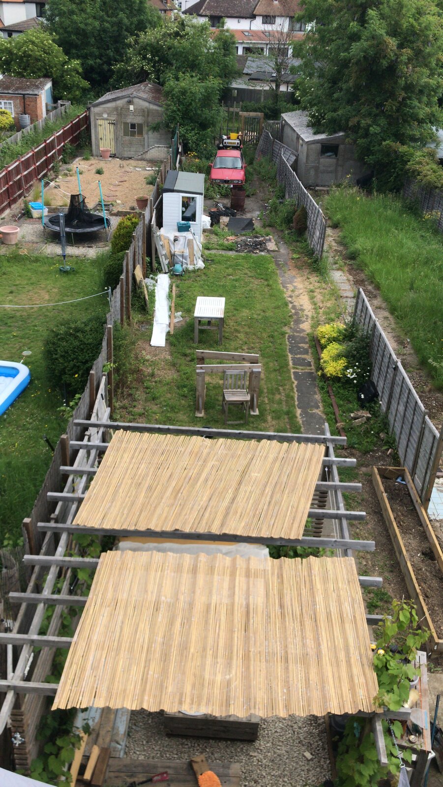

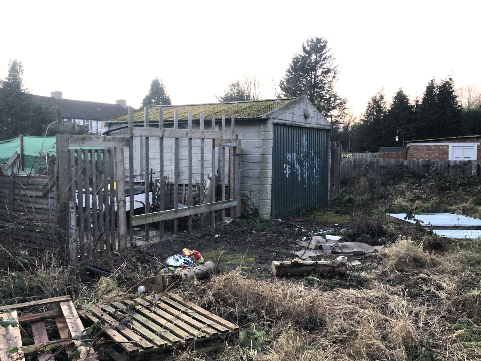

You won't need structural calcs for a planning application. You won't need engineering drawings either. Height and size- depends how big your garden is, what other buildings are in similar locations on your street, etc etc. Looking at the pics, the height might be an issue, the footprint not so much
thanks for the reply. Why do you think height could be an issue. This is what I was worried about.
The garage next to me is 3.5m high pitched roof.
But other side around 2.3m flat roof.
With pp, the height will attract less attention and any objections will carry less weight if there are similar structures in similar locations up and down the gardens. If the back gardens of all the houses were flat green grass with low fences and no trees, the planners would be reluctant to grant permission for a gert big barn.
As it is, I can't see any substantive reason why it wouldn't be permitted, though I think you'll be better doing it in blockwork rather than a steel prefab (steel building could look very out of place) plus the practicalities of building it (can you get a crane in the back garden cos you'd need one for a tin barn).

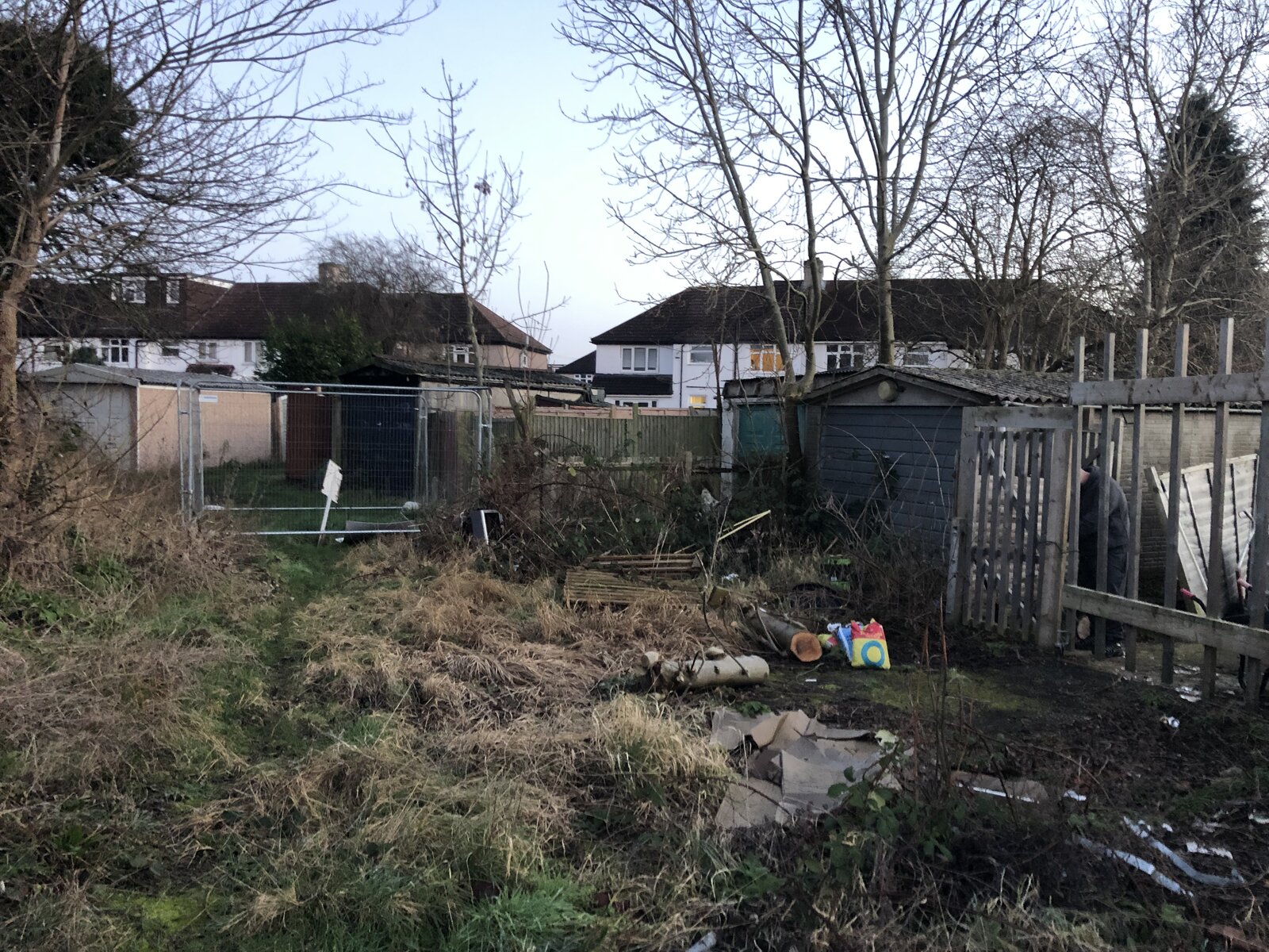

Also would they need a sketch of what’s either side of me to get an idea of what’s affected?
Think they want 1 to 100 which is easy in metric. And 2nd Q that's what the site plan is there for, they can use Google maps or someone will come out and have a recce.
