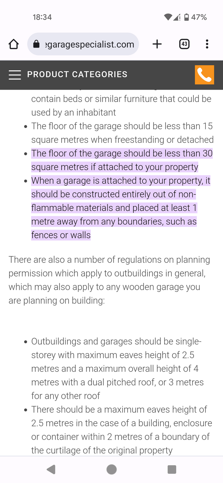

Thanks for the reply. I thought as it was attached to the building it required permission. (I also read it has to be 1 meter from any fence lines for fire safety, but that may also be incorrect)

BTW, the 15 and 30sqm rules, plus the 1m to boundary rules apply to outbuildings under permitted development, not attached extensions.
