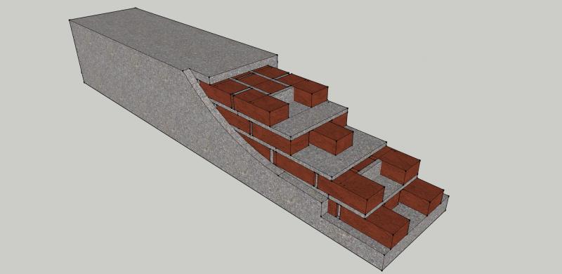

Question is, rather than digging a trench and filling it with concrete casting a new found replacing "like for like".
Is it possible to use bricks set in concrete to build up the founds rather than making it pure concrete like a newbuild?
It would save on material, mixing and allow me to put the old bricks to good use.
It *should* add strength to the founds by staggering them
Does this sound like a good idea or a bad idea?
Reasons against would be useful.
I know old buildings have had founds built out of brick and mortar on a bed of mortar
Just wondered what the take is on using brick with a few cm of concrete between, then another course of brick staggered.

This is what I meant:
Layers of brick buried in concrete.

It will crack and settle:
How will it be more prone to cracking than a pure brick or pure concrete mass? Their compressive strengths are similar, and its all tied together using the same concrete. No hairline faults of two different pours of concrete.
How will this settle more than a traditional foundation or slab and footing? The mass is the same, the ground conditions are the same.

I'm on a mobile ATM, so difficult for a long reply, but in the meantime, google for how loads are distributed in bonded masonry and how the gravel functions in concrete.
Then compare how loads will distribute in masonry with big joints and unbonded, and in concrete with large unit ballast and how flexing causes cracks to run around these large units

Woody, I realise how concrete "works", I also know how compressive forces and loads are distributed through materials.
For it to fail, it would need a point load to cause it to fail, the weakest component would loose its adhesive strength and it would part company creating a crack.
Rather than lots of microscopic cracks in the concrete between the aggregate and cement that holds it one massive crack would be created in the brick. (they hate tensile stress).
Point is, its layered and its staggered AND the joints should have plenty of space to allow for flexing (if any occurred)
I quite frankly don't see how a foundation on load bearing ground of these dimensions would suddenly decide that one corner wants to move up or down all of a sudden, or get a huge point load right in the middle of it which is strong enough to deflect the lump to the point it would crack.
The Mortar in masonry usually has a compressive strength a lot lower than the brick it is holding together. Meaning that the mortar "gives" so the bricks do not crack and the wall can flex lightly if required.
This lump, would be very much solid with "zero" give, but that's what a foundation is meant to be, no?
