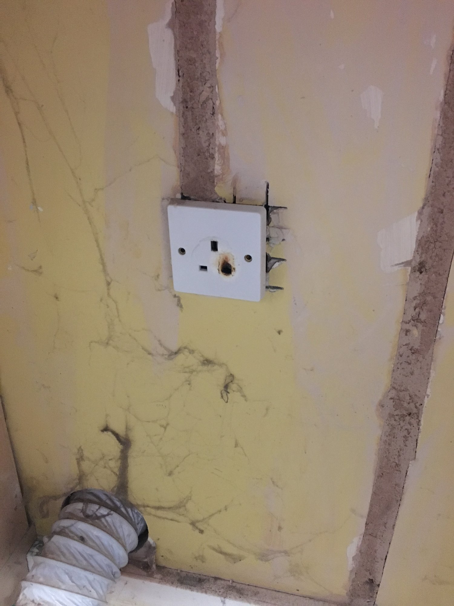

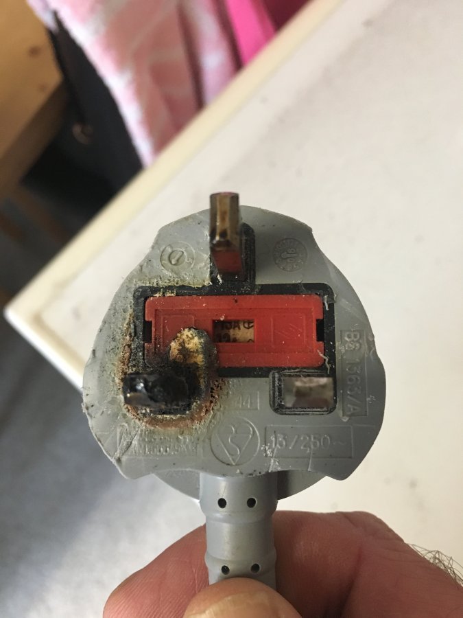

My partner and I noticed a burning smell coming from our tumble dryer earlier, we turned it off and pulled it out to find the plug was melted to the wall socket!!
It's a fairly old tumble dryer which gets a lot of use I'm just wondering if anyone knows whether it could be the tumble dryer or the socket itself that caused the issue?
Resistance has caused heat, which caused things to melt. The resistance may be caused by a bad connection - in your case most likely either in the appliance's plug or poss the wall socket.
As it looks like the plug and socket need replacing, I would re-new these and check the cable on the appliance, as well as the wiring behind the socket. If you have no DIY skills to be able to do this safely yourself, best to get a spark in.

As you can see from the pic the plug socket is not even attached to the wall properly do you think this could have contributed to the problem?
Replace the plug, and socket, with quality items such as MK and it's likely that all will be well. It's best that the socket is secure, but that hasn't been the issue here.....I'd guess the contacts inside the socket weren't connecting perfectly as woodbine indicates.

Yes, as above. Replace both socket and plug. Looks like there has been poor contact between the live pin of plug and the contacts that it connects to inside socket. I'm hazarding a guess on the evidence that the appliance isn't the problem and hopefully should work when the plug and socket are re-newed.
