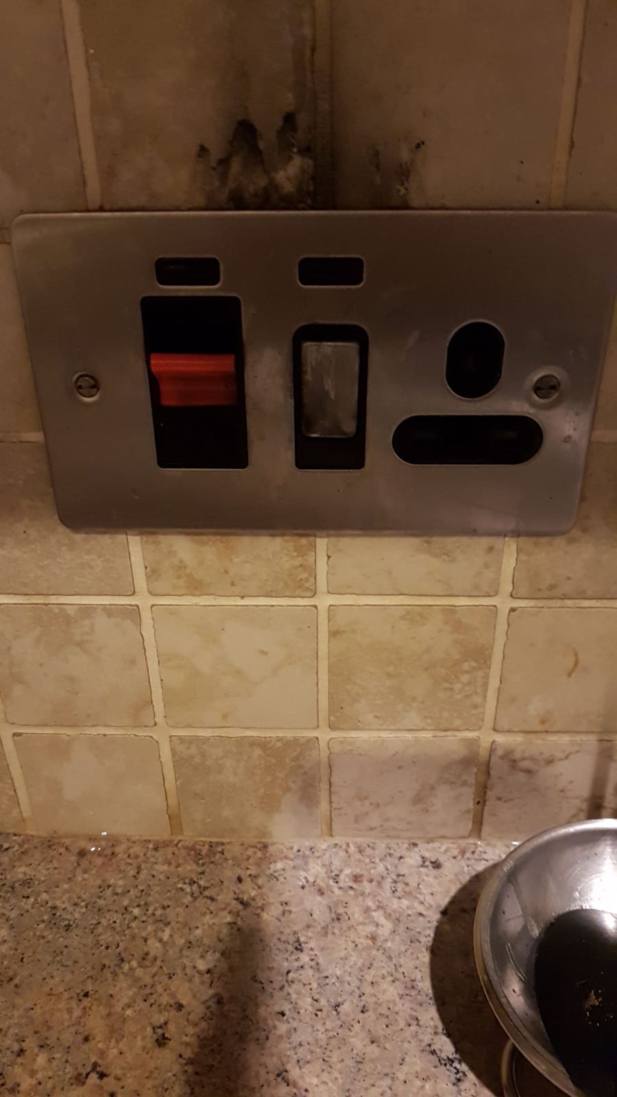

Hi, I have neff electric oven and last night there was loud bang and when i went into the kitchen the red cooker switch with socket plug was all burnt out round edges.
Any ideas what could have caused it?
Is it going to require a new switch?
Any help appreciated.

A loose terminal, leading to heating, leading to melted insulation leading to the eventual pop as it shorted out.
Nozzle
maybe an earth or neutral
equally possible to be Live
And Yes a new switch would be advisable.
The explosion could have coated the switch with conductive "debris".. Carbon from burnt insulation and/or vaporised copper from the arcing that caused the explosion
Those large, stranded cables need to have the terminal clamps re-tightened a week or so after fitting, because the soft copper deforms under pressure.
Hardly anybody does it.
It's surprising how un-tight they can be.
This happened to me once.
Just replaced it, had to cut back the cables a bit, never knew why it happened.

Given the loud bang and blast marks around it, I'd wager that's on a BS3036 rather than a breaker of any kind.
A loose wire inside it no doubt, maybe an earth or neutral
It could also be water running down those tiles, from cooking condensation which has shorted the terminals. Its a fair blast, it will certainly need the switch to be replaced, as an absolute minimum and perhaps some repair of the cables if they are damaged.
