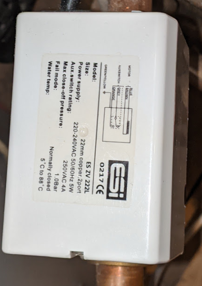

Thanks all. Here is the valve itself. It was installed when the central heating was installed, about 5 years ago. There are 4 of them (hot water, and the three zones on the heating system). One of them has already been replaced - the plumber who did that was pretty critical of the original installer for not using honeywell, and when we had some more work done recently another plumber said the same thing. Oldbuffer - many thanks for the instructions. I have a plumber coming around anyway next week - can this wait until then, or is that like asking for the length of a piece of string? Thanks again.

On to the job at hand. So the valve is an ES ZV 222L, which I think means I need one of these: https://www.heatingcontrolsonline.co.uk/esi-ESZVA222-zone-valve-actuator.html

I took off the cover. I needed gloves, it's very hot!
Here is the motor.
I'd never heard of a synchron motor until today. I am no expert but the specs I can see are 50hz; 5W and 4RPM. I have no idea how important it is to match exactly. I've had a quick look at where I might go in the morning to find a replacement. Screwfix has one, but it is 5RPM (and 4.5W). Toolstation has three: the Corgi one is 5RPM and 6w; the Drayton one is the one stocked at Screwfix; and the honeywell one is 6W (can't see RPM). City Plumbing has a few: a 6W 5RPM one; a Boss one that is 4RPM, but 6W; and a "Universal" one that I can find no technical details for.
Would any of these do, or do I need to find one that is 4RPM and 5W?
Thanks!
Also - I left it locked open so we have hot water, rather than rely on immersion (although it still makes a really loud buzzing sound). Good idea? Bad idea? doesn't matter? Thanks!
The screwfix one is a genuine Synchron motor. A lot of the cheaper ones have nylon gearing that fails prematurely in the hot environment. I don't think you need to worry about the difference between 5 and 6 RPM. The important dimension will be the depth of the drive spigot, some are longer than others. To change the motor, put the valve in the manual position, undo the flange screws and rotate the motor slightly whilst withdrawing it. Cut the wires close to the motor and use the connectors supplied with the new motor. The screwfix/drayton motor will have spades that you need to cut off.
Cheers. I got the screwfix one and installed it. I'm not really sure how to tell whether it is working properly. If my shower is cold in the morning then I guess it isn't! All I could think to do to test it was to turn off the hot water on the wall box and test the resistance on the little lever on the valve. When the hot water is off the lever is really stiff; when I turn the hot water on it becomes really slack. Which I think means it is working fine. It is still very hot, but blissfully quiet. Thanks for your help everyone!
