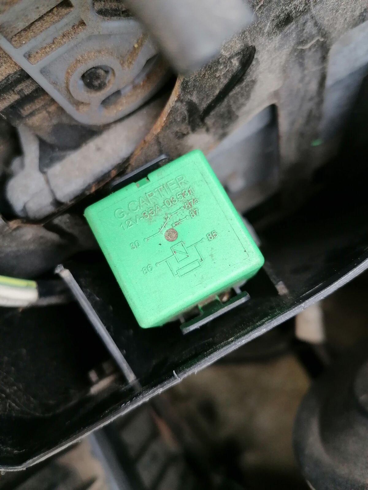

Is this my fuel pump relay? (pic attached) it is the only one I haven't tried as it has metal pin type thing on the side and I don't want to pull it out and brake it.
Could be some show it as a normally 5 relay its can take 35amp so a biggie need to unplug it to confirm hum stops but that must be fused some where under bonnet fuse box or in car fuse box
The green one pictured is under the bonnet next to the battery, but like I say it has a metal pin type thing attached to the side of it so reluctant to pull it out incase I snap it off
you will need to unplug it to confirm looking on google there are a few different type of looking relays hard to conform some relays are in the under bonnet fuse box, so you will need to unplug to confirm
Well it is not the green one, have unplugged it and the humming still continues.
Any ideas anyone?
The green block is the only large fuse I can find, and it doesn't control the fuel pump so does anyone have any idea where I would find the fuse that does? Starting to loose my mind having to disconnect the battery every time I get out of the car and reconnect it to go out.
