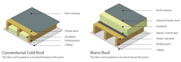

Very shortly. The insulation is there to keep the room warm. If you dig holes in the insulation then you will lose heat.
And heat costs ££££
Also any moisture will be drawn up from the room into the cold area above the insulation. There it will condense causing damp.
If you had wanted downlights the roof should have been a warm roof construction where the void is below the insulation, not on top.
