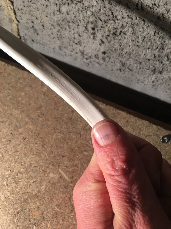

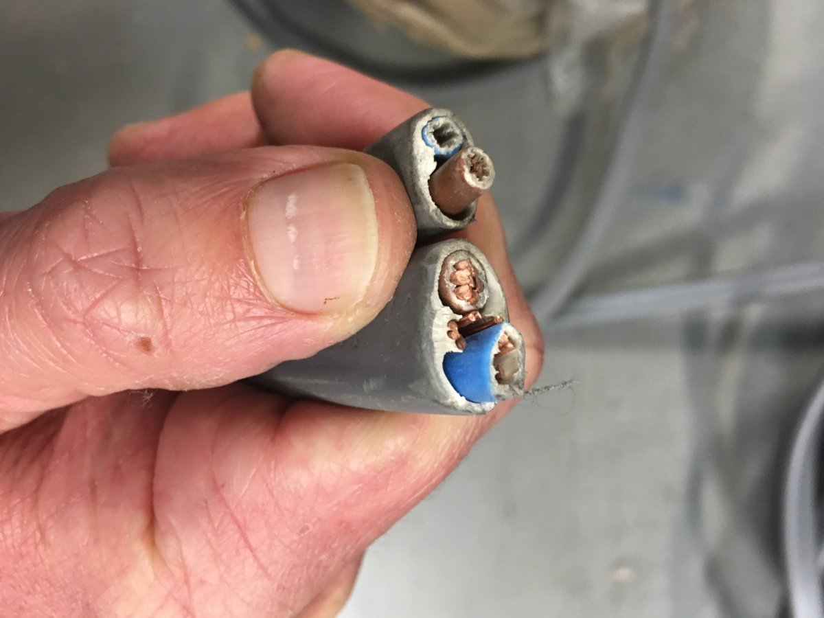

Hello. I'm wanting to upgrade my 8.5kw shower to 10.5 or 10.8kw.
I think I have 6mm cable but not 100%. The picture of the white cable is what I have now, the picture with grey is what I checked out at the store.
Can anyone advise? My white cable is around 13mm in width. I don't have any photos of each end as not opened up either end. This is what is showing in the loft.
I was just initially wondering if I had big enough cable (I'm betting I don't).
Thanks.

Almost certainly 6mm for the existing cable.
You should be able to find some codes printed or embossed on the cable. In the photo we can see what I think is the manufacturer name; what else can you find?
Almost certainly 6mm². [wiki]electrics:cable_types:flatpvccables[/wiki]
Might be OK for a 10+kW shower, might not.
Also pretty sure it's at most 6mm², 10mm² is a monster.
Easiest way is to just check the cpc, see if it's one strand or multi
