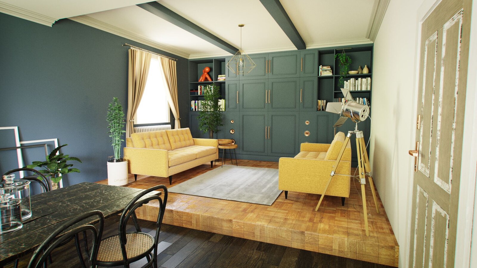

Awesome, thank you both. great information :). Here is the visualisation BTW. I'm a little scared :)

ok the boards turn up at your door with mdf edges and mdf moulding out the front surface how do you plan on finishing
the normal is rout out moulding before covering
the normal is rout out moulding before coveringY
Yeah this is what I was thinking. I thought I would just mount all the boards and then paint them, either by spray or brush?
Do you think fittingly.co.uk will be close to the cost of getting a design like this just cut from wood and then assembeling it? Looking at fittingly, i think my costs would be about £3k for that visual. I wouldnt imagine the cut wood would cost anywhere near this much? But im just guessing.

you are providing i assume cad work you assume the rest is cheap ???
i suggest materials will be perhaps 2-10% off the overall costs you need machines for holes for hinges and handles and assembly fixings 'for rebates and channels all need programming and tooling for a one off with the specific material that may not be to hand sourced you then machine they need finishing and lots off manhandling
if the setup costs are 250k its expensive for a one off if its for 5 million plus units its a few pounds
now not saying you requirements are high thousands but suspect unless the same manufacturer has cnc ability to cover all tasks in house including finishing you wont ever get a price less than 5 times what you hope for as a one off as " thinking input " is 10 times more costly than "press a button" already set up for costs
CNC time is currently £50 to £100 per hour depending on location. There will be a charge of the same (or more) for correction of CAD drawings, nesting of components and generation of the CAM toolpayth from your CAD file for their machine. There may also be a tool setting charge if your design requires specialist tooling (e.g. grooving or chamfer cutters). You will probably only get flat bed 2D or 2-1/2D component cutting - no side or end drilling and probably no vertical drilling either. I was involved in CNC some years back and at times I really hated having to correct the CAD errors, bad files, etc that went with non-technical people coming with their designs when the didn't understand how CNC routers actually work (and why did everyone think my time for making their poor CAD actually work have no value?)
