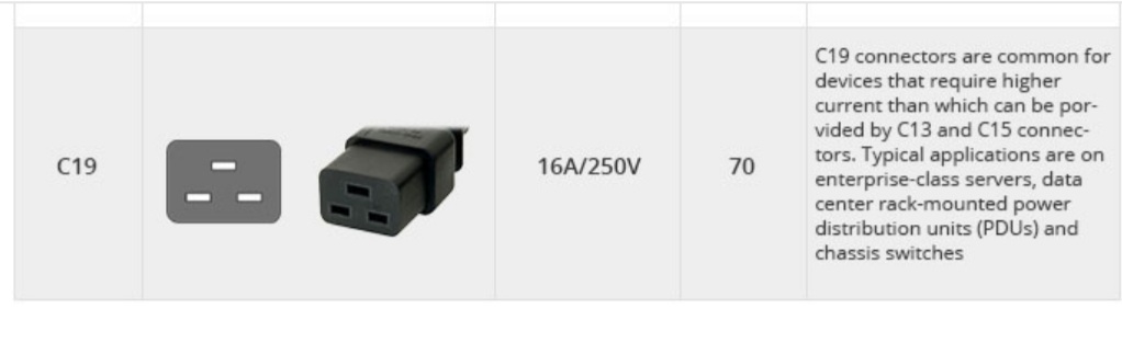

Am I able to plug a 16A C19 cable into a UK standard plug socket?

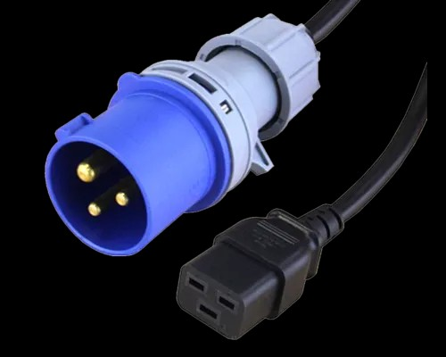

Has the cable got a plug on it?
A 16A plug will not fit a 13A socket
But you can cut it off and fit a 13A plug.

So the 16a plug on the c19 is a different size to a normal domestic 3 pin one?

If you are going to cut the end off of a C19 lead, to fit a UK plug; check the cable size first - some of the C19 leads I have seen, have cables that are a bit too thick for an easy fit into the cheaper UK plugs.

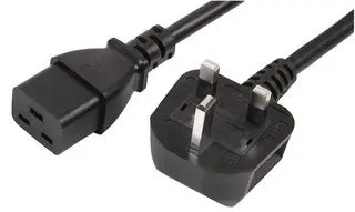

If it had a 16A plug, it could look like this:
If it has a standard 3 pin plug on the end already, like this:
Then it will plug straight into a standard socket.

Yes!
No, only UK standard plugs will fit.
There, that's that cleared up
Not really, the OP can have a 16A lead with a 16A C19 connector, and if it is fitted with a 13A plug, then it will fit, but then we're just arguing semantics :)
...and we still don't know what the OP has, or hasn't got!
