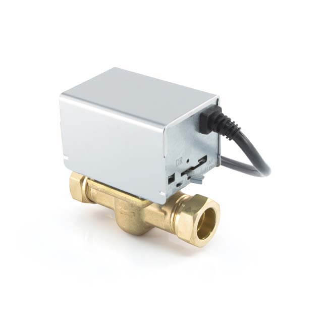

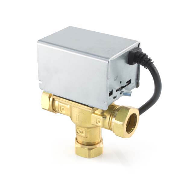

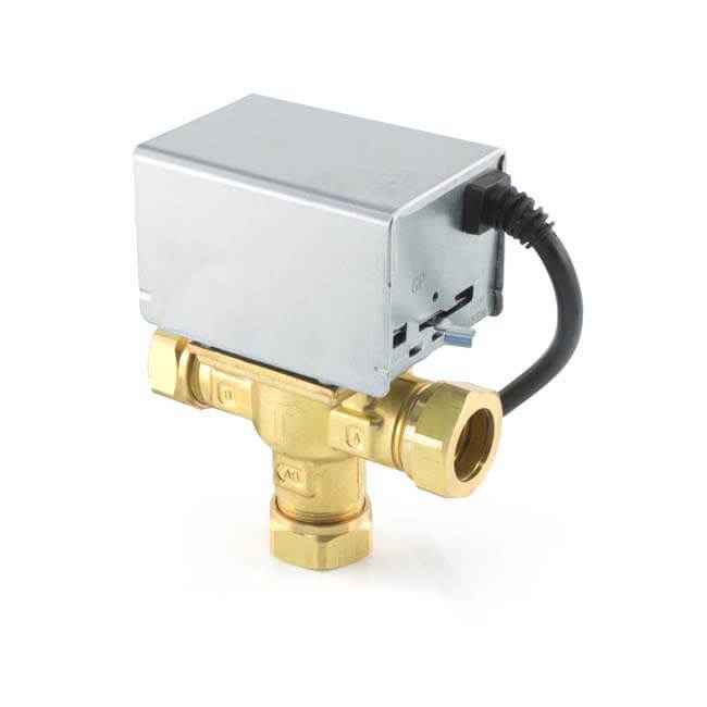

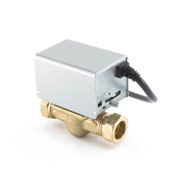

Need a few more details on your system I think, but from what you've said, I'd hazard a guess firstly you've got a faulty motorised valve somewhere. This will have the effect of allowing the boiler to heat the radiators when HW only is selected. You're looking for either one of these
or two of these
Secondly, the radiators heating up upstairs faster, is possibly a balancing issue. Basically the water will take the easiest path through the system, so by balancing the rads, you force the water to the furthest parts of the system to ensure all rads get there fair share. (See FAQ's on how to balance the system.)

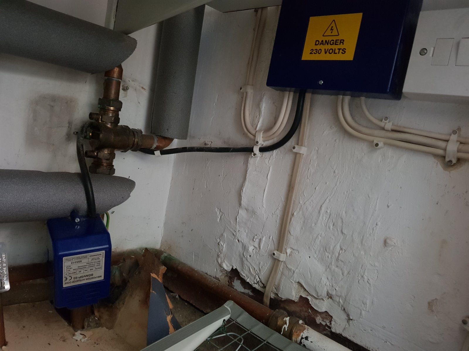

In the boiler cupboard, I have a magna clean, a pump and a device called mid position actuator code.
I dont think I have a 2 port motorised valve or maybe its hidden under the floorboards somewhere.

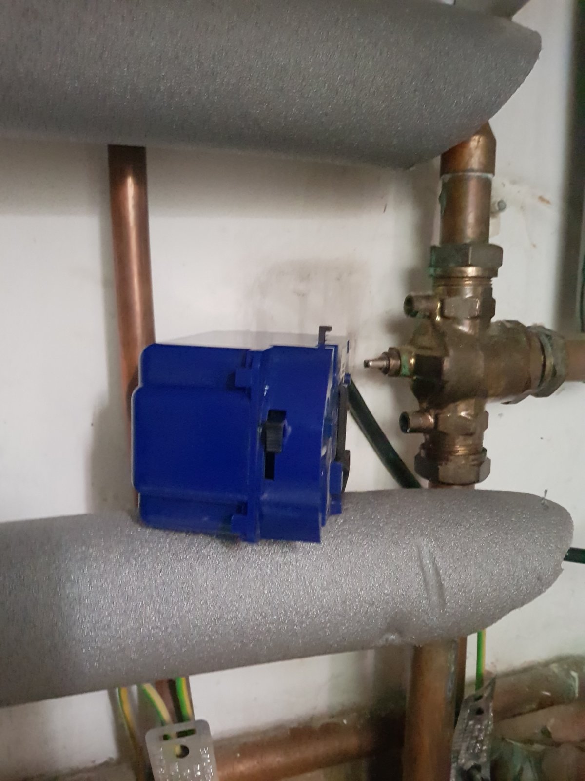

Mid position actuator would be a 3 way valve. Some manufacturers versions are renowned for sticking. Can you put some picture up of what you have got?

I would strongly suspect it is the blue valve at fault here. Is that actuator actually sitting on the brass 'T' shape body with 3 pipes attached to it? Cant tell form the photo.
Your system is what we refer to as 'fully pumped' that is the hot water being produce in the boiler to heat the house is pumped around the system to where it's need. So, from the boiler, the water will flow to that valve, where the flow can split two ways, either to the hot water cylinder, the radiators or both. The valve is electrically operated on commands from the programmer and then two thermostats, one in a room somewhere which will control the radiators, and the other on the hot water cylinder, which will control the hot water.
Problem is highly likely to be this valve has failed, so instead of closing off the flow to the radiators, it has stuck open to the central heating circuit as well as the how water tank. Boiler and pump are still operating on command from the Hot Water system, to heat the cylinder, but some of the flow is also going to the radiators, even though they're switched off electrically.

The actuator is not connected to any valves. It connects to an electrical box which is what controls things.
I found that it has a plastic lever, when I tried to turn it with a little bit of force, I heard the boiler come on, then the thing made a squeaky noise and turned back to it's original position.

Don’t be worried. I call the brass the valve and the head the actuator. like I said before when it’s all cold turn the hot water only on. Then only 2 pipes at the valve should get hot. The one on the right coming down to the valve is from the boiler and the other 2 are one for heating one for hot water.
99.9% it’s the the motorised valve

Yes it’s the valve body. It’s a diverter so diverts water right or left ect or both. Go on YouTube and just search how a y plan works. It will give you lots of info so you’ll understand what your doing more.
Drayton MA1 actuator, notoriously unreliable. Shop around and you will find you can get a complete valve for less than an actuator only. Just use the actuator and start saving up for a new one in 2-3 years time.
