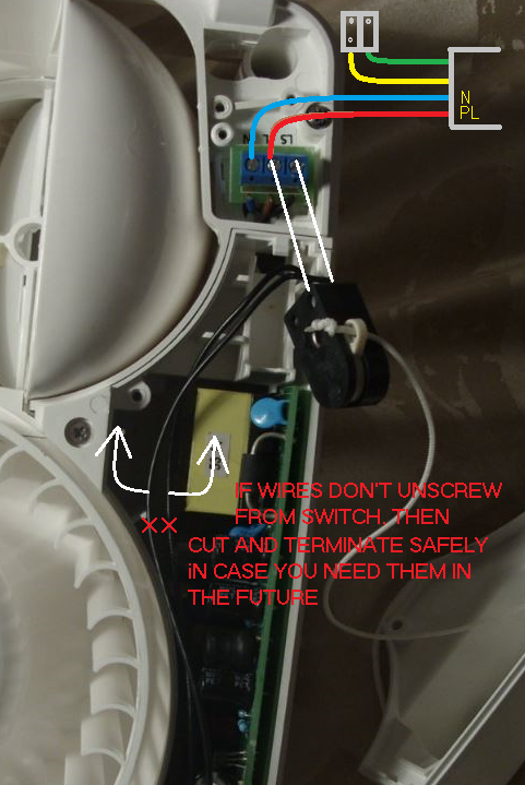

If you want it to work by the pull switch but to run on with the timer then you will have to wire the switch between the permanent live connected to its terminal and the switched live terminal.
Leave the switched live from the light switch disconnected.
Hi. Thanks very much for that. I'll do it the way you said, or try to. Not sure what's involved, though. Unless you mean that at the terminal block in the fan I should connect a very short piece of wire between the L and the SL terminals. That is, one end of the wire would be in the same terminal as the permanent live wire, if there's enough room; and the other end should be in the switch live terminal, where it will be the only wire. Thanks again
No, you must rewire the pull-switch so that it forms the link.
Post a picture so we can see all the wires in the fan.

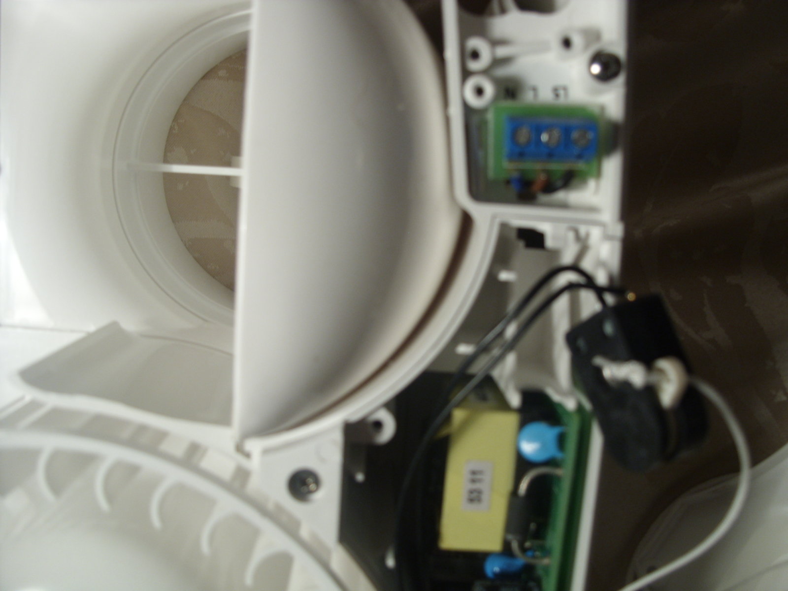

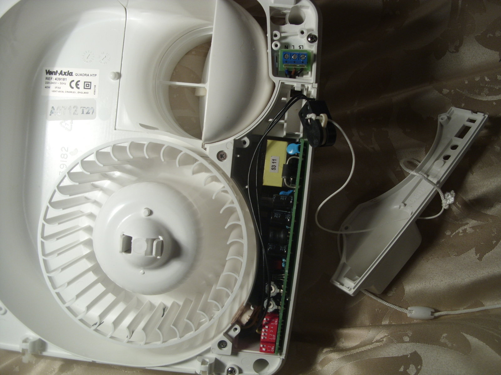

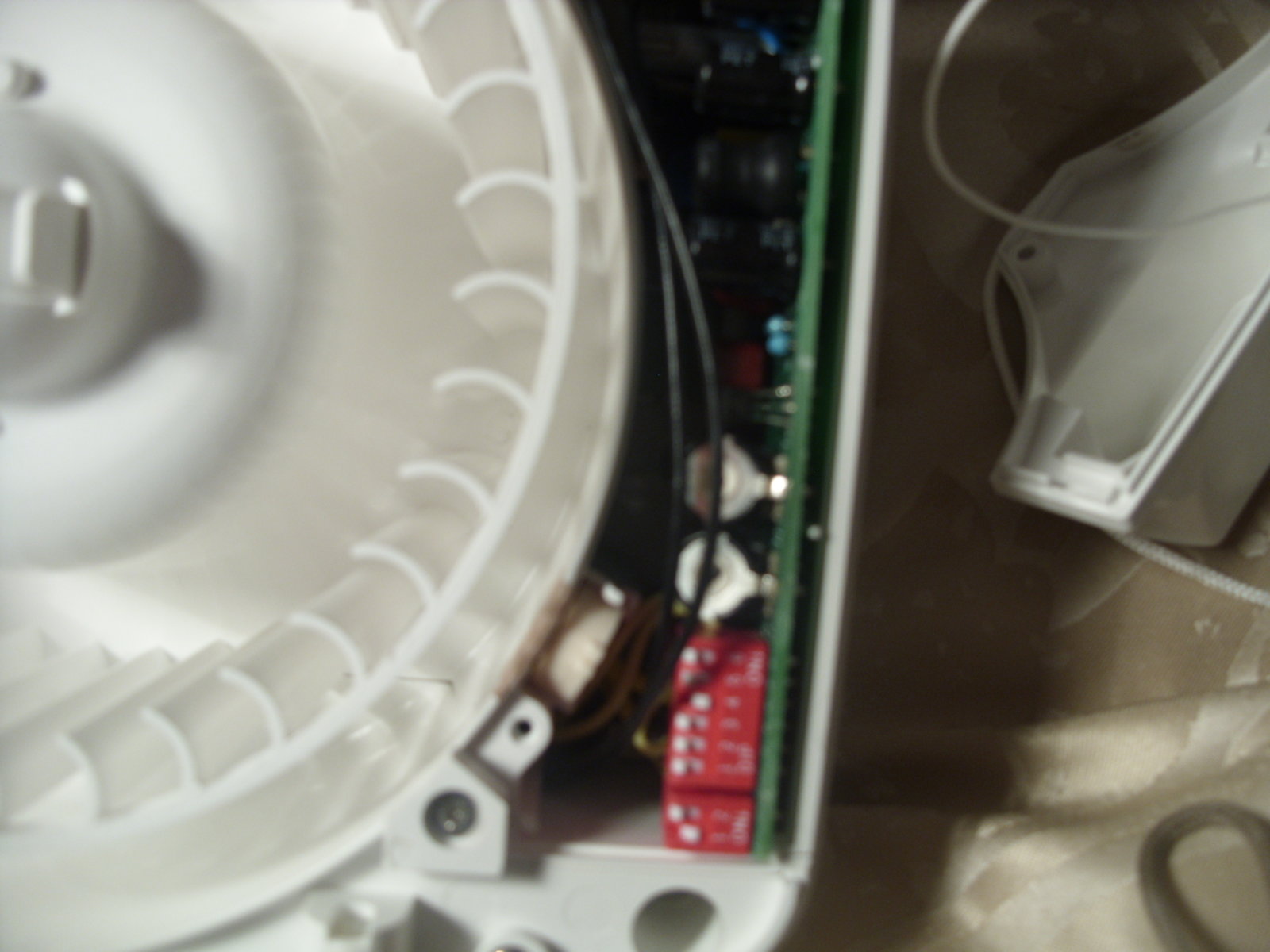

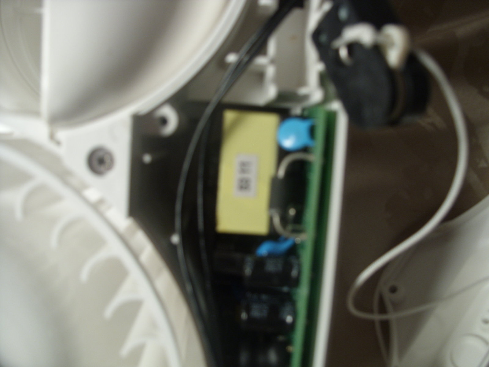

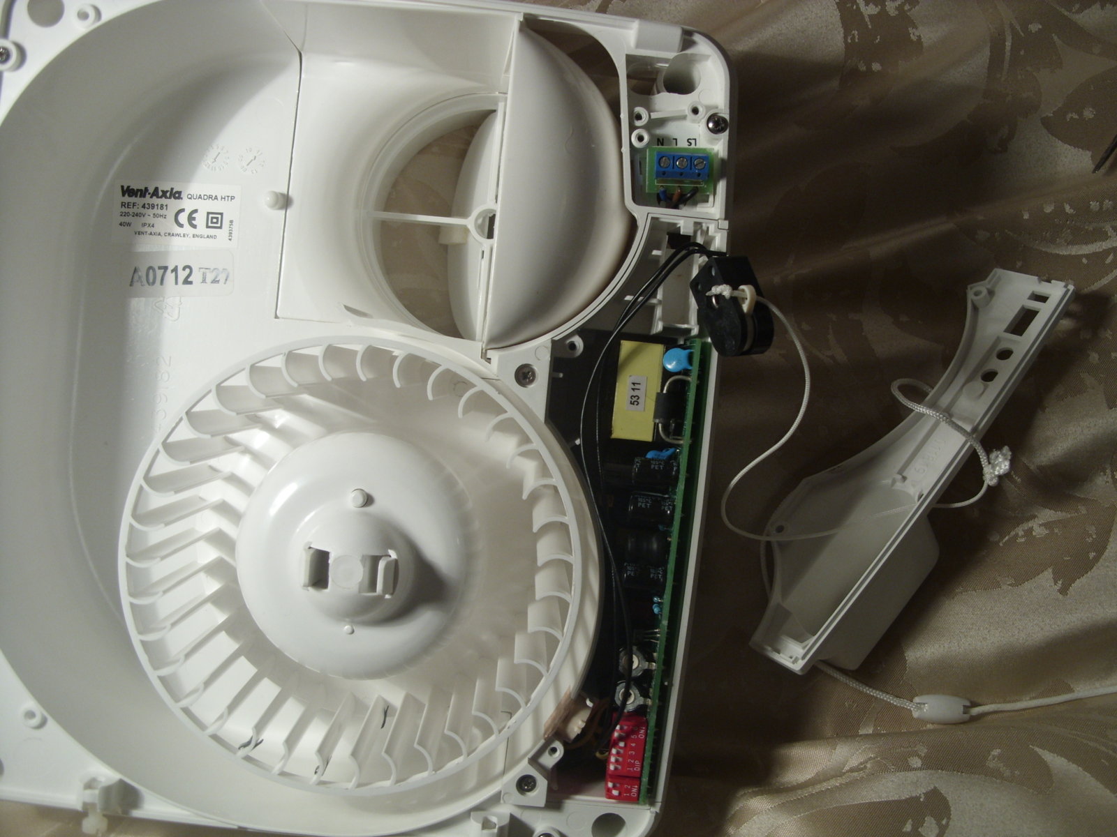

Hi. Thanks for going to all this trouble. Is it a photo of the terminal block circuit board that you want? Or should I disassemble the fan to expose the internal wring? Thanks again. Cheers, Laurence
Hi. Here are the photos. Hope it helps. Thanks again. Laurence

Hello again. Thanks very much for that.
This is what I understand from the diagram.
I remove the two black wires from the black pull switch ( they are screw fitted, by the way) and I tie them out of the way, because they won't be used.
I replace them with two short wires ( properly colour coded) from the terminal block.
The one on the right will be from the SL terminal, where it will be the only wire.
The one on the left will be from the L terminal, which will also house the permanent live of the feed cable.
The N terminal of the terminal block will house the neutral wire from the feed cable.
The switch live wire of that cable, and its earth wire, will be tied safely out of the way.
That is brilliant! I even understand it up to a point.
I'm very grateful to you.
Merry Christmas and all the best.
PS. I can't even begin to understand how you managed to turn that photo into a diagram in the way that you have.
Yes that's right.
Make sure that all the unused wires can't touch anything else.
Thank you - same to you and yours.
:) It's magic - and Windows Paint.
